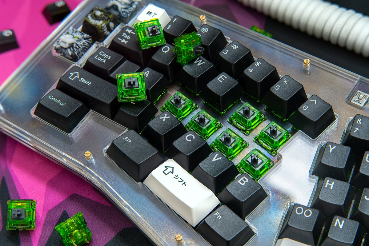

Got a notification on discord about these
Yeah, I remember these being advertised during the spring as something that would arrive after the Tangerines.
I just did a search to try and find out more about these. Apparently they are 67G T1s in a Tangerine housing, essentially. Iām not sure, though.
One person commented that they had already put T1 stems in Tangerine housings, and it wasnāt much of an improvement over lubed T1s. Although, if he meant unlubed Tangerine T1s and itās actually an improvement over lubed T1s, that would be meaningful.
Maybe I should finally try those T1s I bought with my Alpacas to see if Iām going to like these. Many T1s have leaf ping issues, I understand?
Iām simultaneously trying to learn about the FFFF switches, which are now available in Canada. Itās hilarious, there is virtually no information posted on what these switches are like, but a 20K GB sold out in no time.
Agreed. I also tried T1 stems in Tangerines and nothing really jumped out at me - however I also tried T1 stems and leaves in Ink housings and that was very nice - just like a regular T1, but really smooth.
That color tho.
The one good thing to note is that they have limited purchase quantity to one. Hoping they wonāt sell out as fast as they Tangerines. I would love to get my hands on them but will not pay some of ridiculous markups.
