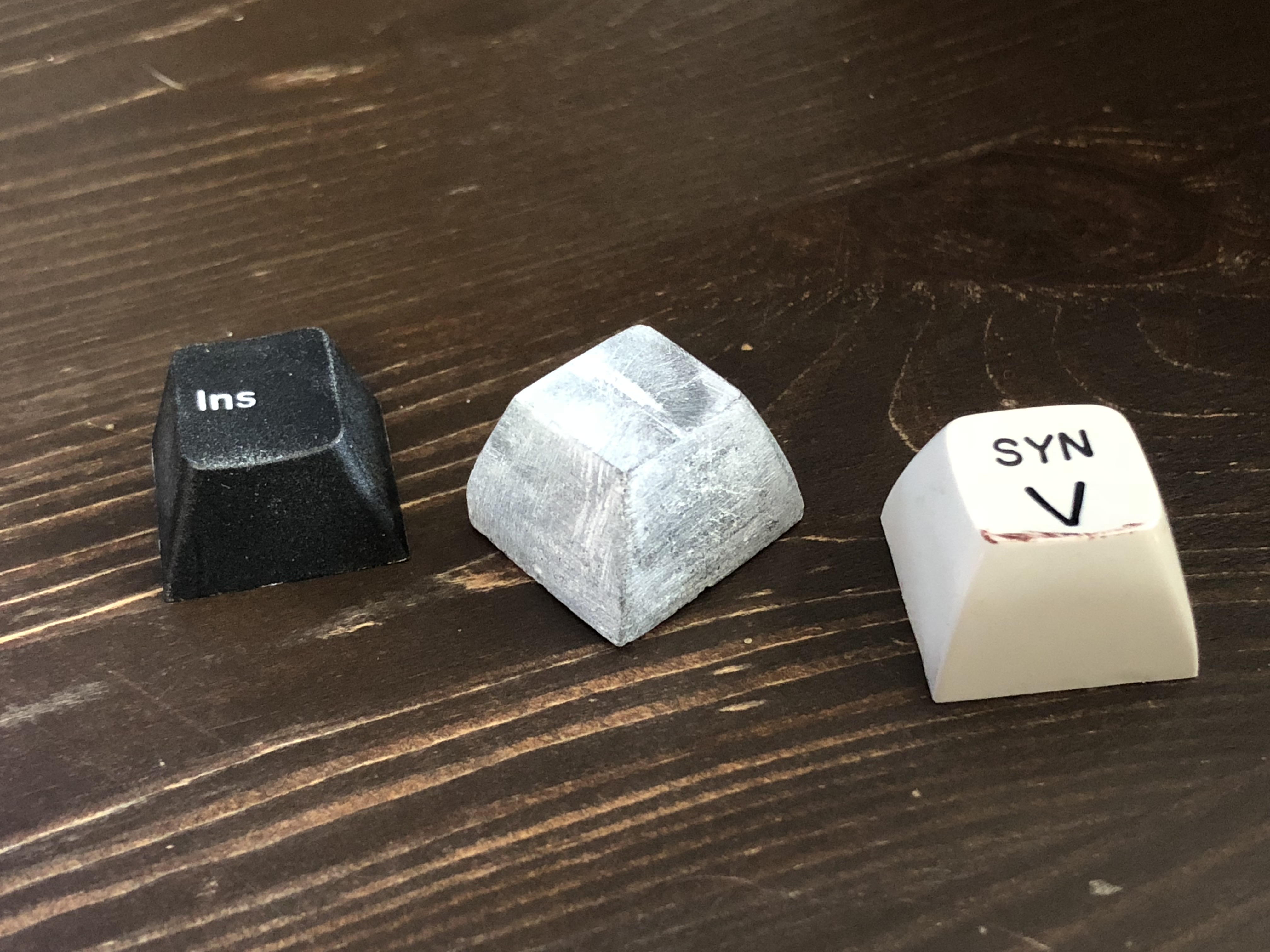

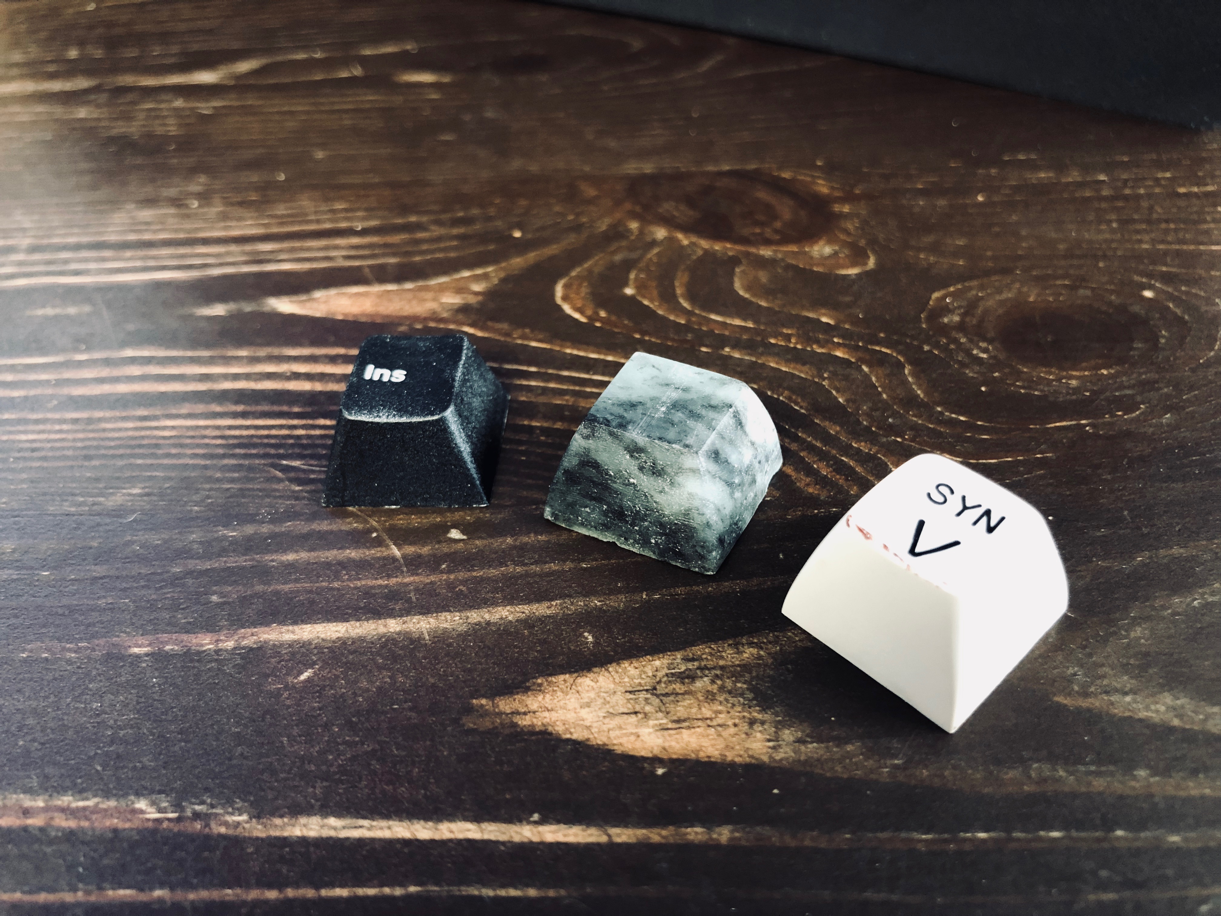

First prototype … the real challenge is going to be the interior.
How heavy is it? Like Rama’s alu caps heavy?
I don’t know much about Rama alu (beginner here) but this one is 8 grams. It’s not hollow out yet but it’s probably close to the end result. Are heavier cap prefered or not usually ?

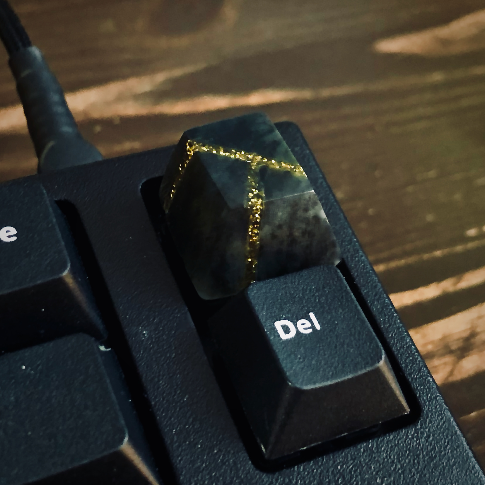

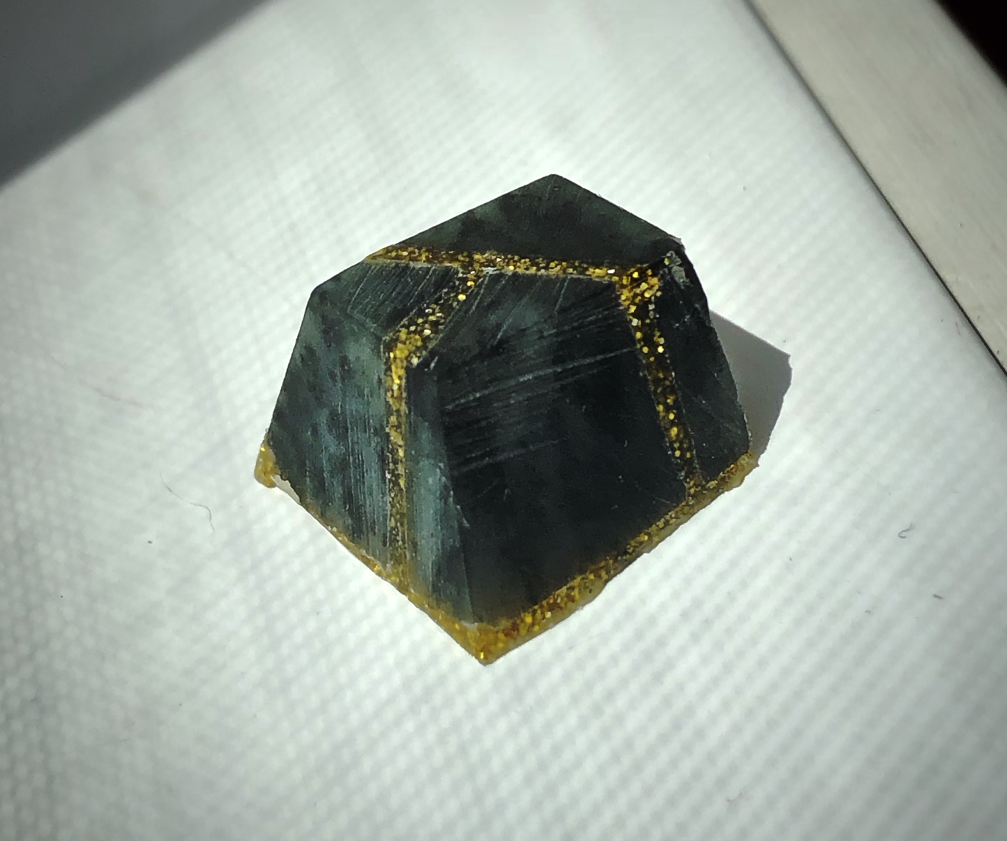

Tested gold inlays using epoxy and cheap glitter. Already ordered gold leaves to see if it can be used in resin. Sanding the stone and the resin with paper creates uneven results. I think I’ll need to used a electric sander with better grit and go slower.
Prototype 001 Update:
  • Resin bonded well to the stone, but process was too complex
  • Repolished with new 2500 grit. Finish close to end goal.
  • Edges are a little sharper. Which makes them a little fragile.
  • Glued on zinc stem. I think I figured out how to glue it on straight (harvested from metal keycap)
I would have liked to show more photos, but the right side little ugly hole (had not fully figured out the rotary tool yet) and a small portion of the inlay was not deep enough and detached.
Otherwise I’m done with this first iteration and will be stress testing it on my ESC for a few weeks to see the wear and tear.

Kintsugi keycaps! Looks great already but you might be able to get a better result with a metallic look resin, or with a mica powder additive.
Well… I would not dare call it kintsugi since these caps are never broken and it’s not done using lacquer. But I’m indeed planning on going in that direction in later iterations.
