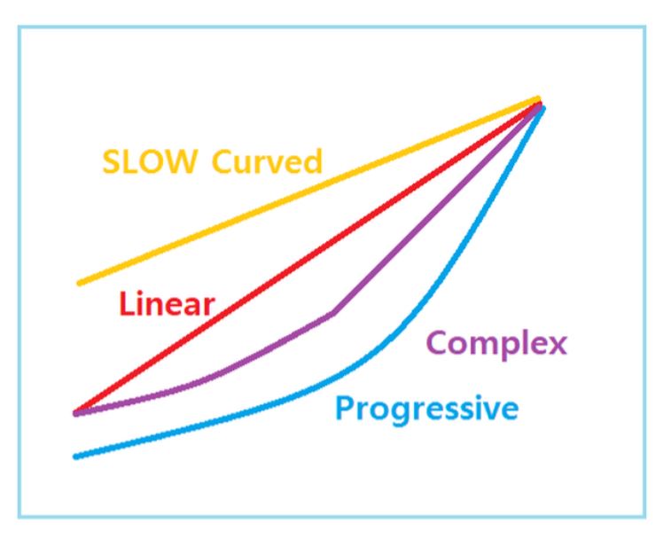

The way you’ve worded it I think it could be the creams being on the heavier side all the way through & yellows being heavier at top cause of the longer spring that is bothering you. That’s why I said to try progressive springs. So to further explain spring types, a linear progression spring is just that the force curve will be a straight linear line. With progressive springs they are coiled tighter at the bottom so the force curve will actual curve up from the beginning of the keypress, they start lighter than that weighting should & then increase in weighting more quickly than linear progression or slow curved springs at the bottom to meet their stated bottom out weight. Slow curve springs will have a straight force curve like linear progression springs, but the line will be flatter on the graph as slow curved springs are longer to pre compress the spring some causing them to start off heavier & have less weighting difference between the top & bottom out.
This pic should help better explain what I’m talking about,
