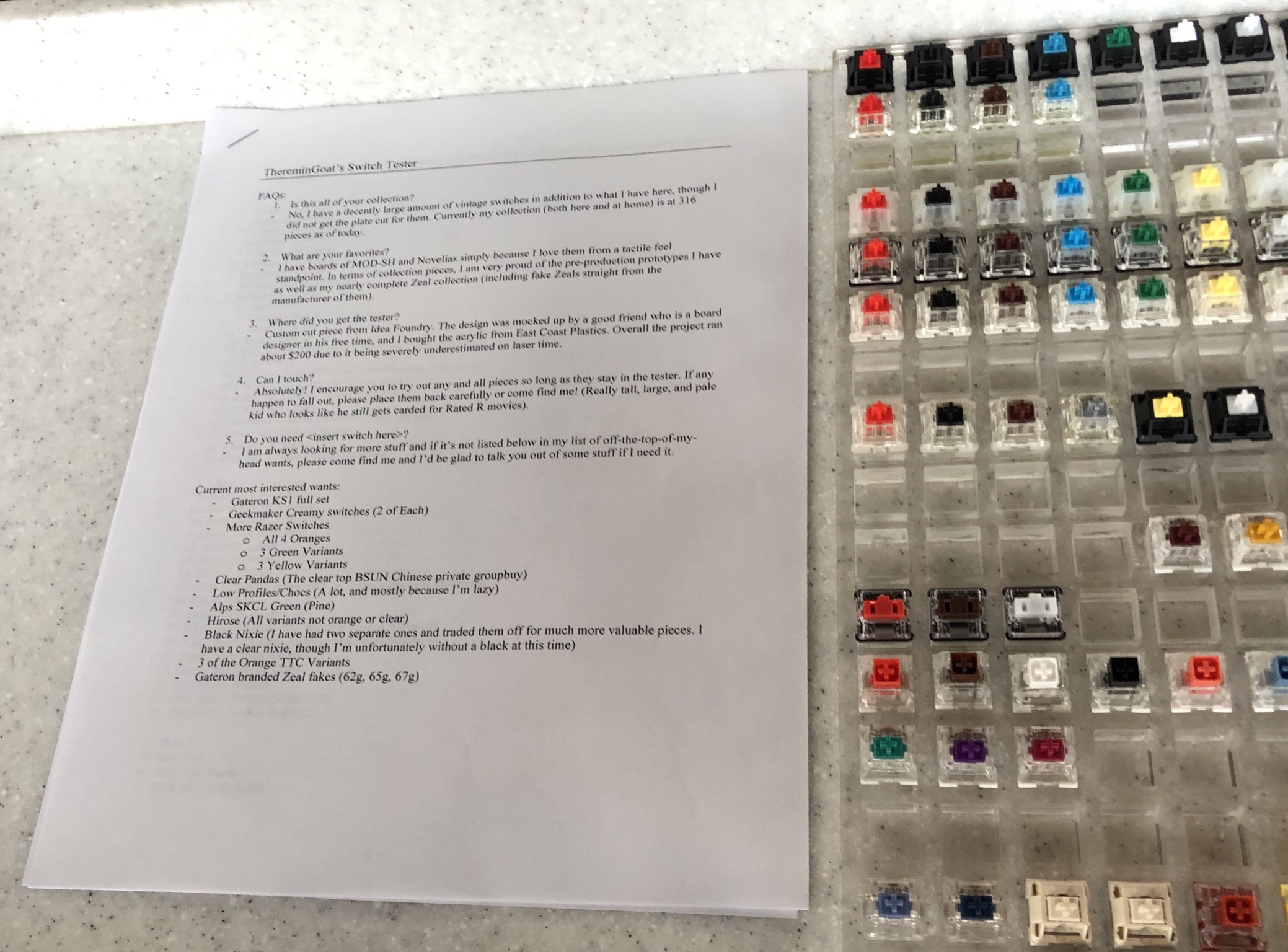

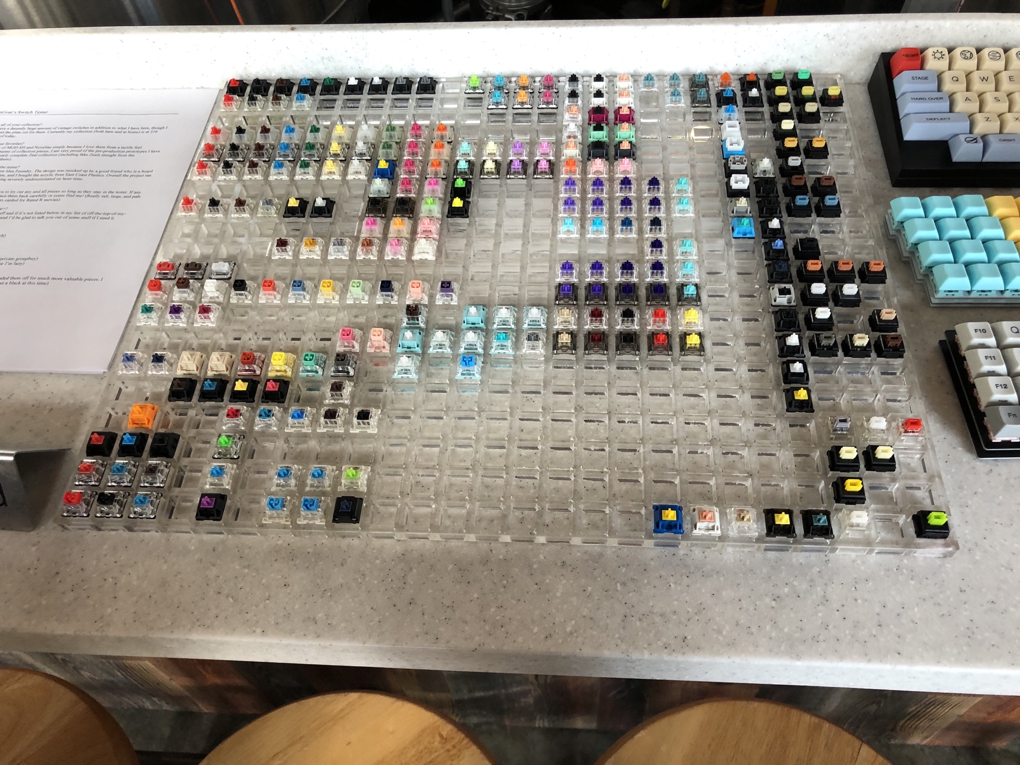

Don’t laugh. There are switch collectors within this community.
Mr. Theremin Goat’s collection (partial) from this last Cleveland Ohio Meetup. Notice he took the time to make up a fact sheet for these.
Too late. WOW! May have to drive to Ohio.
