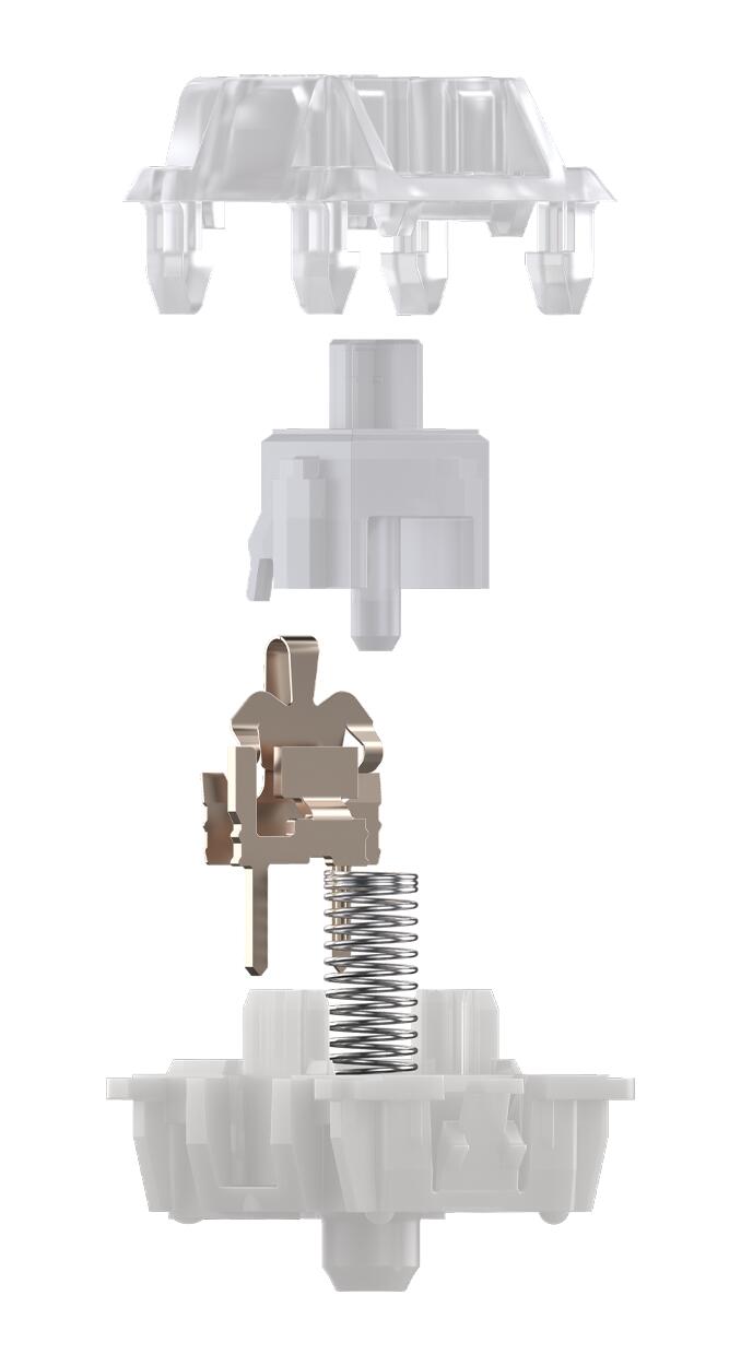

CHERRY MX Ergo Clear: Switch modification by enthusiasts becomes official MX derivate
CHERRY MX is expanding its own portfolio with the CHERRY MX Ergo Clear, a derivative that is primarily intended to address the DIY community: In 2011, what originated as a modification by enthusiasts from the mechanical keyboard scene has now been launched as an official MX switch and has been optimized according to CHERRY MX’s industry-leading standards. The so-called MX Ergo Clear is featured by a particularly tactile switching characteristic without an audible click as well as a comparatively light actuation force. This positions the model between the classic MX Clear and MX Brown. The MX Ergo Clear is the first special edition of a community switch from CHERRY MX.

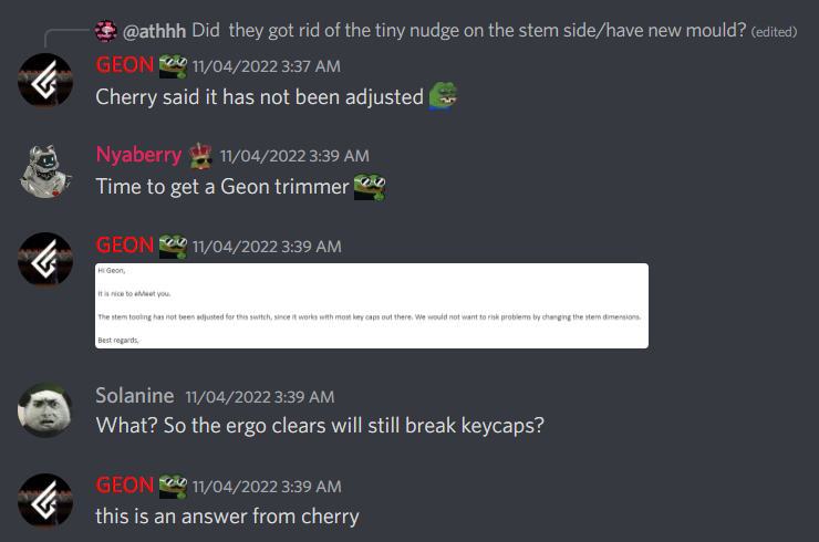

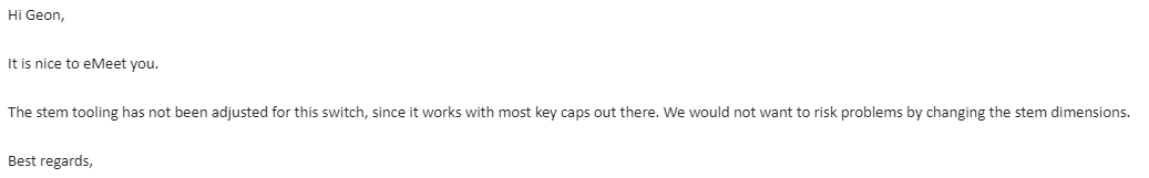

I thought I’d add this here in case anyone is wondering if Cherry changed the stem.
I wasn’t really expecting them to change stem dimensions. They are trying to make official Ergo Clears, after all.

I only tested the stem with GMK and JTK. Both are very tight, though I feel like I was about to break a few JTK stems so I didn’t want to risk it too much. Still, it’d be nice if Cherry adjusted the dimension a bit. :frowning:
In my experience the issue isn’t keycap damage, I do remember ripping out the stems out of the housing when trying to remove keycaps though.

The oversized Clear stems is a big concern for me for the viability of Cherry Ergo Clears, since most of the non-Cherry competitors don’t have this issue. They didn’t need to keep this aspect.
