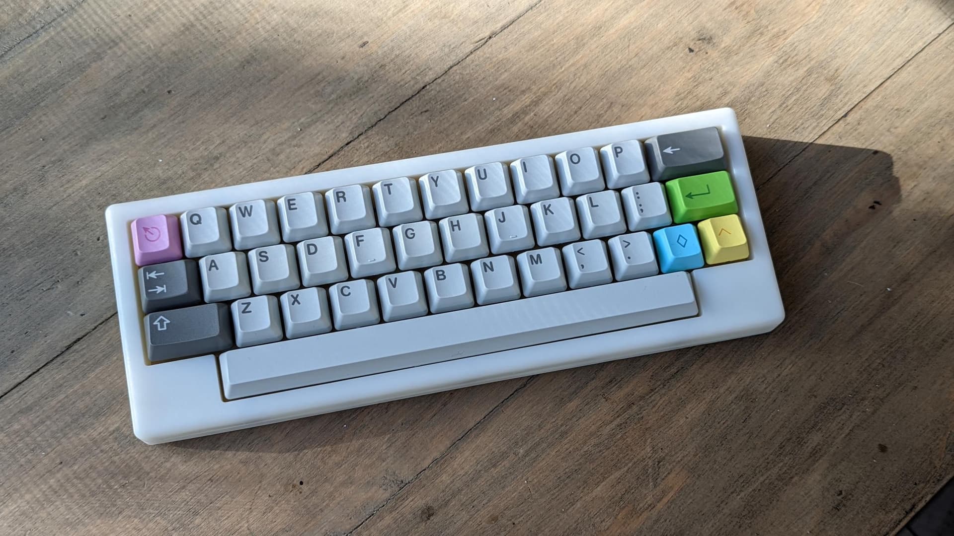

Yes, as a newcomer to Topre I’m very excited. The dream of a 40% Topre I posted the other day, seems ever more plausible.
Let’s see how this turns out. But I already see me adopting my Nova case for future builds.
40 percent Topre is close at hand. Viktus Minne second proto is ordered and if it works the group buy will kick off. Blindassassin111 does great work.
Apologies, I was caught in my own little world of 40% ortho, not staggered.
