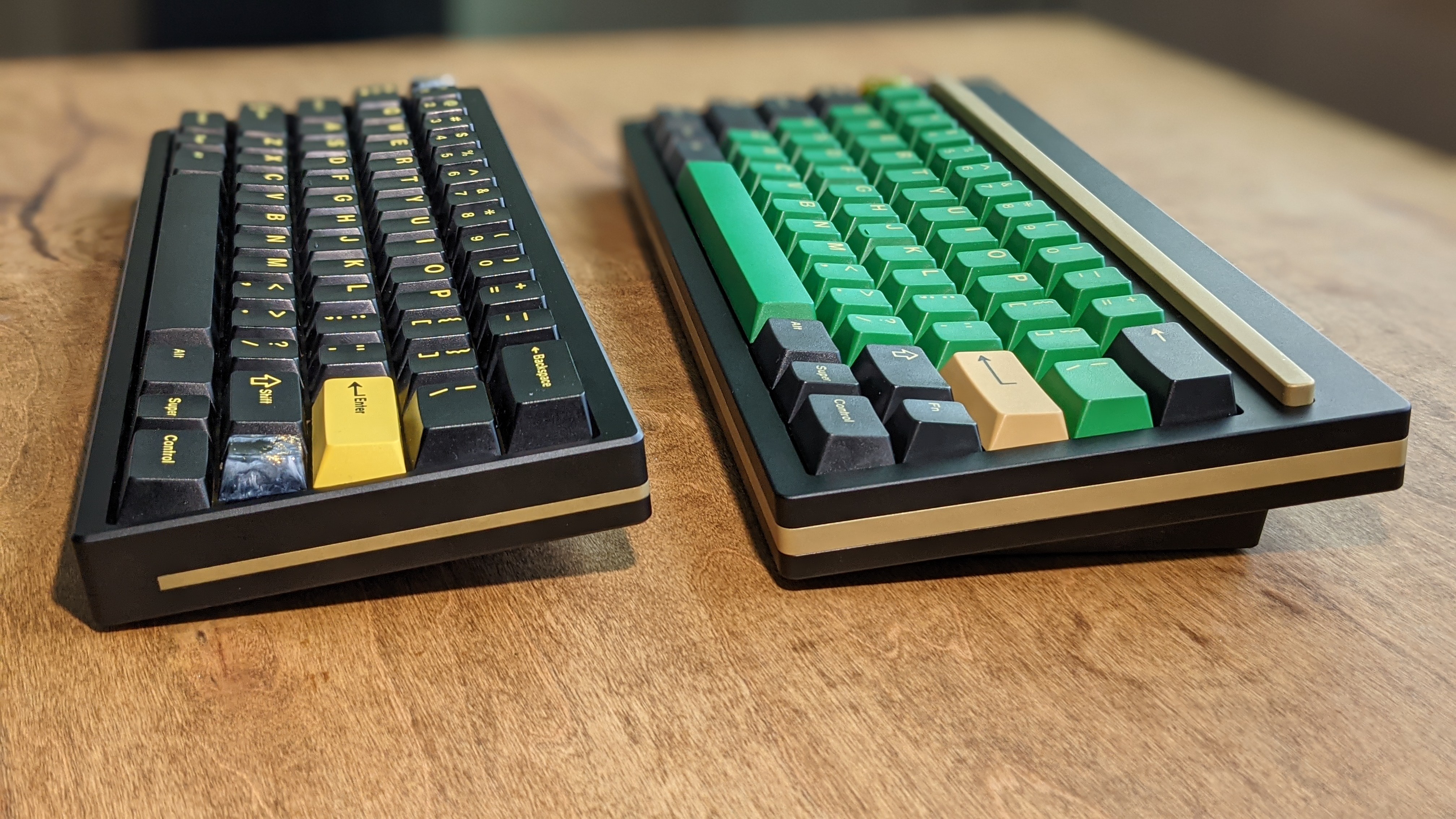

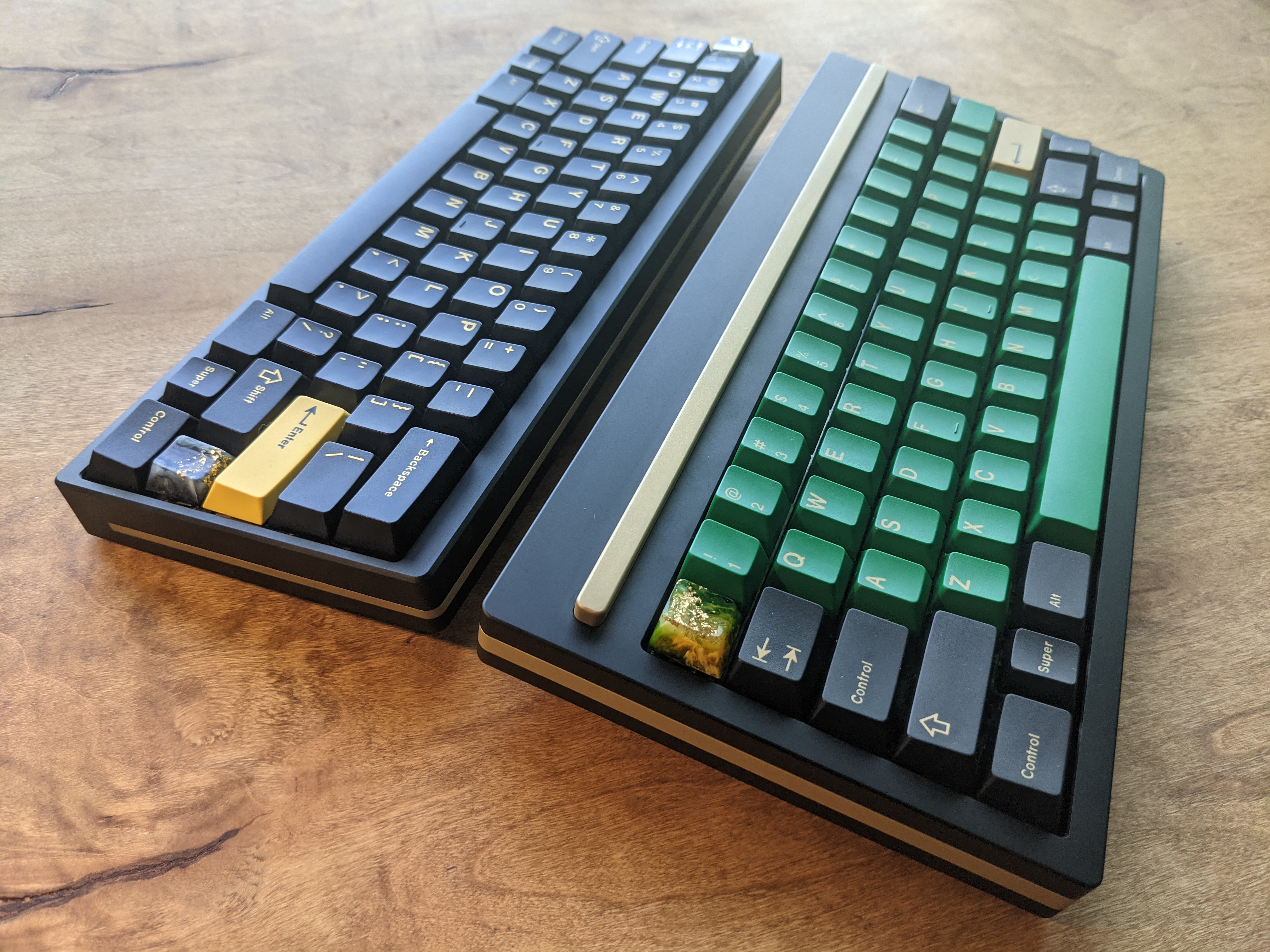

Design differences
My initial impression before I received these boards was that they looked similar due to them both having a brass line going around the sides of the board breaking up the otherwise monotonous black body. Now that they’re both sitting in front of me, I can’t help but think the way they implemented the brass on the sides gives off completely different impressions.
The accent line of the 1/60 avoids drawing attention to itself and isn’t present on the front of the board at all, which gives it an understated, classy look. By comparison, the J-02’s use of brass almost seems to demand your attention with how much contrast is present from every viewing angle. Where the 1/60 feels like a black keyboard with brass accents, the J-02 feels like a black-and-brass keyboard.

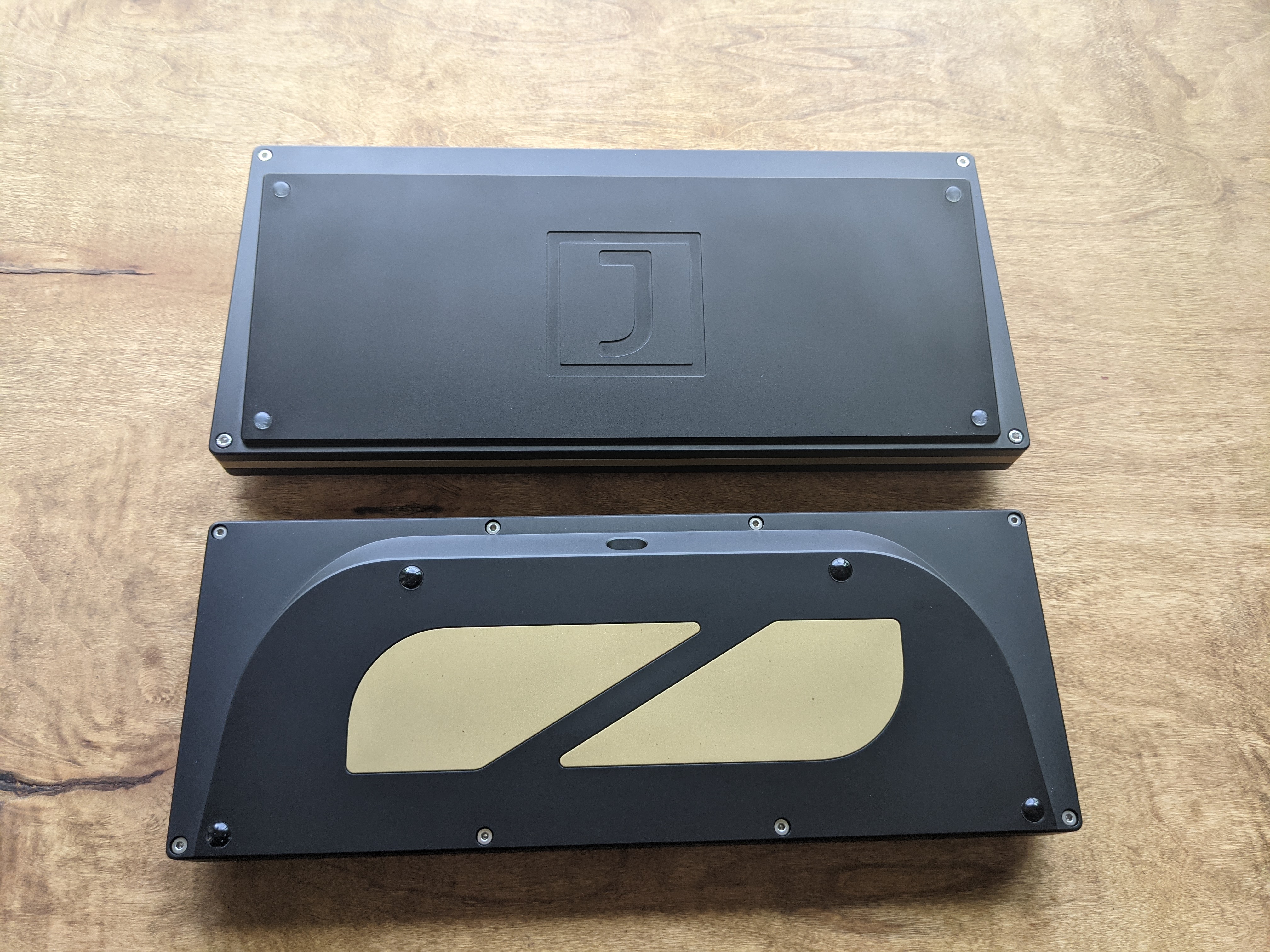

You may also notice in the above photo that you can see the base of the J-02 while the 1/60 appears to be floating, which brings me to the bottom:
I don’t think there’s much I need to talk about here; the 1/60 blows the J-02 out of the water in terms of looks here. Ignoring the designs on the face for a moment, the curves on the base of the 1/60 make it look like it’s floating from the side profile which is really cool. The J-02 was designed with a large sound cavity in mind, so the boxy base was somewhat unavoidable. Personally I don’t put a lot of weight on this since I don’t ever really have my keyboards upside down long enough to care, but it really goes to show that Keycult cares a lot about the things people usually don’t look at.
In terms of the bezels, the 1/60 has very small side bezels and just enough room on top and bottom to gasket mount the plate. The sides and bottom of the J-02 are about the same width as the top/bottom on the 1/60; just enough space to mount the plate into the gasket that goes all the way around the board. And then of course the J-02 has a giant forehead for space to put a pen down. Like with the use of brass, the 1/60 appears much more minimalist and doesn’t draw attention to itself, but has more attention put into little details like the edges having an angle cut into rather than just being rounded off to make the bezels appear smaller than they actually are.
I’ll also note that the large top bezel and pen rail on the J-02 makes picking it up a bit more of a pain than the 1/60. I can’t wrap one hand around the J-02 comfortably, and when picking it up from the sides you need to put your hands right around the top row and the pen rail for it to be balanced. The majority of the 1/60’s weight is in the brass that extends to the bottom, meaning the board’s center of gravity is right around the physical center of the board. It isn’t a large or important difference, but again Keycult’s attention to detail just makes their board seem more premium.
