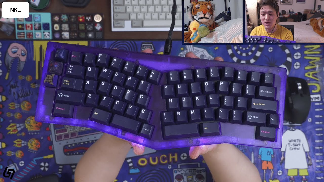

Might be a good new option.
I was watching this stream and I’m really interested in this board.

That looks really promising! That might be perfect to put together and throw in my bag for classes.
