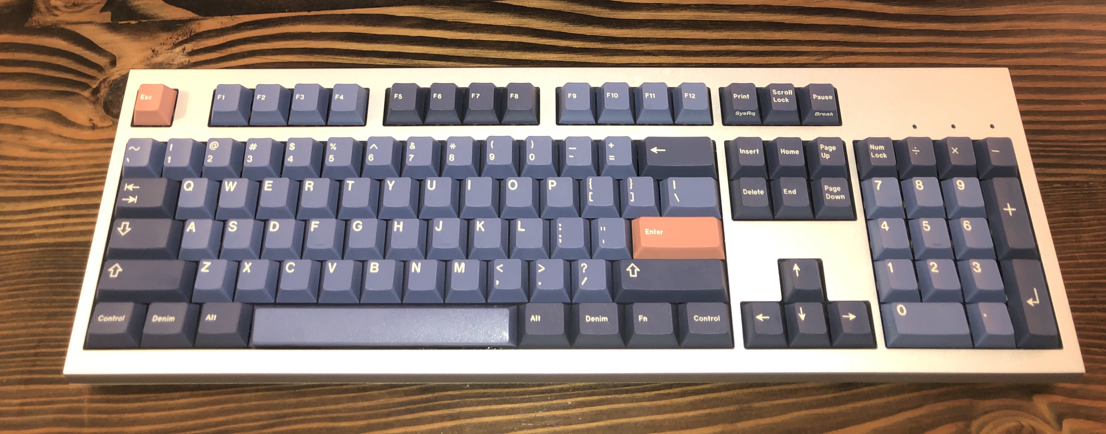

So glad you asked. This is the ugly duckling of flawed boards but I like it.
Lovable Because
It’s all mine including concept, design, custom parts, hand wired and QMK configured.
It’s a poor mans split (single board with separated keys)…my shoulders appreciate it.
When I built it I hoped I would like it. Turns out I like much more than I thought I would.
It’s got a little Red, White & Blue!
Flawed Because:
Crappy keycaps but nice keycaps to me seem to be a waste of money
It’s ugly
Still has a cheesy USB cable with the barrel on the end
It’s not finished…sitll need finish bolts on top and bottom
Less than artistic wiring job
The corrugate at bottom of board is to keep from scratching desk
Invest in new caps, a nice cable and some rubber bumpers on the bottom and it will come alive

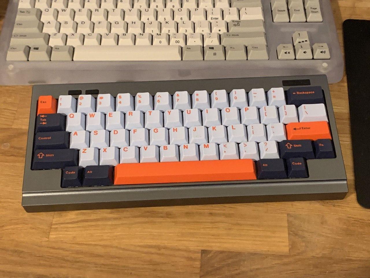

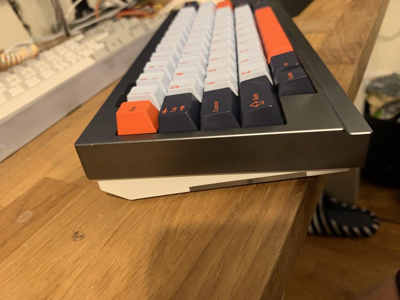

Mine has got to be my ALF X2. Buckle up and grab a beer, the story of how this became one of my favorite boards is going to involve some rambling.
The year was 2017. I had a fraction of the keyboards I have now; I had only built a few. Box switches were relatively new. Micro-arc oxidization (MAO) white was all the rage (a finish that was common before the E-white we see a lot today). I had recently bought an HHKB, which was also my first 60% (although I had a clueboard), and I was in love with 60%. The ALF X2 showed up on my radar, and I had to have it. I was drooling over that white finish, with the black buttons, and a BoW keycap set, it was going to be amazing! I ordered they keyboard. It was like $40 extra for MAO White, no matter if you got the top or the bottom or both in with it. I couldn’t wait. I ordered both in white. At this point you might notice in the pic above, it’s not white. Be patient, we’ll get there.
As I mentioned above, box switches were new (do you see the train heading for the wall?). I ordered the keyboard in the late fall. I was still in love with clicky switches, and started hearing rumors of “thicc clicks” from Kailh/Novelkeys. As soon as I heard about them I had to have them. That January I got to go to CES for work (first week of Jan if I remember correctly). I made time to visit the Kailh booth, and asked the nice lady there about the Jades/Navies. She had no idea what I was talking about. However, they had a box of little baggies of 5 or so of random samples of switches. She told me I could have a few if I could find what I was after. I scored two jades and two navies! I took them home and put them in a switch tester, they were awesome. I ordered them as soon as I could.

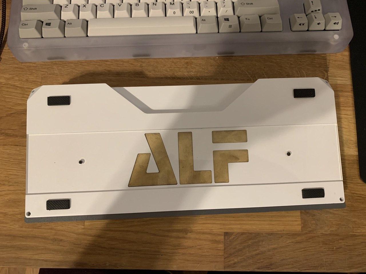

The keyboard came! I opened the box and… It was grey. The top was grey and the bottom was MAO white. Not gonna lie, I started swearing. I started to write an angry email. I realized I needed to chill and went back and checked my order. I messed up and ordered a grey top and MAO bottom. I paid an extra $40 for an MAO bottom that you couldn’t even see! My disappointment was immeasurable, and my day was ruined.
There’s another piece to this story. GMK Yuri. Around when I was graduating university this set showed up on (mass)drop. I ended up buying it, even though I wasn’t sure on the colors. I didn’t like the renders, but had a feeling that I might like it better in person. I got it and didn’t have a keyboard to put it on. That was the first time that ever happened to me. By the time I got it I was settled in an apartment. I wasn’t super impressed with it, but I also didn’t not like it. Underwhelmed is about right. I put it in the closet and sort of forgot about it. Also first time that happened.

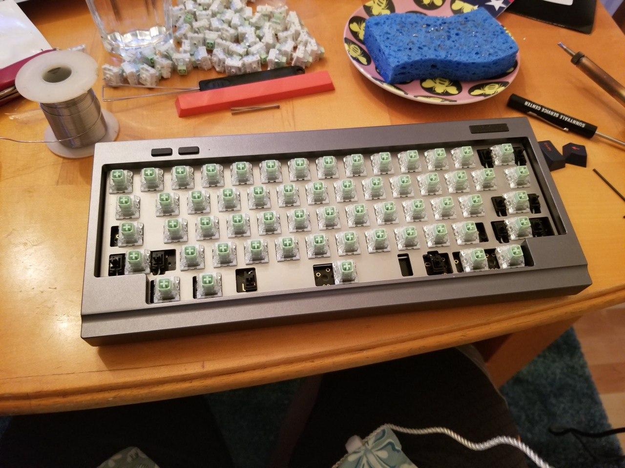

So back to the X2. After a few days I got around to putting it together. I didn’t know anything about stabs and didn’t lube or clip them or bandaid them or anything at all, they were like some knock off clip in stabs. They sounded and felt like shit, but I didn’t really care because I finally had a box jades board! It sounded great (to me back then lol). I needed a keyset to put on it. I went to take 1976 off the norbatouch I had recently got. But does anything really match retro refrigerator better than 1976? probably not. I couldn’t do it. I remembered Yuri was in the closet. The match seemed right, a keyboard I was underwhelmed with and a keyset I was underwhelmed with. I used it at home for a while, and it started to grow on me. I couldn’t take it to work because I worked in an open office and it was way too loud. The guy on the other side of my bedroom wall probably hated it. He complained I was too loud when I was talking on the phone with my mom.
I was starting to like the board. And then another bomb dropped. The Jade switches I had were the defective GMK stem breaking ones (I measured to be sure). I took the keycaps off and just let the board sit for a while. First the keyboard failed me. Then the switches failed me. I almost wish I had just left the switches and never changed the keyset. After a few months I decided to rebuild it. We had an awesome desoldering gun at work so I could get all the switches out real fast. I broke one or two traces taking them out, but nothing major, it was fine. I had some zealiostotles from a failed dactyl build (I did a bad job wiring it and some of the switch bottoms got melted soldering wire to them (early zeal problems
) I could never adjust to the layout anyway) so I decided to use those. They don’t have the same oomph that the jades did. They’re zealiostotles, so by definition they’re inconsistent. I didn’t do much about that and used almost every one I made. The pitch was different than the jades. It made me sad. I didn’t do anything about the stabilizers and they still sound like shit to this day. I dunno if it was the aristotle stems I got or what, but the keycaps are super loose on them. It’s not just because they were on the bad jades either, I’ve tried a few sets to see. I didn’t do the best job re-soldering it, the enter and ‘j’ keys aren’t straight. I seriously considered selling the board.
I decided to keep it. It had been out of rotation for a while so after a few months I started using it a bunch. There was a while there where it was in the back of every picture of everything on my desk, including other keyboard builds. Over time it grew on me. Over time Yuri grew on me. I don’t know how I didn’t see it initially, but it’s easily become one of my favorite keysets ever. The fiery orange just goes so well with both the light blue on the alphas and the dark blue on the mods. That orange spacebar is a statement of intent. It’s something special. I’m now ride or die for Yuri, in my opinion it is one of the greatest keysets of all time. I have a rule that I will only get one variant of any keyset. I broke that rule with mitolet, but now that I have the GMK version I’m ready to sell the SA version. When I saw the DCS ALPS version there was no question that I was getting it. Doubt didn’t cross my mind. I won’t sell GMK Yuri.
Once I came to terms with the keyboard I came to love it as well. The design was and still is unique, in a time when there are so many 60% boards out there. The buttons at the top are not something I’ve seen since. It was so faithful to the original HHKB that it has a USB hub and three ports at the top which I don’t think I’ve ever actually used (the prototype said HHKB in the bottom right, thank god mine doesn’t). The dip at the bottom is a defining feature. The back is interesting as well. The brass weight is held in by a clear piece of plastic over it, which always seemed kinda janky to me. I’ve heard the MAO is prone to scratching, but I baby it and haven’t found out. It’s sad that ALF’s story in the keyboard community ended the way it did, because I think this ended up being a truly special board, and will always hold a place in my heart. I got the ALF X3 on the strength of this board (it isn’t as cool) (but it still is cool).
Other keyboards have come and gone over that last few years, but this one will stay with me always. I hadn’t used it in a while, but pulled it off the rack when I started thinking of writing about it. I just wrote this entire thing on it. It’s not a layout I like as much these days, but I still really enjoyed it. I hope my roommate was able to fall asleep
I think this is the only board I have with clicky switches anymore, and you know what? It’s awesome. I even love the color of the board now. Who else out there payed $40 to get a white bottom you can’t even see? I bet it’s unique. That’s a flex.
Could I fix it? Sure. I could rebuild it with plate foam and tealios and C3 stabs and it would be amazing. I bet I could even get it cerakoted white or something. But it’s amazing how it is now. Some days you just need a clicky board and all that matters is that glorious audible feedback.
Thank you for coming to my TED talk. Sorry for the full book about this keyboard, I hadn’t used it in a while, and pulling it out got me nostalgic. I should write more, this was cathartic. Maybe it was more for me than you. It’s been a long week.
Flaws:
- Some misaligned keys, especially enter
- I really prefer split backspace and full size right shift
- the stabs sound and feel terrible
- Keycaps are super loose, you can pull them off by hand very easily, no puller needed
Anyway TLDR: I built it with bad switches and the stabs are bad and some of the keys are misaligned but I still love it.

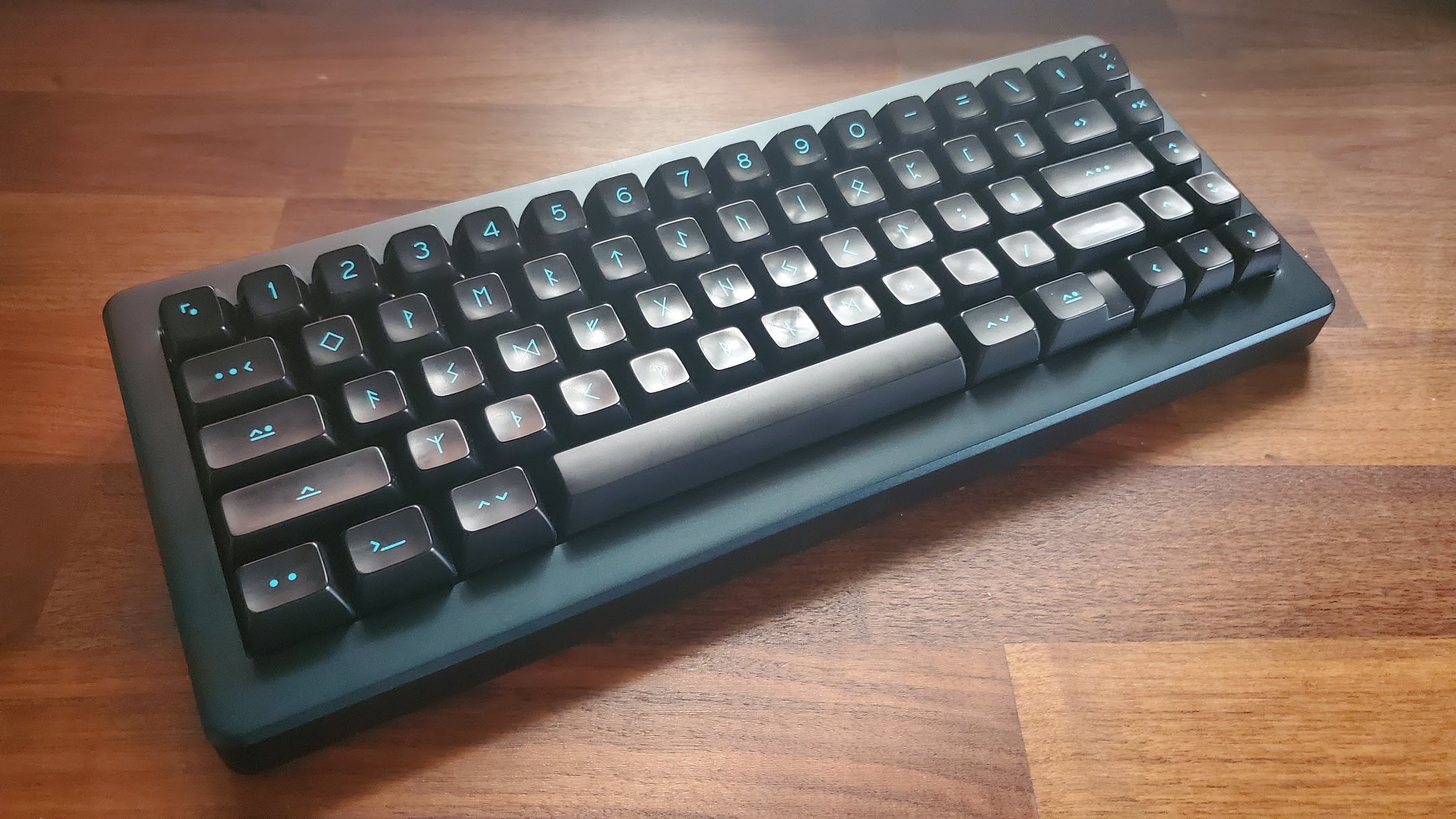

WASD Saga Part II
Ok, I’ve got another one. Just built this today. (you guys sick of me yet?)
This was not so much a planned build as just putting together parts that I had lying around + some sick caps I got in the mail today.
Extremely disgusting WASD donor I got off eBay for $39. The before shot isn’t very good as I took it off an old eBay purchase.
After
Bought one of the new silver CNCd aluminum cases off WASD. Put some phoenix stems in durok housings. Caps are GMK Denim with Honeywell Mild Pink accents.
What I like:
It looks kick ass! Very pleased. The case is great.
What I dislike:
Well… the switches. Honestly, I’m disappointed.
I am someone who likes clicky switches. My first board was a WASD with MX Blues. When I
discovered zealiostottes I couldn’t wait to put them in my board. However, they wouldn’t bounce back unless I put 67g springs in them, too heavy for clickies IMO. So I was REALLY looking forward to trying phoenix switches with 62g springs. If this was a successful build, I was planning on transplanting these into my original WASD.
Not gonna happen. In comparison, the zealiostotles feel much tighter, a good solid click. These phoenix stems are rattly, somewhere between MX Blues and the stotles.
On top of this, even with some drawer liner installed, the click is ear piercing, yuck. It could be the combination of the switches inside the alu case but I’ve got jades and box pinks in metal cases and they sound great, nice and thocky (yes clickies can be thocky in the right build). The box switches also feel nice and smooth. These phoenix switches? Poo. Ok, that’s harsh. They actually have pretty nice tactility but I’m after perfection here. These are not ‘Oooh yeah’ satisfying.
I really wanted to love these but I think box pinks are my favorite MX style clickies. I was planning on getting a black case from WASD but now I’m hesitating (because of the sound, not the quality. I would def recommend the alu case). I don’t want to get it only for it to ruin the sound of my zealiostotles. Right now they sound pretty nice in the plastic case.
