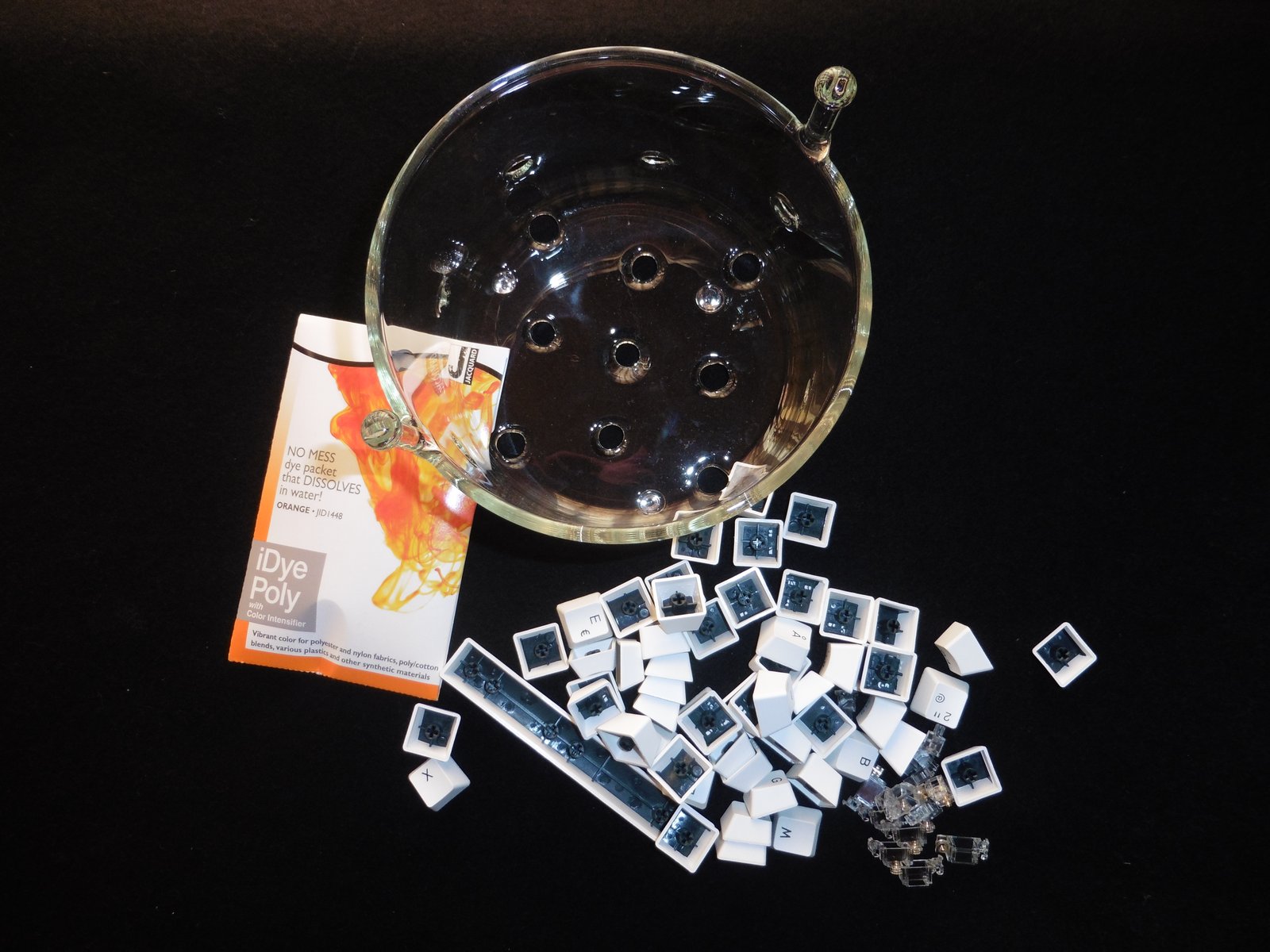

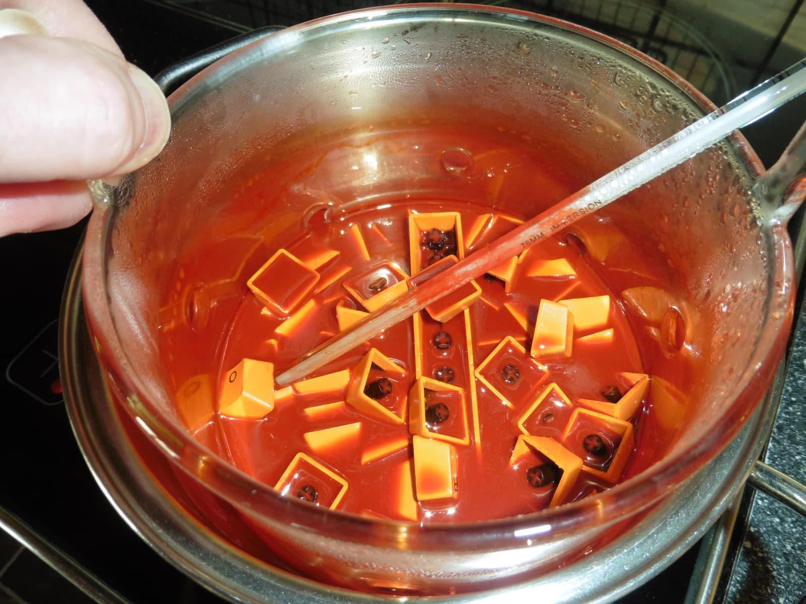

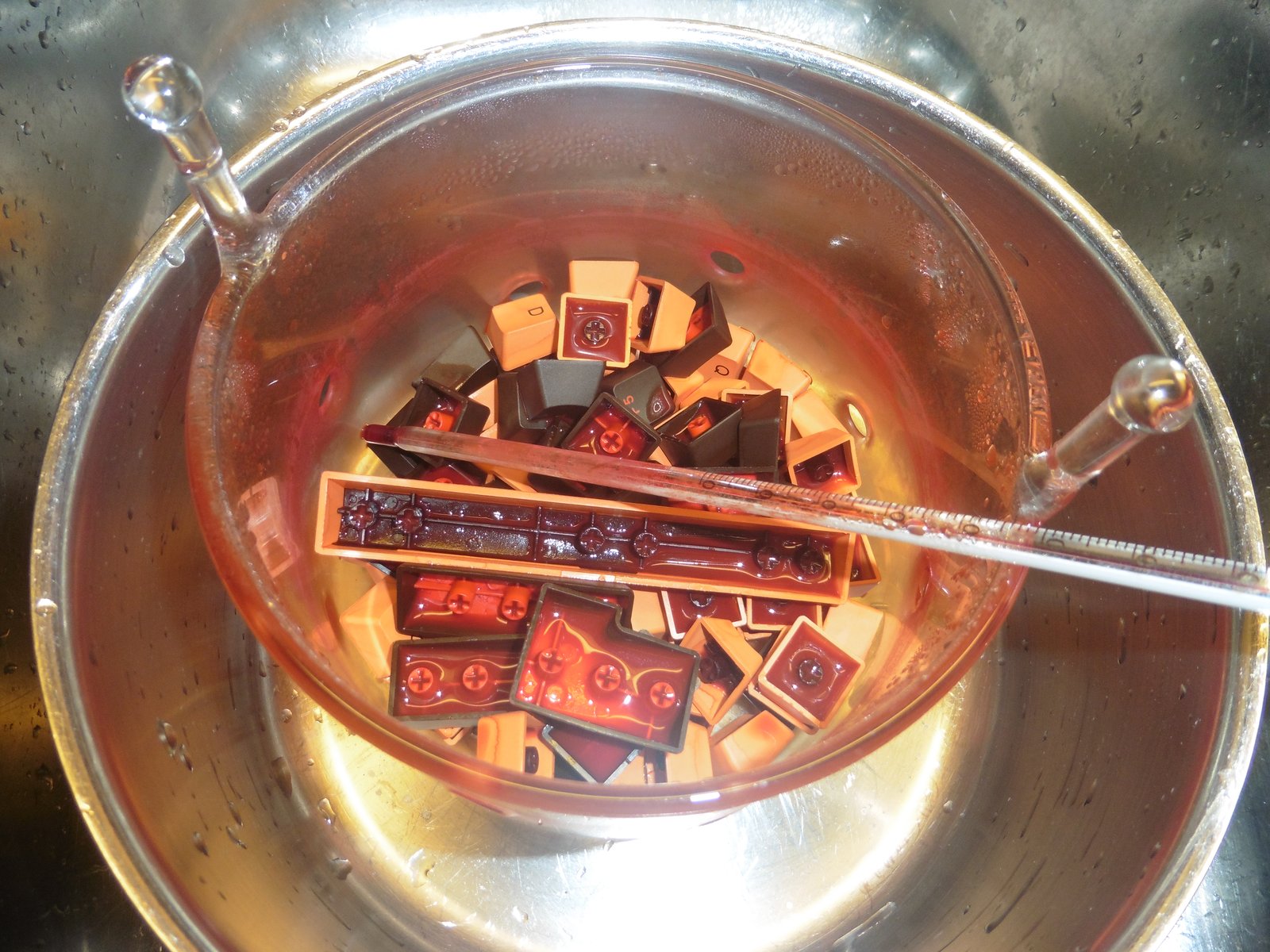

So, I decided to risk it…
I’m going to dye double shot keycaps, or at least try it, together with some stabilizers.
I thought about it many times, but never dared. Until now
PBT double shot keycaps from a Ducky Tuxedo, and some Durock V2 stabilizers.
While I’m waiting…

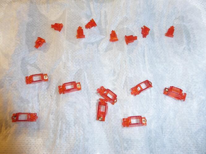

EDIT 1: The stabilizers seem to dye incredibly well.
Ahh the fabled glass strainer! Very nice, I’m excited to see the double shot results.

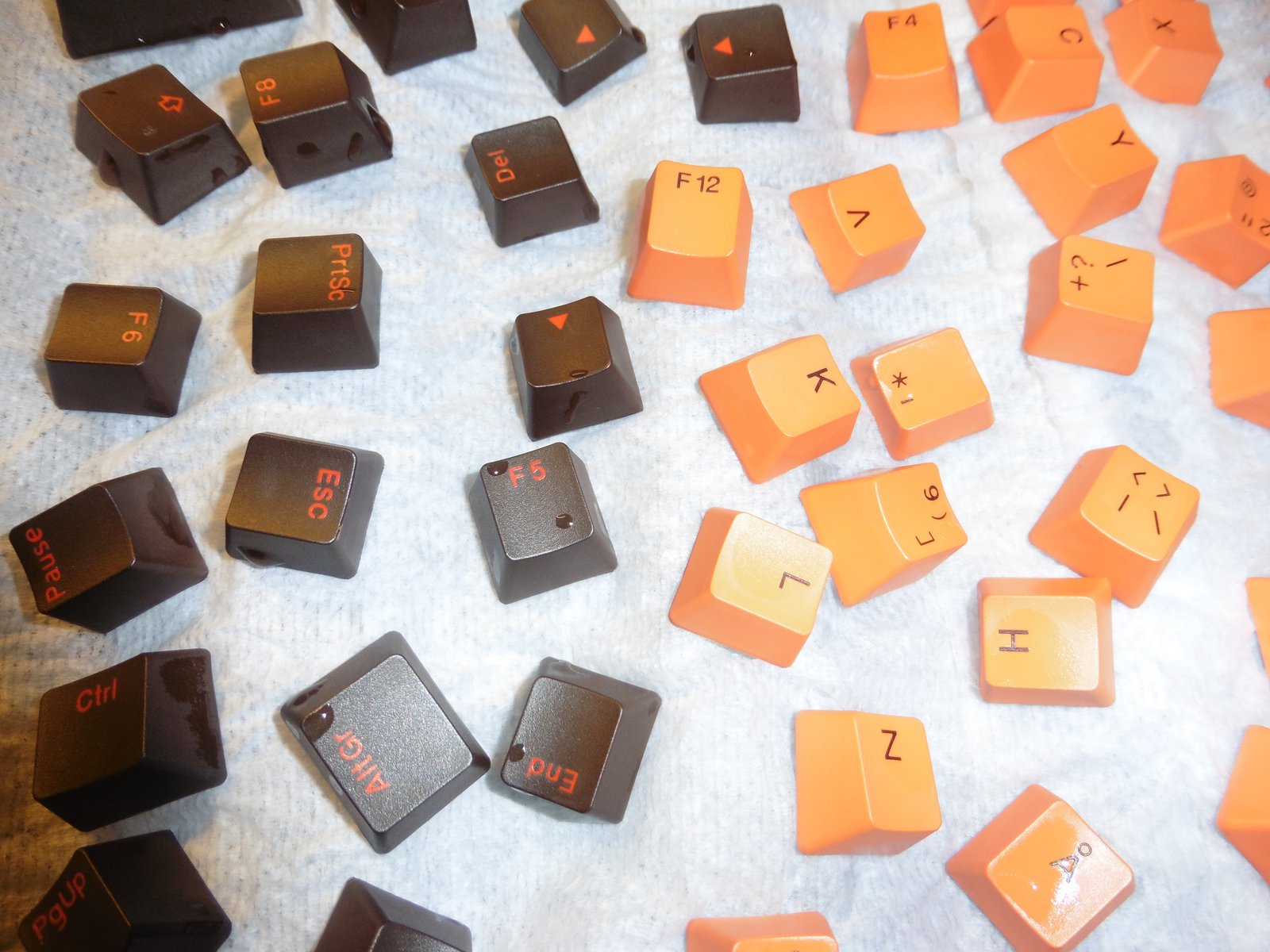

That worked pretty well:
The white-on-dark-grey mods went into the dyeing solution later than the alphas.
The end result is surprisingly good.
I wonder if this would decrease the gap with the wire/housing rattle
63N
7
Interesting question, but I doubt it.
The stabilizers are made of nylon, and nylon can take a lot of heat before it warps or even shrinks.
But I’ll let you know.
