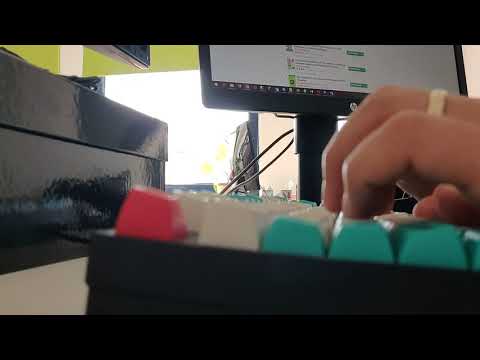

I have put Dynamat in a Novatouch.
Its malleability helps when you have a case with a lot of bumps.
Watch out for the cover because it is metallic and can cause shorts if it touches the pcb. I have put electric tape on it.
You could remove both sides of the cover, but in this case it can stick to the pcb when closing the case.
The result is one of the thockiest keyboards I had the pleasure to type on.
Don’t forget to thumbs up, subscribe and click the bell icon for notifications.
Joking… This is my first youtube video and somehow I fell proud about it :))
