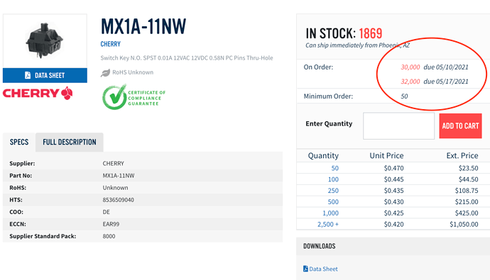

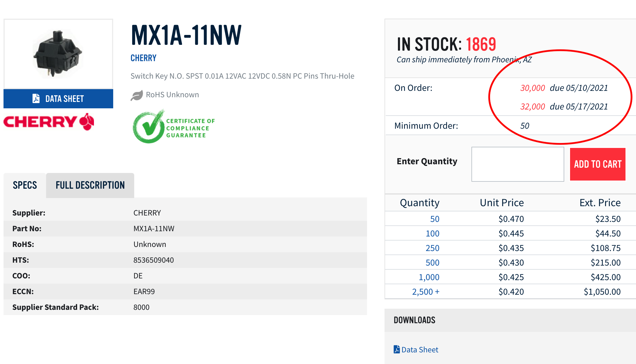

Looks like Hyperglides will be available in US mid-May. The screenshot is from a US distributor’s website for 5-pin retooled blacks (spec say 50M press instead of 100M). Cherry confusingly uses the same part number for both retooled and hyperglide.
Not sure if the pricing will change from retooled blacks (~45 cents) but, given that Hyperglides are priced around that range in Asia, I doubt it’ll change much. I did see them selling at 28 cents per switch in Chinese markets but I’m not sure if they are fakes or not.
