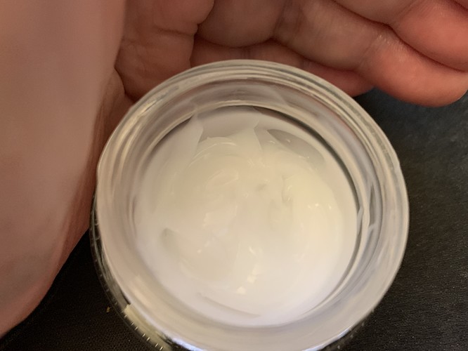

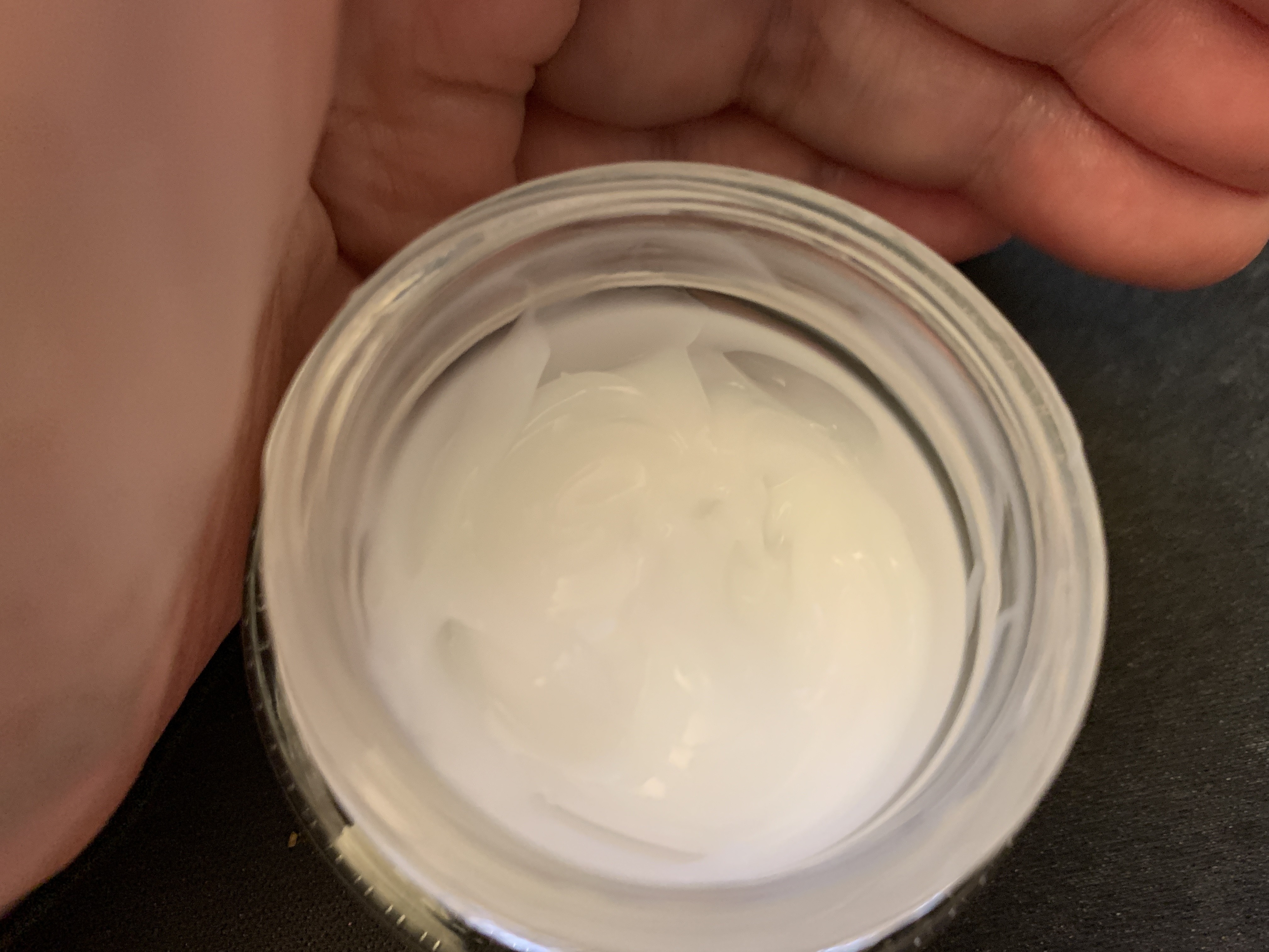

Checked the jar of 205g0 I got a few days ago to see if they started separating. Nope. Looks like it’s the OG, not a 205g2+105 mix.
That’s impressive. Even the stuff I get from krelbit has some separation usually.
The jar is from Heebie Keebies which just happens to use the same SMS originating number as SwitchMod
 so maybe 205g0 quality has improved.

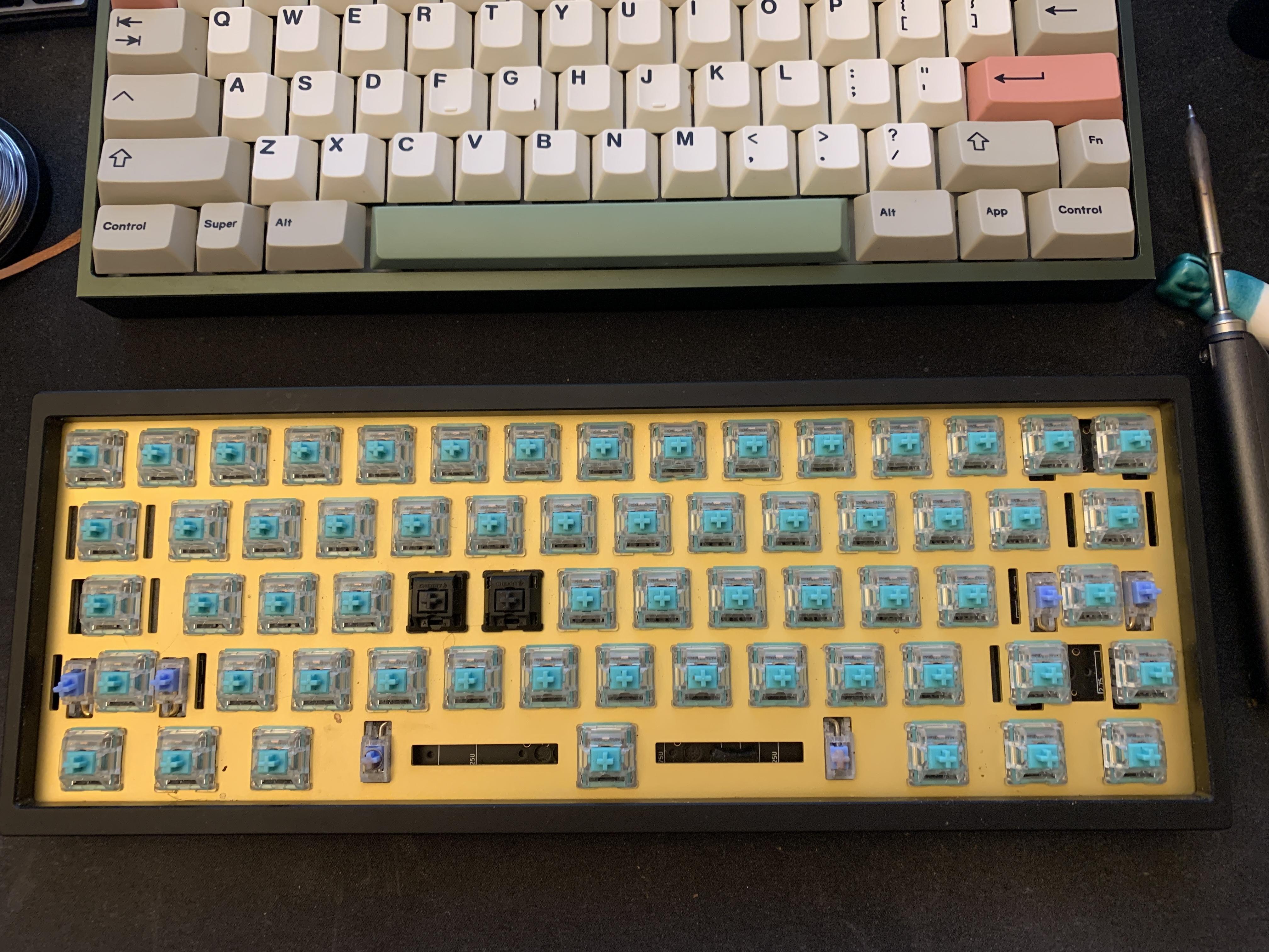

Tealios sounds surprisingly loud and lively in Polaris with distinct likable tone. I was very happy with the switch but was not happy with franken-stabilizers (still can’t believe I didn’t notice the unbearable wobble when I built it). Before desoldering the switches to replace the stab, I wanted to try a couple of polished Cherry blacks to see how they might sound in Polaris.
Conclusion: Both Hyperglide and retooled black sounded very muted and flat. I’m going to do the same test with FR4 half-plate version but Tealios will stay on the full brass plate version. Disappointing.
UPDATE: Tested Cherry blacks in FR4 half-plate build. Better result: they sounded better than Gateron black inks. Like aluminum Tofu, retooled sounded more pleasant than Hyperglide. The later was making loud inconsistent clacks. I’ve no idea why retooled blacks would sound better on aluminum case while Hyperglides sound better on acrylic, at least to me. So looks like I’m going to be desoldering two boards. Oy.
In case you’re wondering, polished blacks I tested with felt just as smooth as Gateron Black Inks and very slightly less smooth than Tealios.
