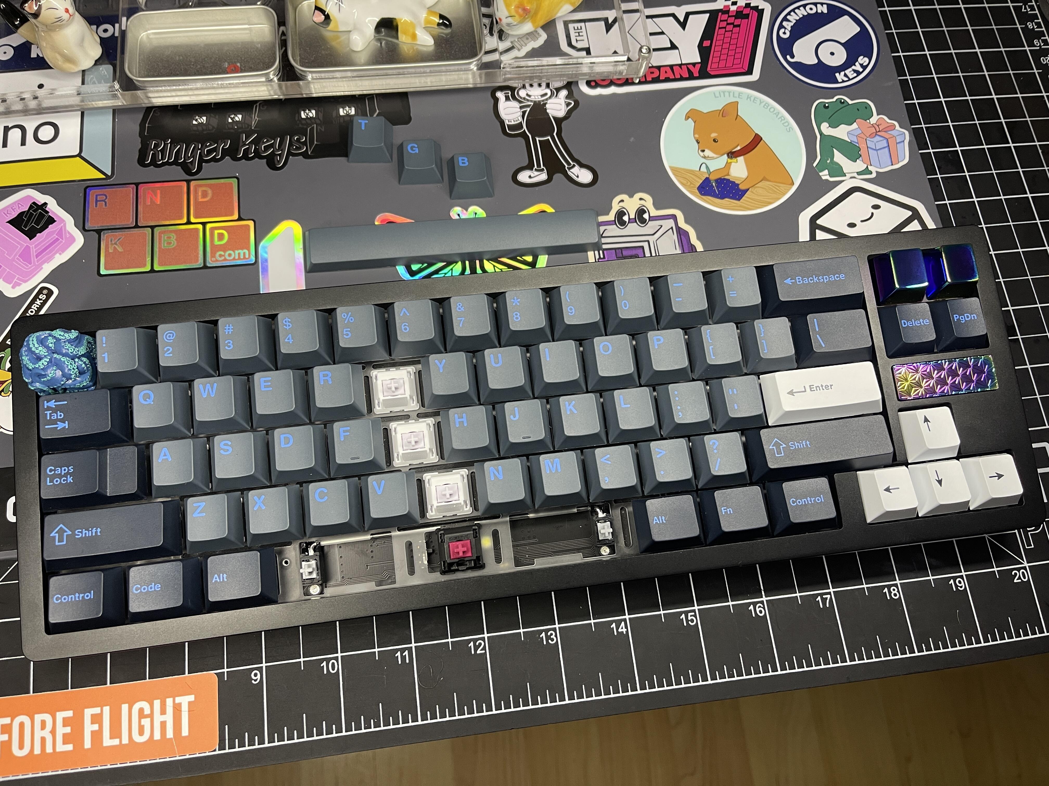

I decided to pull the AMAZING Durock Black Lotus switches out of my Ikki68 and pop these in. I chose to round things out by using WS Kraken keycaps. (I swear this post isn’t sponsored by Wuque Studios. Honest!!:grin:)
Non-Icky Ikki

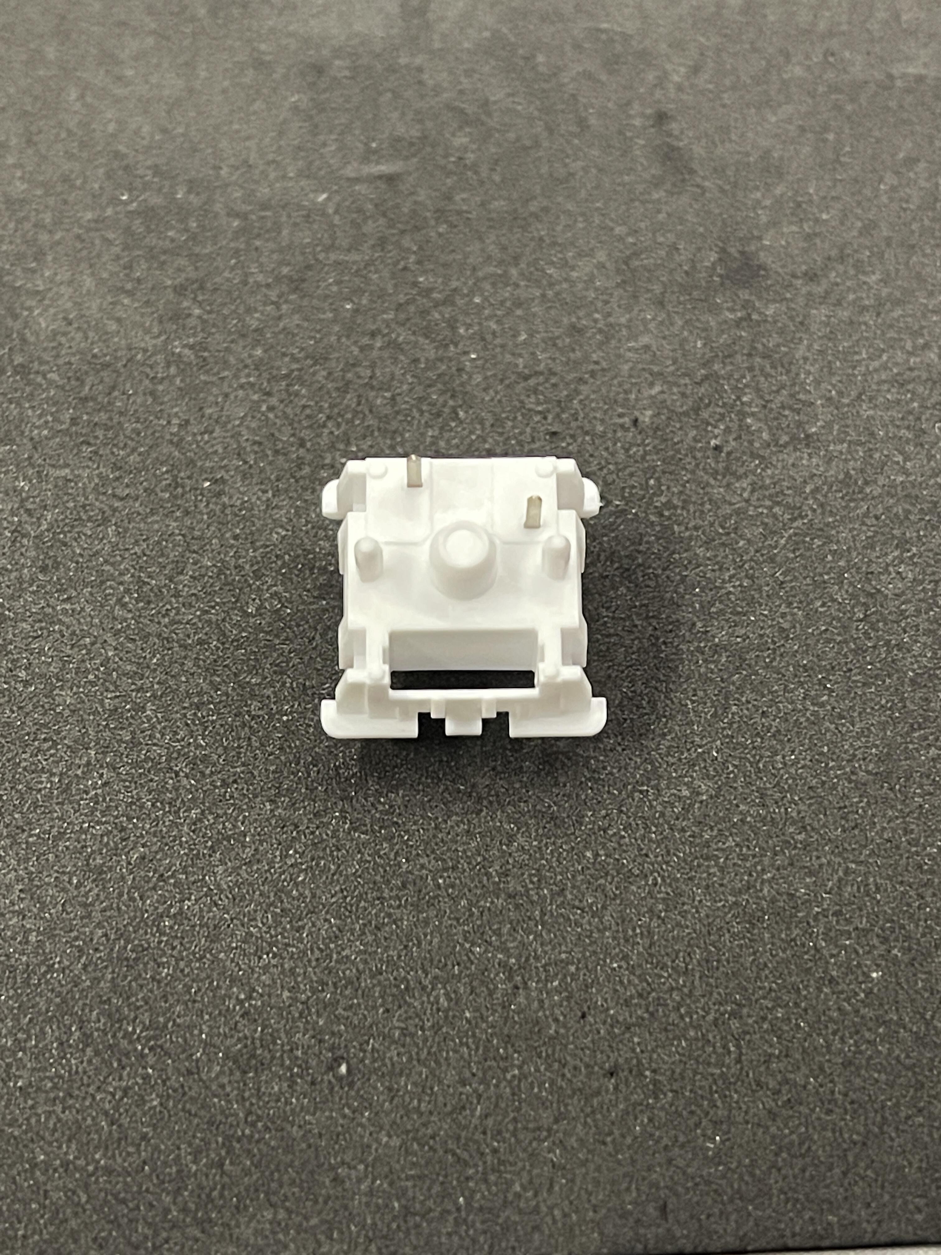

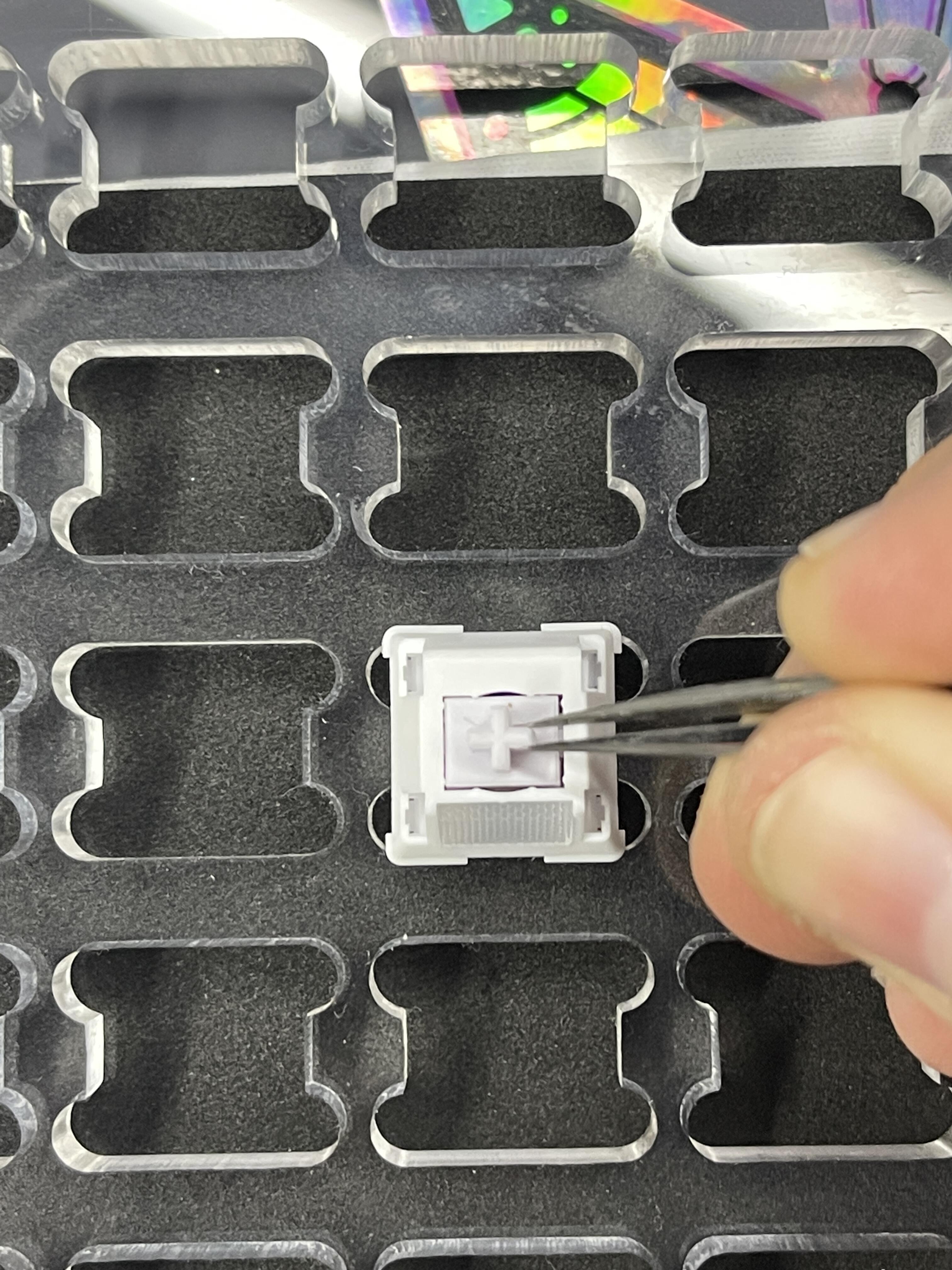

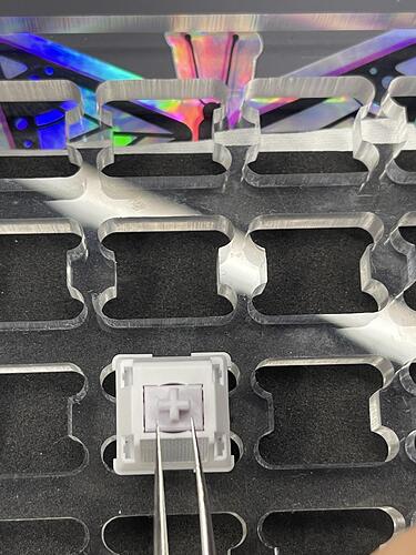

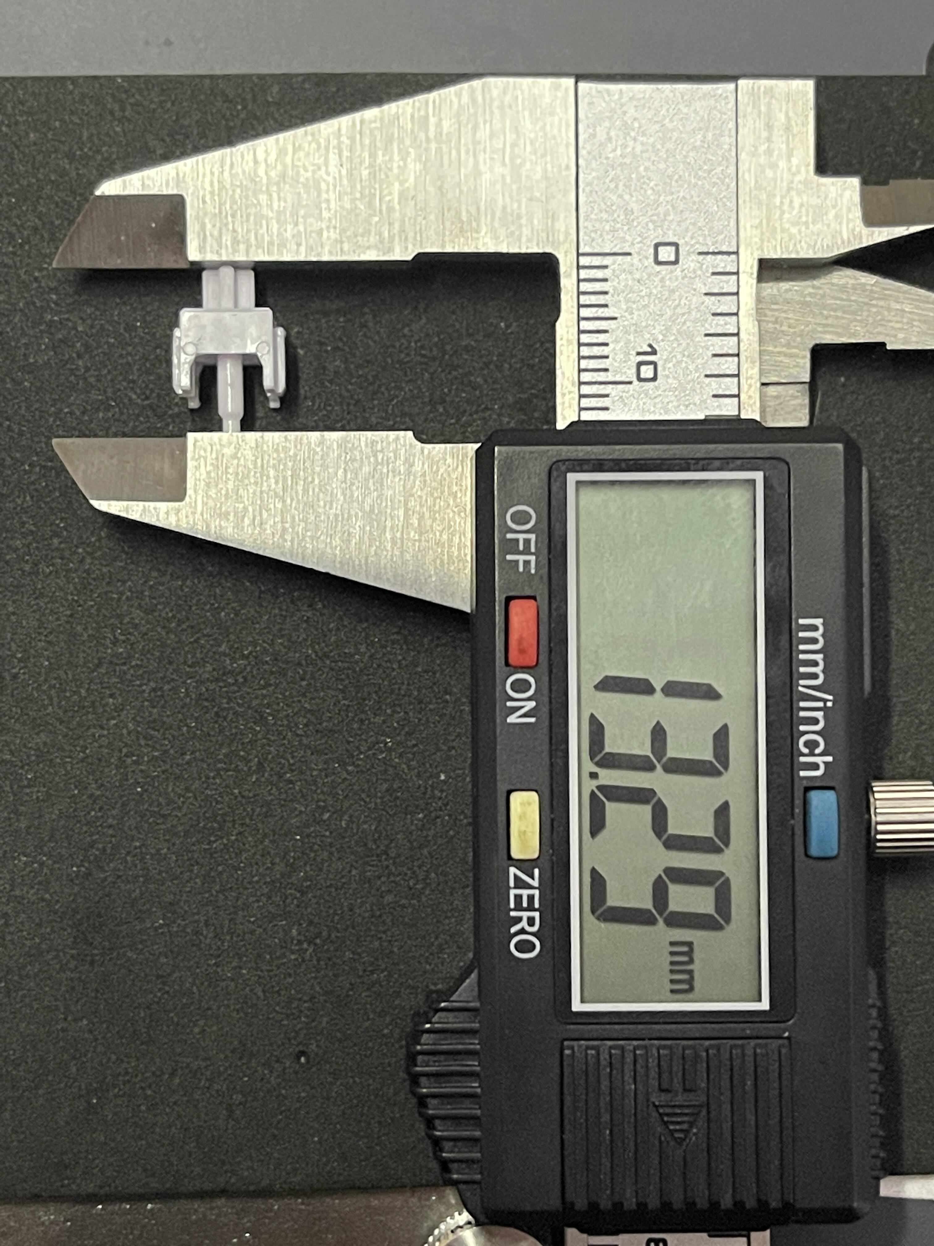

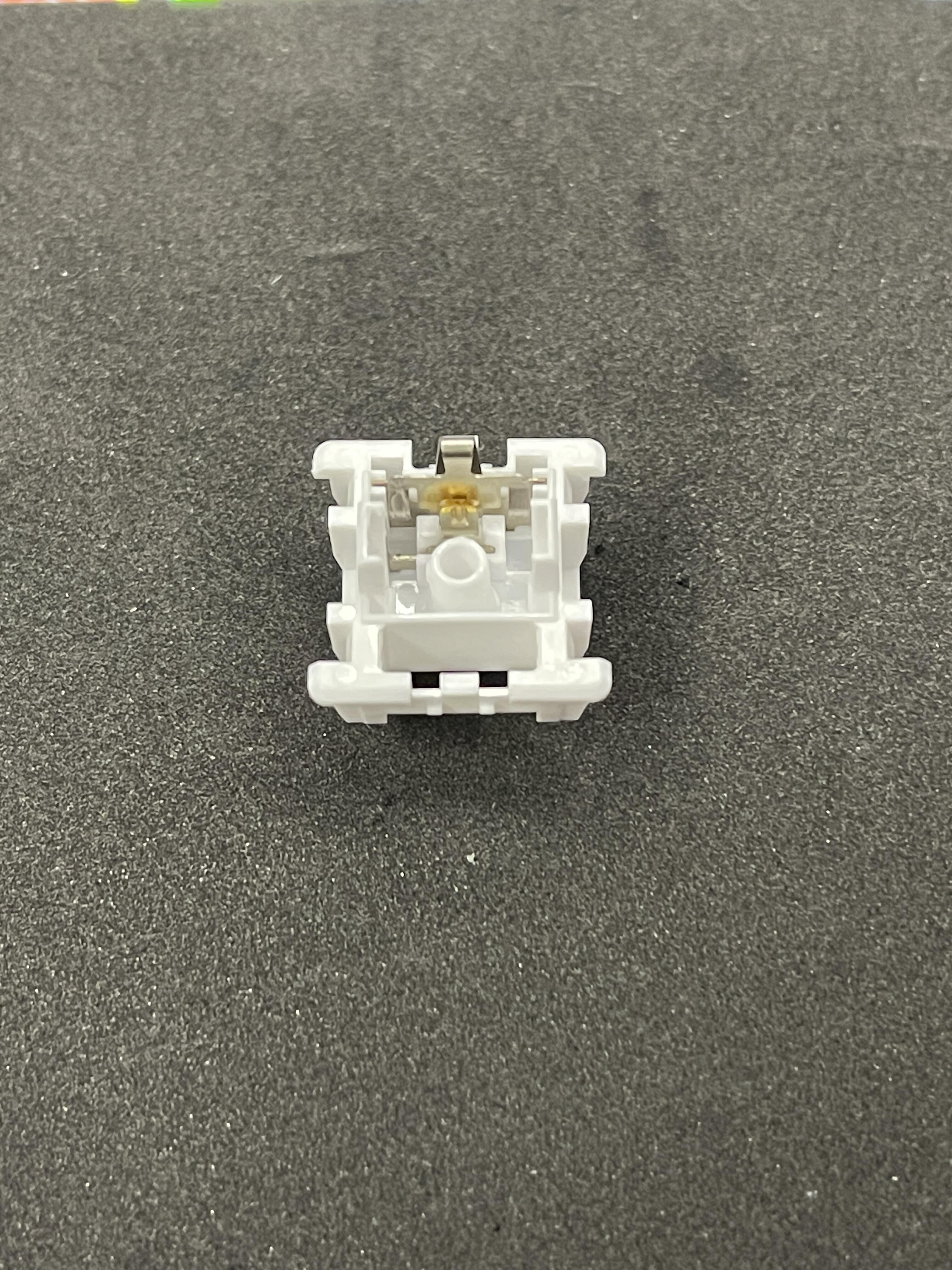

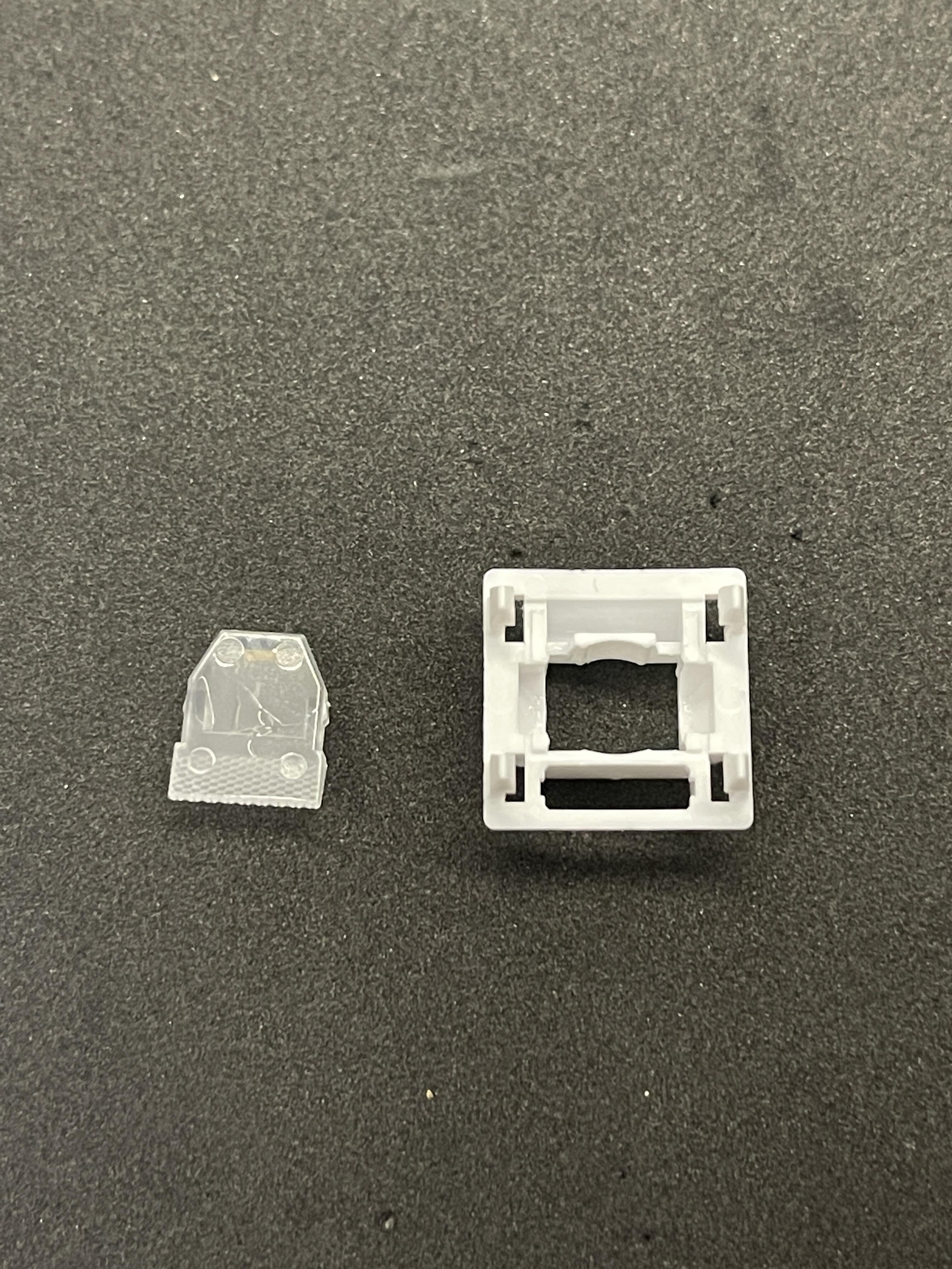

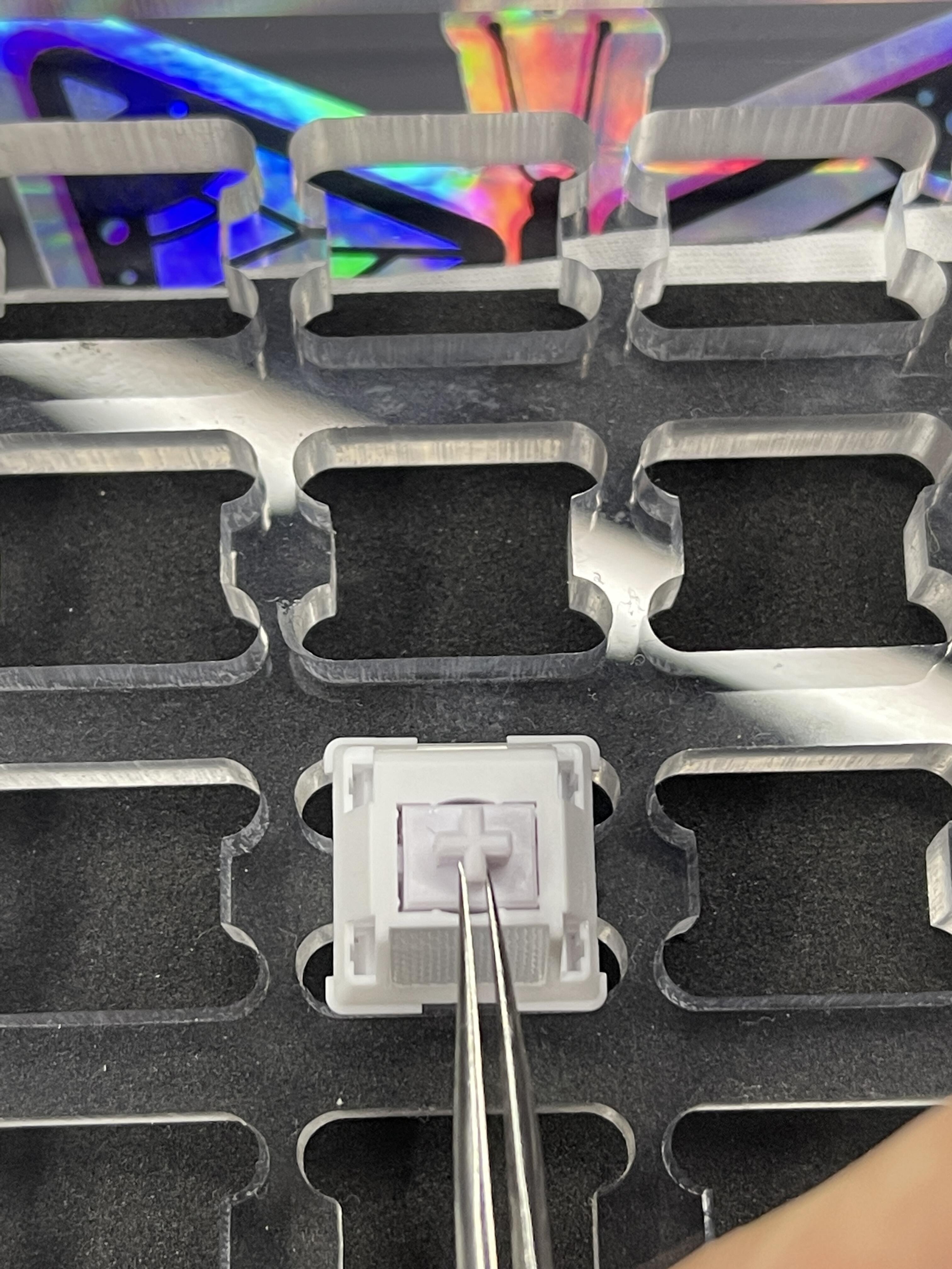

I have to say, I was not expecting this whole package to come together so nicely. These switches impressed the hell out of me! Springs feel perfectly weighted and not a hint of ping or crunch. Actuation was smooth and snappy. Bottom and top out sound was clacky, but not harsh. Quiet enough for office work, but definitely not the quietest linear I own.

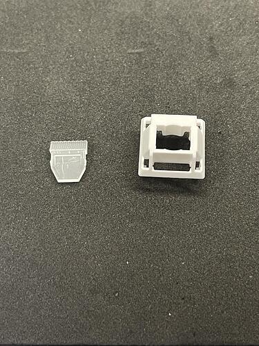

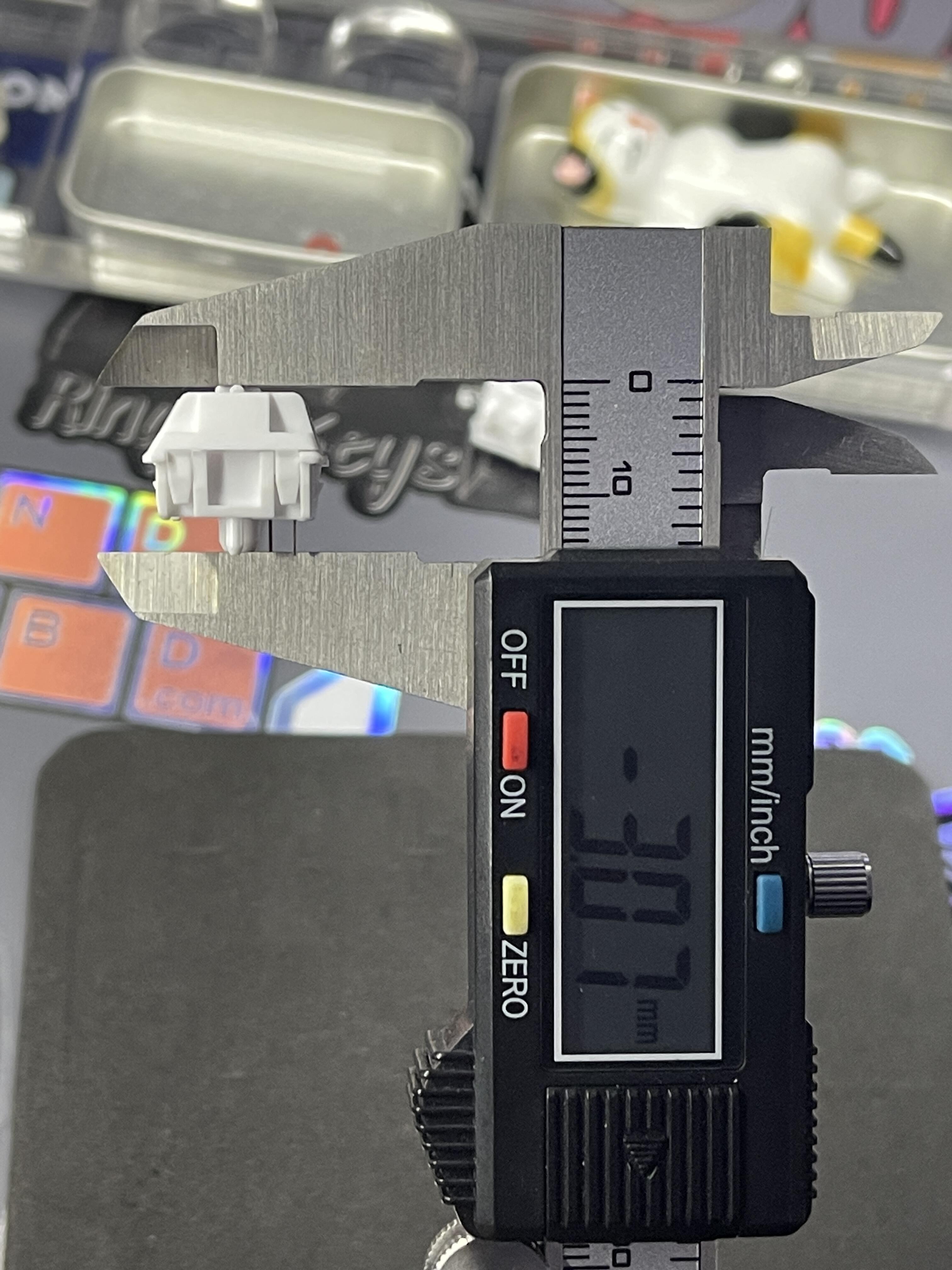

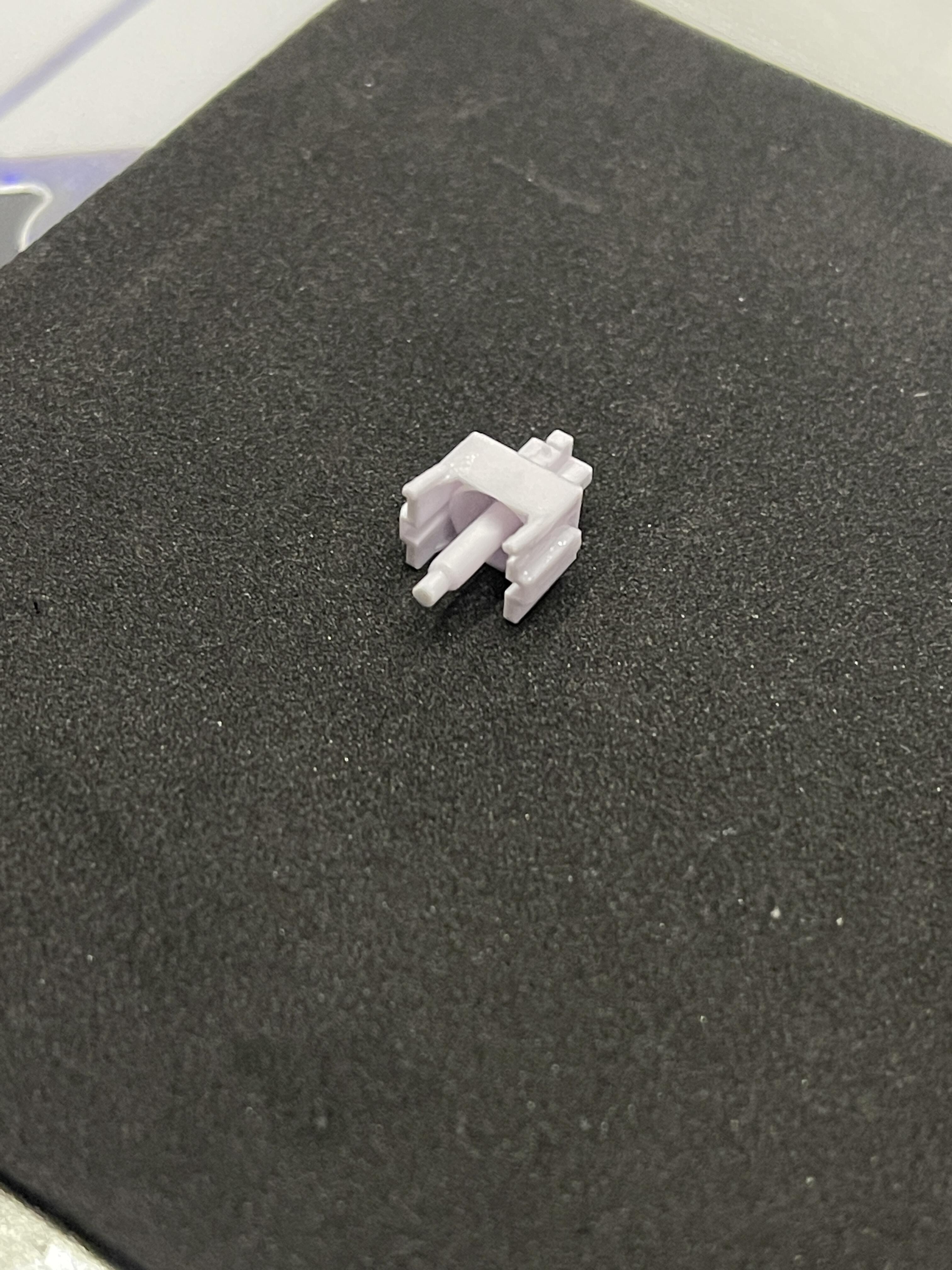

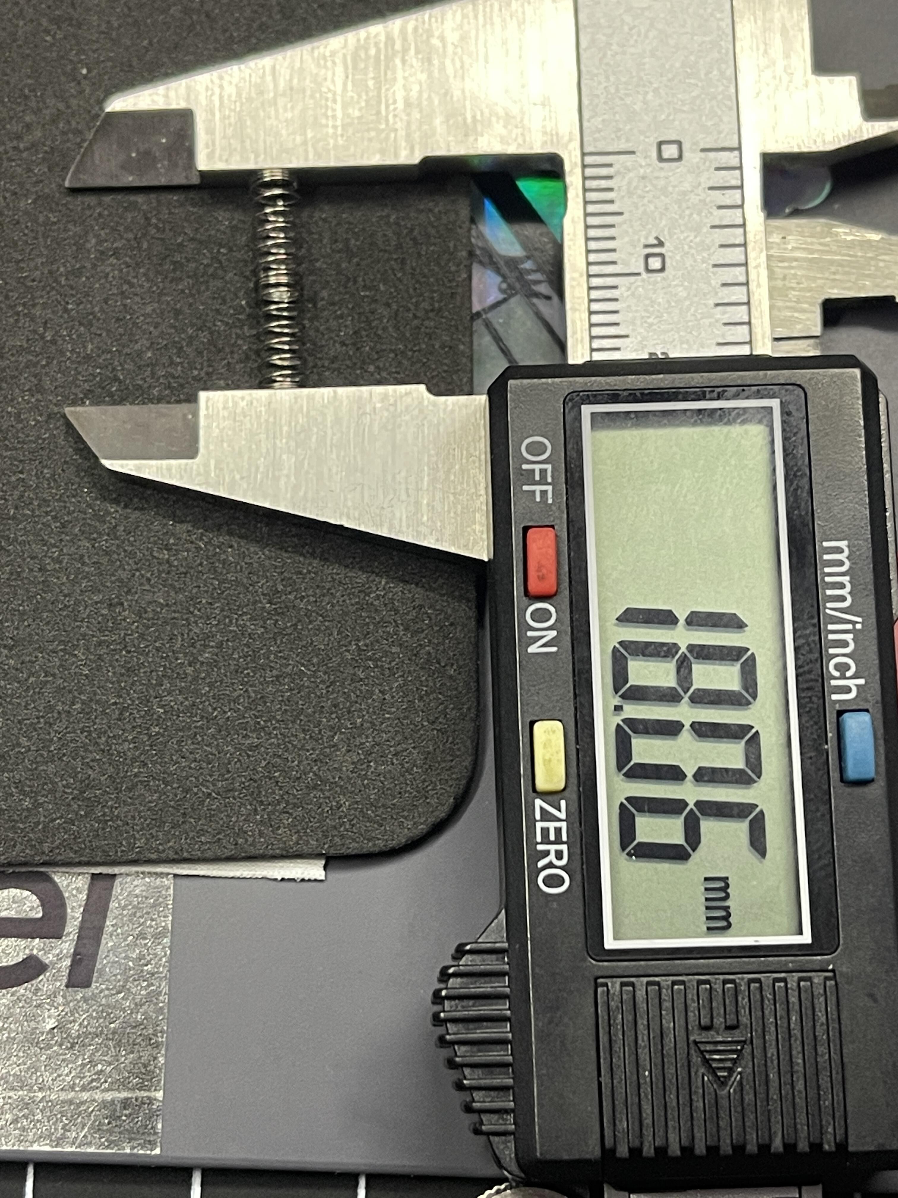

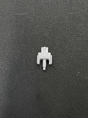

Here some pics I have snapped of one of the disassembled switches that show stem and spring length, and travel. Also, close-ups (or as close as I could get with my iPhone… :person_facepalming:) of the stem, housings, and diffuser. I also tried to show how minimal the stem wobble was with a pic in a neutral position, North/South, and East/West.
Stem
Spring
Travel
Housings
Bottom
Top & Diffuser
Stem Wobble
