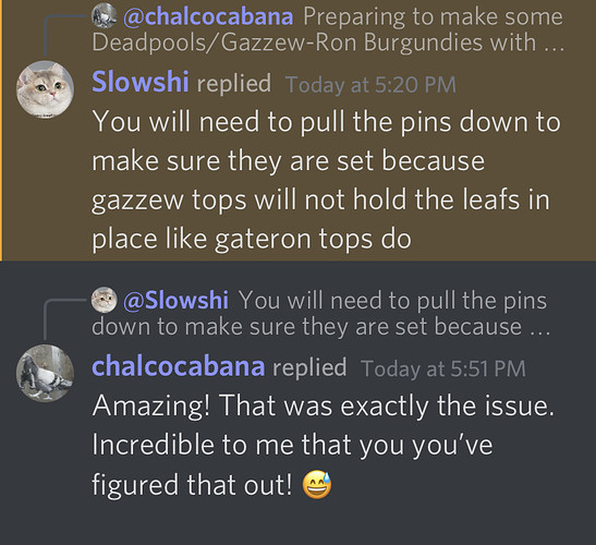

Preparing to make some Deadpools/Gazzew-Ron Burgundies with Kailh Pro Burgundies, Gazzew white tops and Gateron KS-3 bases. The two test switches I put together and lubed yesterday were actuating perfectly fine but today they are not actuating at all. I’m going to make some more to test but was just wondering if there was something simple I was missing?
Definitely odd that they worked yesterday and not today. I’d suggest systematically ruling-out potential causes;
  • verify that other switches do work in the same device and socket these switches are failing to work in
  • inspect the sockets themselves for contamination; dust, lube, etc.
  • test those sockets with tweezers if possible
  • try assembling a couple without lube and see how they behave (what type of lube?)
  • inspect the failing switches for potential issues; bent leaves inside, bent pins outside, maybe contamination
I appreciate the reply. The lube suggestion definitely seems like something that could fix the issue as I’m almost certain that I am a heavier handed luber than I need to be lol The sockets are fine thank goodness. That would have bummed me out even more lol
From slowshi on Discord (I’m promiscuous when asking questions I’m sorry). But the switches work perfectly fine now! I can’t believe people have figured this sort of thing out. That’s one of my favorite parts about all this tinkering.
In retrospect, that makes a lot of sense. Glad you got an answer! I’ll update the entries here and on my site with this information.

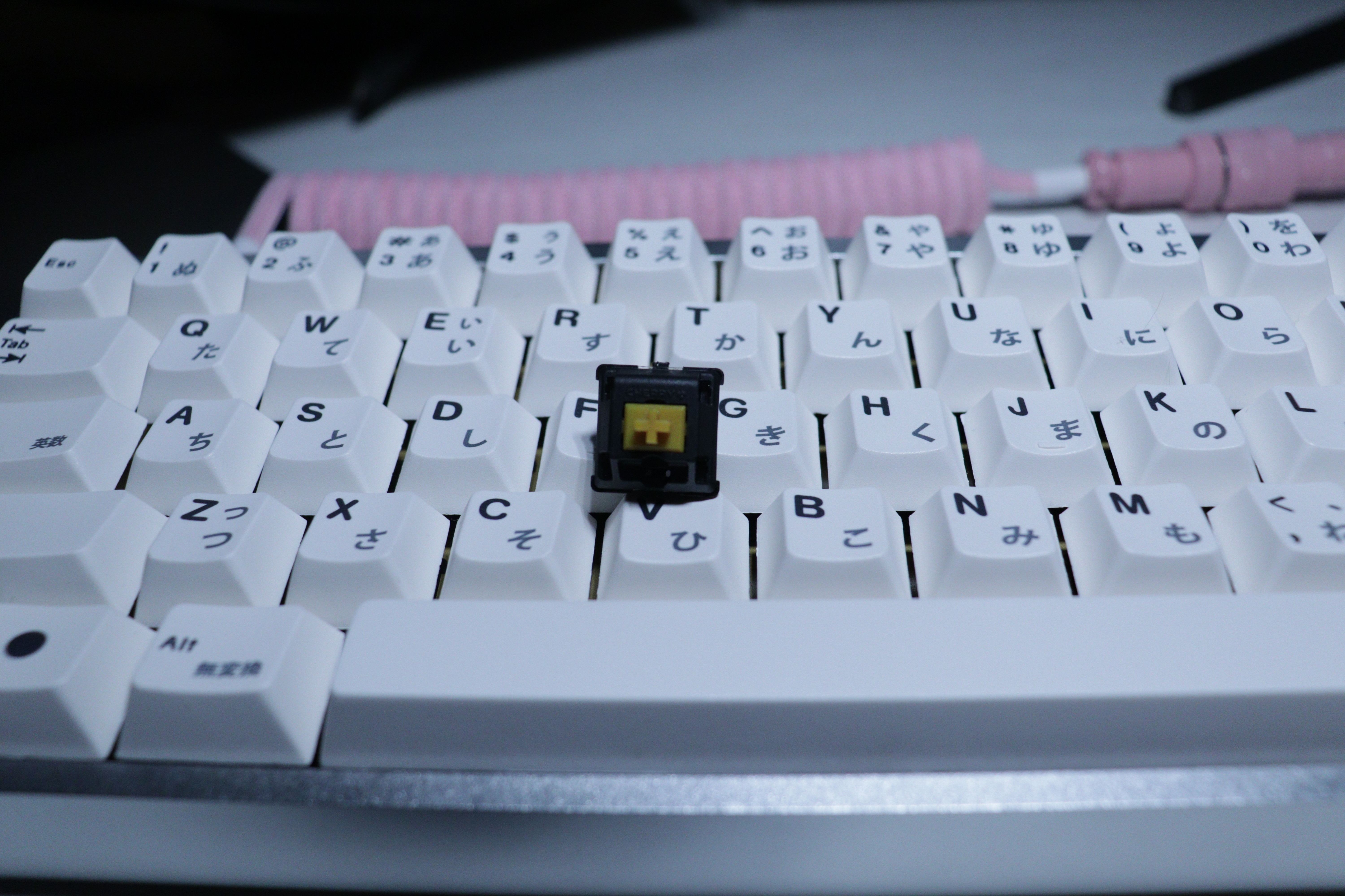

Hi Deadeye, since you experienced on Gat Ink Yellow, do you have any insight on its housing ? Any linear experimental recipe ?
So far, I’ve mostly tried tactile stems in it - but I’ve got some free time and a bowl of random switches on-hand - I’ll get back to you if I find anything worth trying.
Edit: @quartzi; I’d say most of the linear stems I have are better in their original housings or the improvement is so minor it’s not worth the money, like Frogs or Tangerines, for example - however, I did find two that I like better in the Ink Yellow housing than in their own:
  • YOK / BSUN Panda stems (you know, the ones people chuck after making Holy Pandas) make for a nice, low-wobble, normal-travel linear that actuates more or less normally. If you have Ink Yellows but don’t like the short travel, this might be an inexpensive way to ā€œnormalizeā€ them. These also look cool if you like black and yellow.
  • Cherry Silent stems sound and feel much better in Ink Yellow housings to me than in the Cherry Nylon-ish ones. If you have any of these wet-sand simulators around and don’t want to quite spend the dosh for Zeal housings to make MX Zilents, these might be a nice alternative. These also appear to have a more or less normal actuation.
I don’t yet have a device to measure it, but these appear to actuate at 2mm, or perhaps farther down. The Ink Yellow stems are a bit less versatile than the housings; most switches you put them in will actuate if you breathe on them too hard.
Incidentally, I also found that Bobagum housings are another great place to put Cherry Silent stems; they’re nice and snug with the tops without being too tight, and they trade a bit of silence for a bit more firm dampening compared to the Gazzew silent stems, if that’s your bag. Nice and smooth. There’s some E/W wobble but virtually none in the N/W direction, and they have a nice, soft feel and sound compared to the Ink housings with the same stem, for example.
