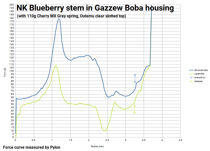

We have a new tactility king, with a 90-120gf tactile bump (seems to vary) - NK Blueberry stems in Gazzew Boba housings:
Sample 1 (made with a 110gf Cherry MX Grey spring)

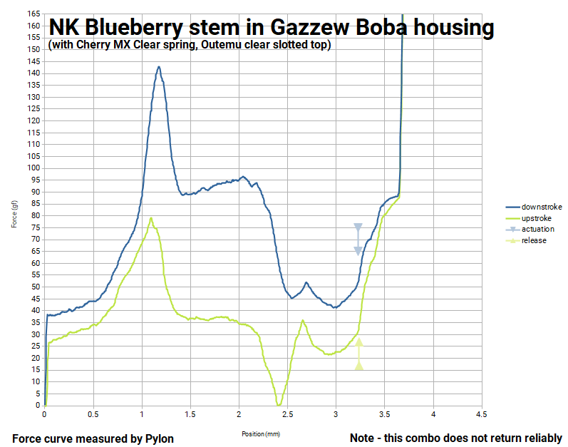

Sample 2 (made with a another Boba bottom, and a 90gf Cherry MX Clear spring - returned originally, but after disassembly and reassembly failed to return. The ā€œCopreā€ graph below was made with this one)
Note that this will likely kill the leaf from fatigue really quickly, since the size of the tactile bump is 3-4x the size on a Boba U4 (what it’s designed for), and the forces on the leaf are much higher as a result. Inconsistency and leaf damage are also pretty likely, as Sample #2 returned originally, but after taking it apart and reassembling it it no longer returned with the same spring, and the actuation moved down around 0.2mm than originally measured. That one also only had an ~90gf tactile bump compared to the ~120gf bump on sample 1.

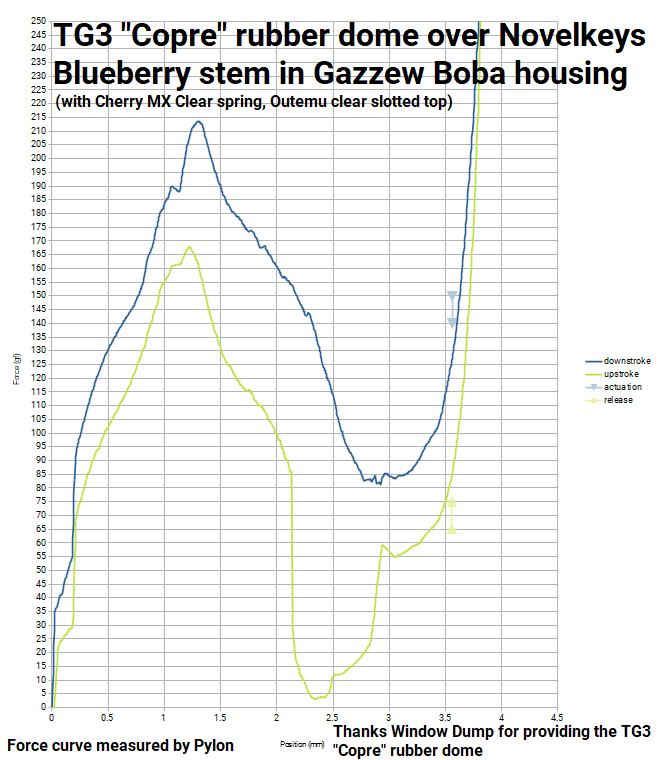

With a TG3 ā€œCopreā€ rubber dome over it, over Sample 2 (~130gf tactile bump)
