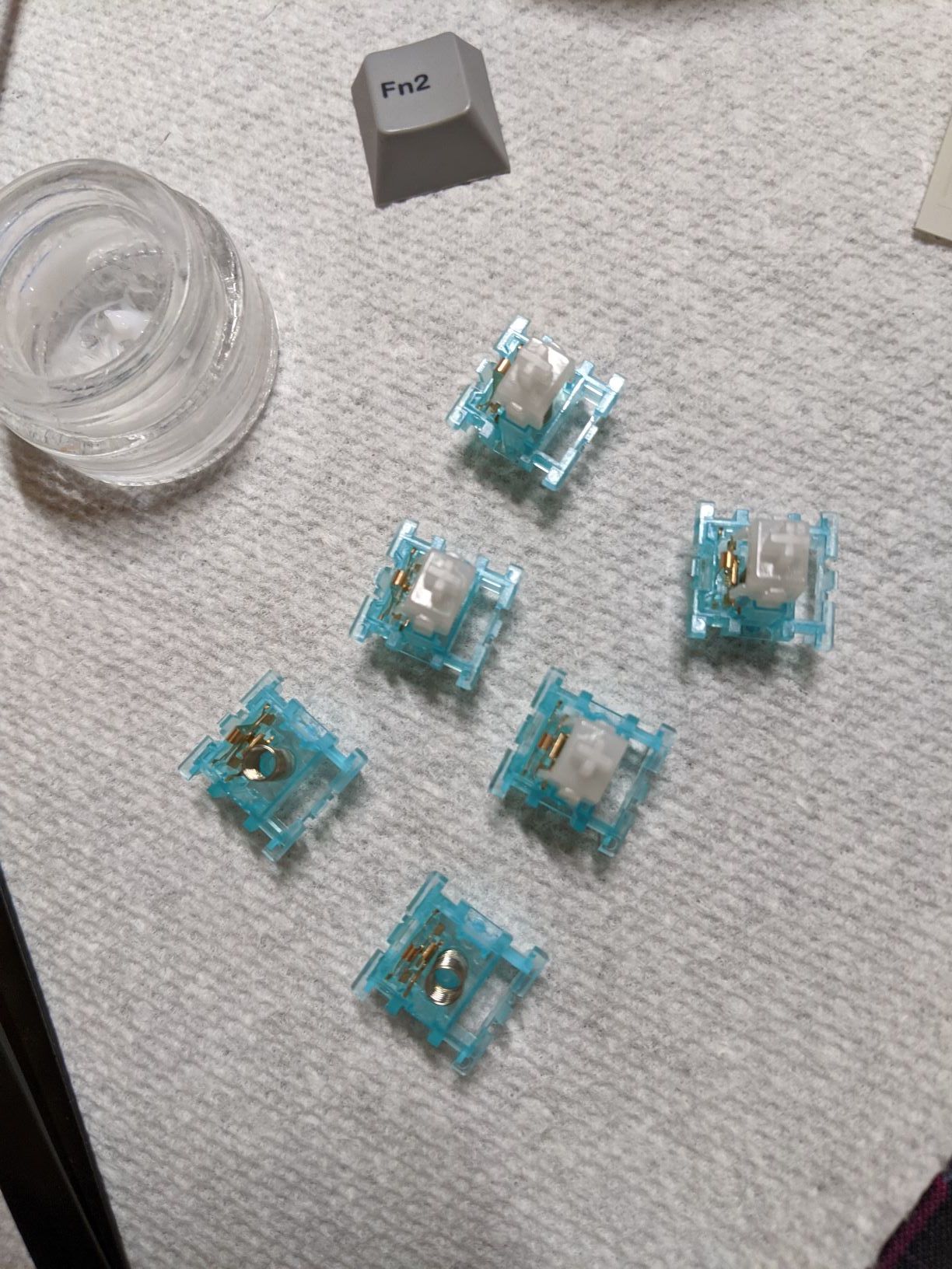

Just funkin’ around…
Edit:
Yep, still terrible
Ugh, I thought those would’ve been nice. Is the stem/housing super tight?
I thought so too! Alas - just scratchy. The quest to find a use for Cream housings continues…
