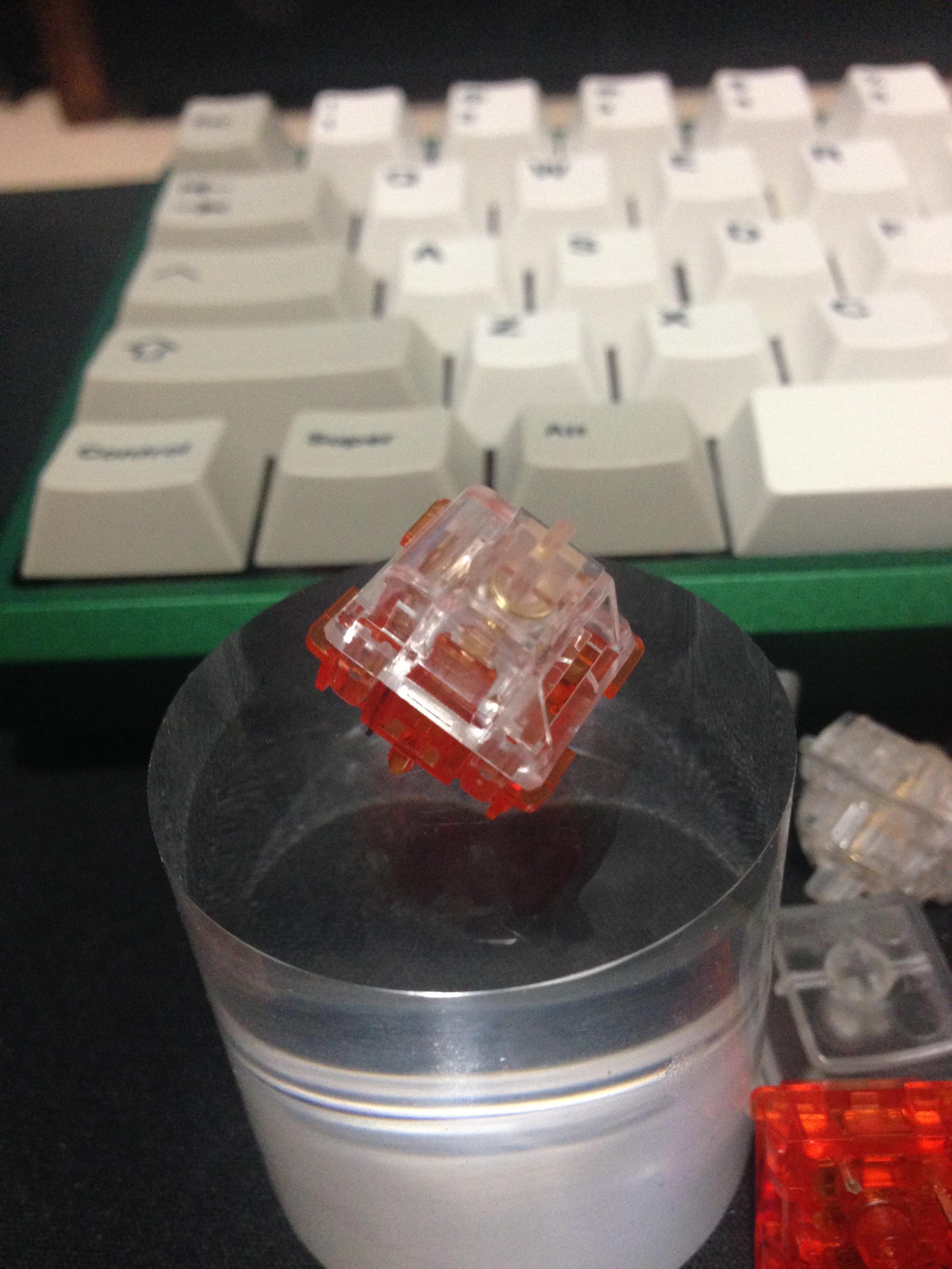

Sunset Switch
  • Tangerine bottom
  • Water King top (for now)
  • Water King stem (polycarb)
Haven’t got to lubing but they feel smoother than stock tangies. They sound and feel fuller too imo.
Will try Gat milky tops when they arrive :slight_smile:

I tried the stem with a bunch of tops and it didn’t work well with most of them - I think the only one it felt okay with besides its own was another Everglide top made of PBT - still, not as good as its own top.
I did learn something, though - the Water Kings in my batch that weren’t smooth appear to have over-sized stems, as they had an ever harder time fitting into other housings. (Like 1/3 of them) Either way, for the most part they would fit but be juust too tight, or not fit at all. It aalmost worked in a Hippo housing.
I think you’ve got the right idea swapping around the bottom for preferred characteristics while keeping the glassy smoothness of the top. I like the name - totally looks like that drink.
