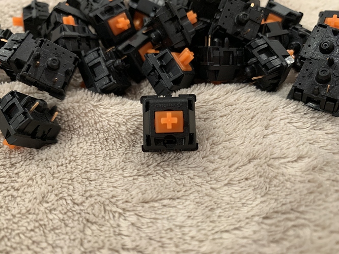

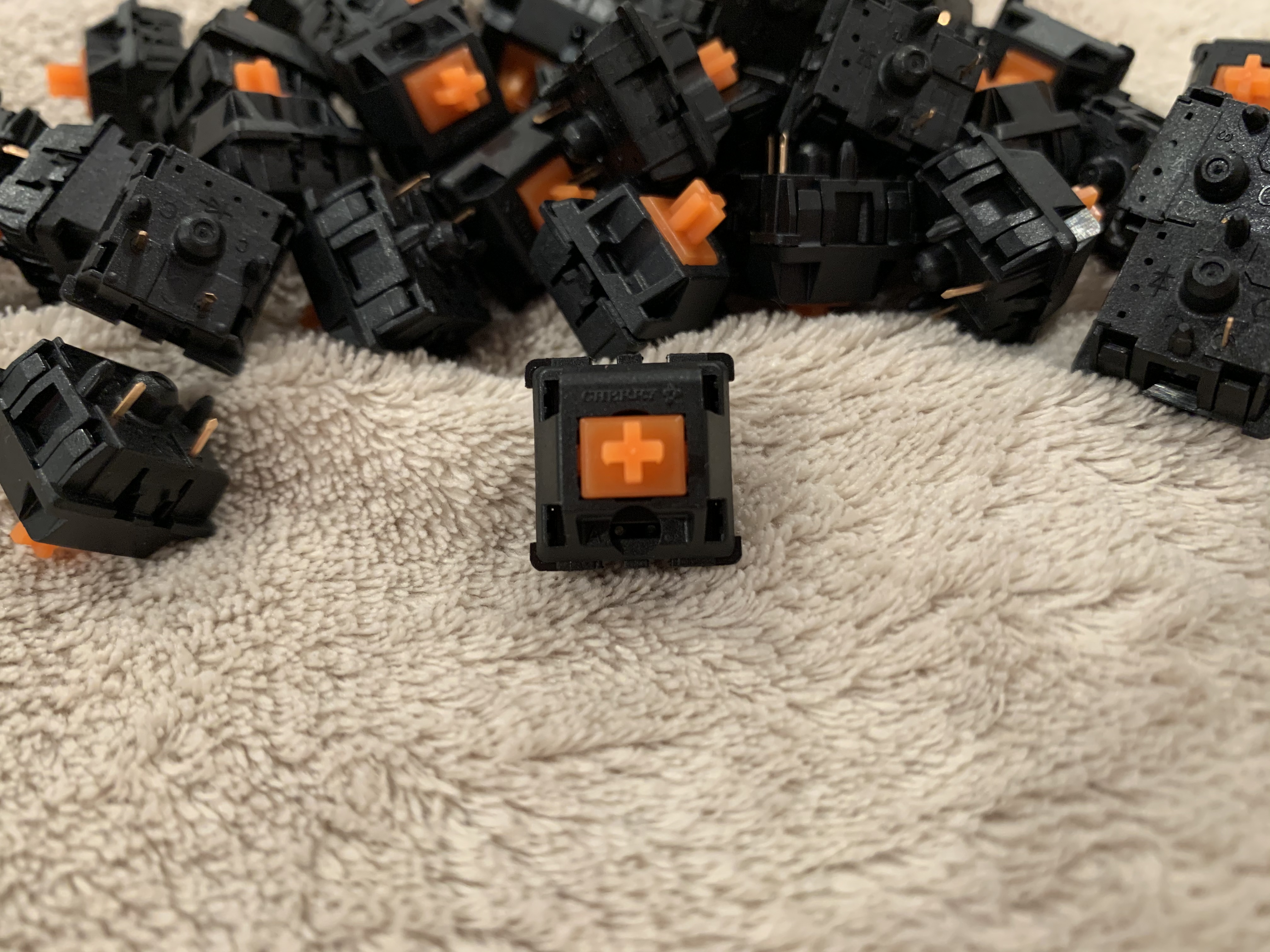

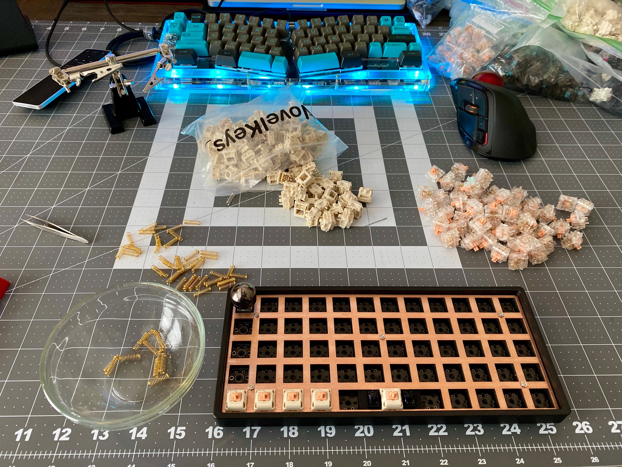

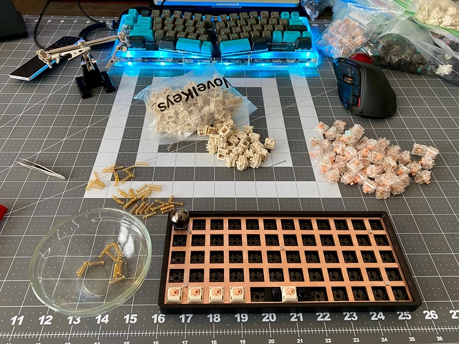

Stealirose Orange (Hirose Orange clones) are finished! No typing test yet but soon^TM. Here’s some pics.
Pile and Close-Up:
In their future natural habitat:
These bois are smoooooth, and other than the spring there’s no real difference compared to stock Tangerines Rev2. I have no reference to contrast them to the real thing, however if anyone would like to temporarily/permanently donate some Hirose Orange switches so that I could do a comparison I would not be opposed.

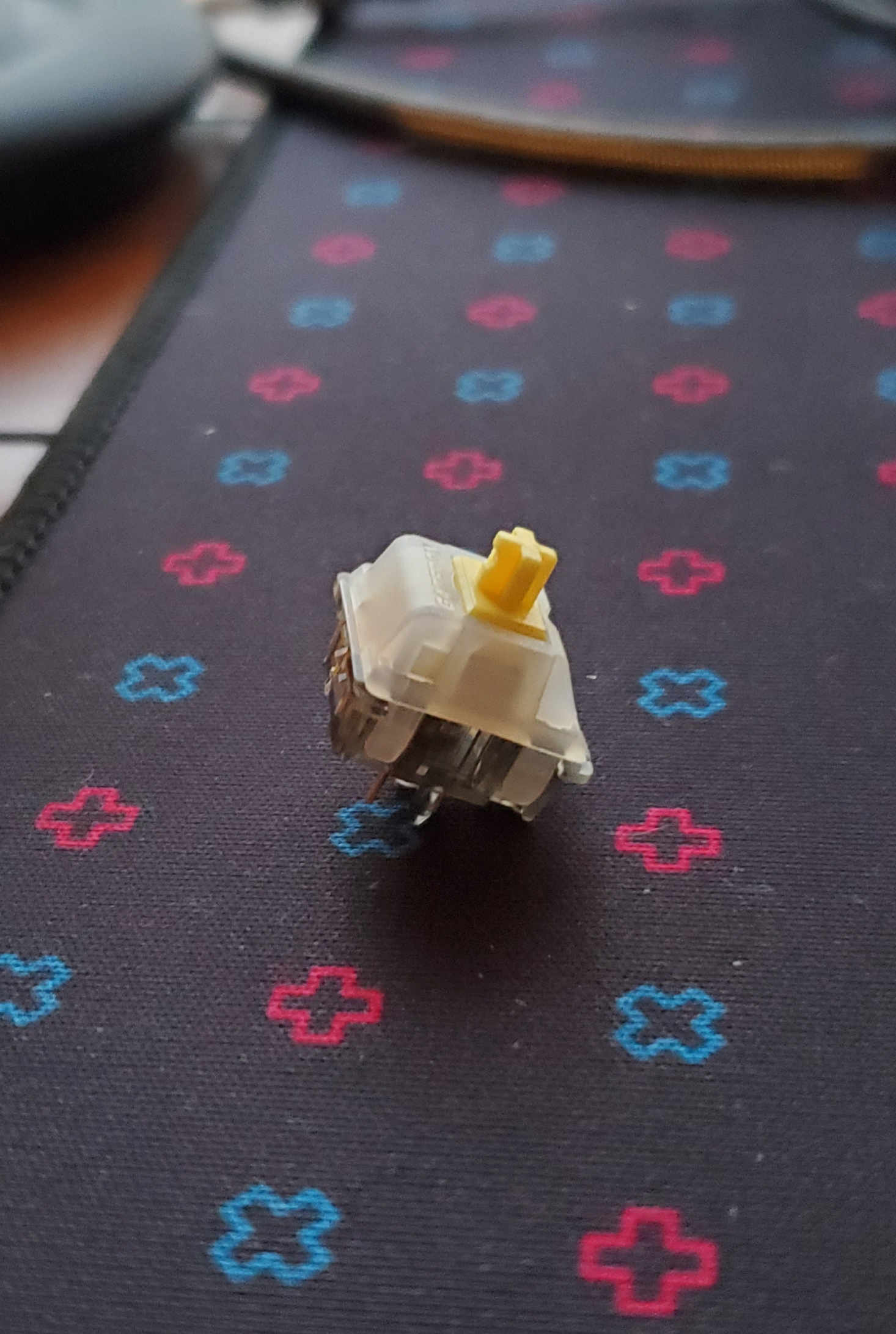

I had bought some Gat Yellows but for whatever reason, the pcb pegs are too large for any of the pcbs(too lazy to clip) I have on hand. Had some silent Alpacas lying around to try and thought why not mix the two together.
Switch is
  • Milky Top
  • Alpaca bottom
  • Gat Yellow Stem
  • filmed
  • 206g0 on stem, 104 oil on TX 80g springs.
I really like em! Feels good and has a very pleasant thock-ish sound on certain plates, currently using a Polypropylne one.
Sound test here(phone mic recording). Temporarily calling them Yellowjackets for the heck of it.
Another irritating thing about the Gateron milky tops, not sure if it’s an issue with different batches or not, but sometimes the part of the keycap that goes into the switch stem will catch on the edge of the top; luckily I had enough spares.
