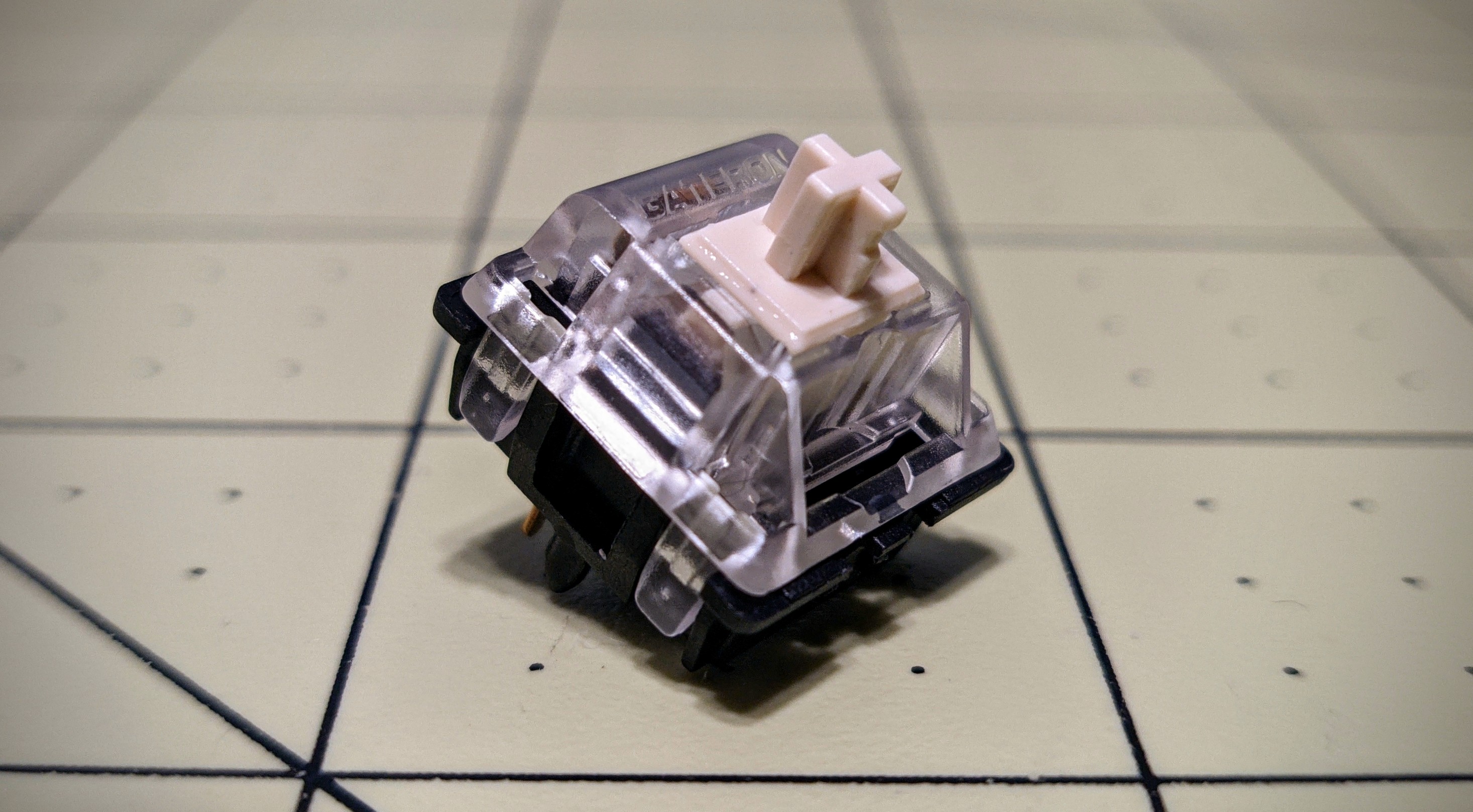

Funky Frankenswitches
T1NK
  • T1 stem, spring, and leaf
  • V1 Gateron Ink housing
  • Nearly identical to a T1, but…
  • More smooth
  • Less dry sound
More of an educational exercise than a suggestion.
Flavor-text:
I had the thought to do this just looking at the visual similarity between the smoky T1 and Ink housings, wondering how similar they really were. (I was also looking for the perfect switches to throw on the awesome Mountainblocks macro pad kit I just got in the mail…)
It turns out that, even though the housings look almost identical, they are not.
Gateron claims their proprietary plastic blend is the secret sauce to the Ink’s smoothness - and after this experiment I’m inclined to think they’re right. This combo genuinely gives Zealios a run for their money in terms of un-lubed smoothness.
A note of trivia - this mod is easier with the V1 Inks, as their leaves are extra loose and easy to remove. As far as I know, tightening the housing’s grip on the leaf is the only change from V1 to V2.

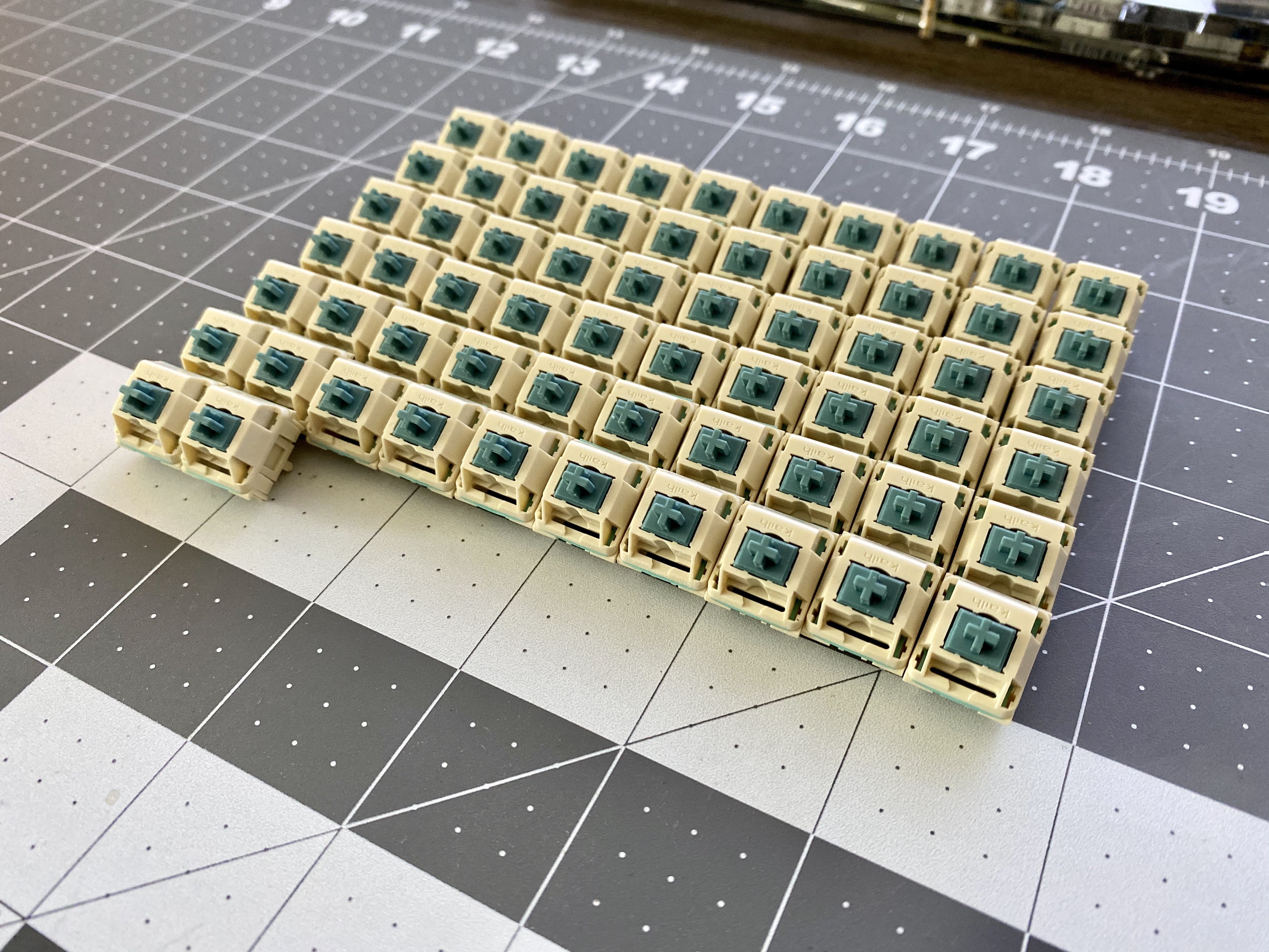

Putting together some temp switches for the new board, until the HP switches arrive. Housing is NK Cream, stem and spring from a T1, sliders lubed with 205g0, spring is lubed with Hoppes No9 oil, and teal switch film.
Edit: That took way too long lol
Looking good.

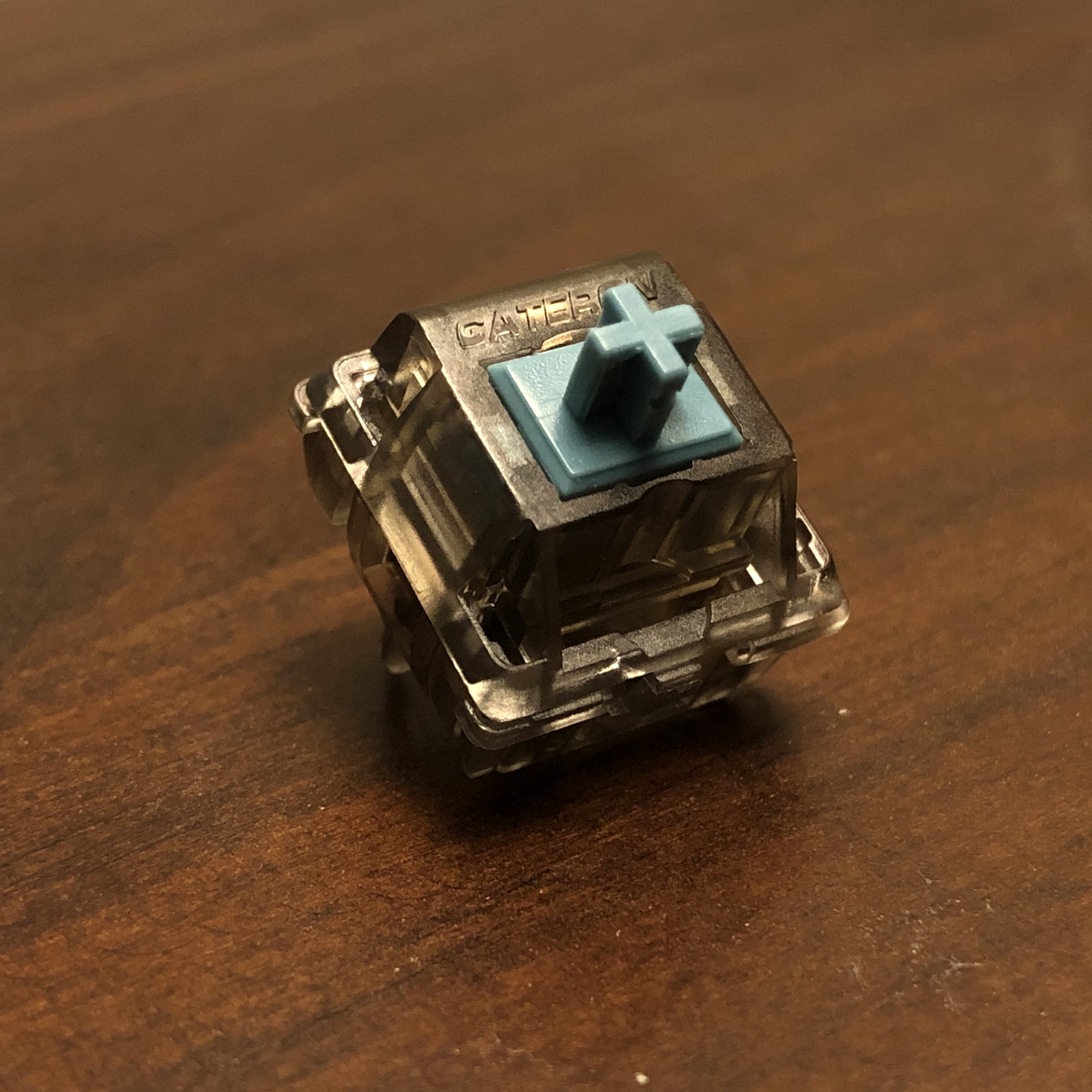

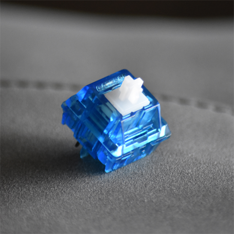

Heisenberg
  • Halo Clear stem
  • Gateron Blue Ink housing & spring
  • Very smooth, “tight” feel - no or very little rattle
  • Modest, yet crisp and satisfying tactility
  • “D-shaped” bump starting at very top
  • Is the danger
Short, snappy tactile with a harsh, loud bottom-out; the one who knocks.
Flavor-text:
I tend to fidget with my switch testers when I watch stuff. While clacking away on Creams, Inks, Creamy Inks, T1’s, and Holy Pandas, I had the thought to put a Halo stem into an Ink housing since the Cream and T1 stems do so well in them. Once again, I was pleasantly surprised by the result;
TL;DR: These crystalline wonders basically feel like extra-smooth, shortened T1’s.
That is, with a shorter travel because of the Halo stem, but with a similar smooth bump that encompasses most of the travel. Very satisfying.
This is definitely a switch meant to be bottomed-out; the bump essentially ends right as the stem hits the housing, giving for a very clean, snappy feel.
The sound and feel from that bottom-out is a little less distinct than that of a Holy Panda, also a bit less loud and piercing, as if the plastic is less dry, or more dense - I actually prefer this sound.
I’ve got to hand it to Gateron - they’ve got some good secret sauce in those Ink housings. I’d order a bucket of them if I could.
For its short travel, the bump is wide and smooth - very clear and noticeable, yet much more subtle than the Box silent browns I’m typing on now (which themselves are much more snappy than other “browns”).
I bought a bunch of Panda housings a while back, but damn if Ink housings aren’t way better in terms of what I want in a switch. I’m pretty sure my planned Holy Panda build just turned into a Heisenberg build. Well. At least the pandas are pretty…
Conclusion: Revising my recommendation for those that like an extra snappy, smooth “d-shaped” tactile bump. It’s not necessarily heavy like the bump on a Box Royal, but since it all but demands a hard bottom-out, they can be a little tiring - I suppose that’s the price of admission for what is to me still the most fun switch in my collection.
