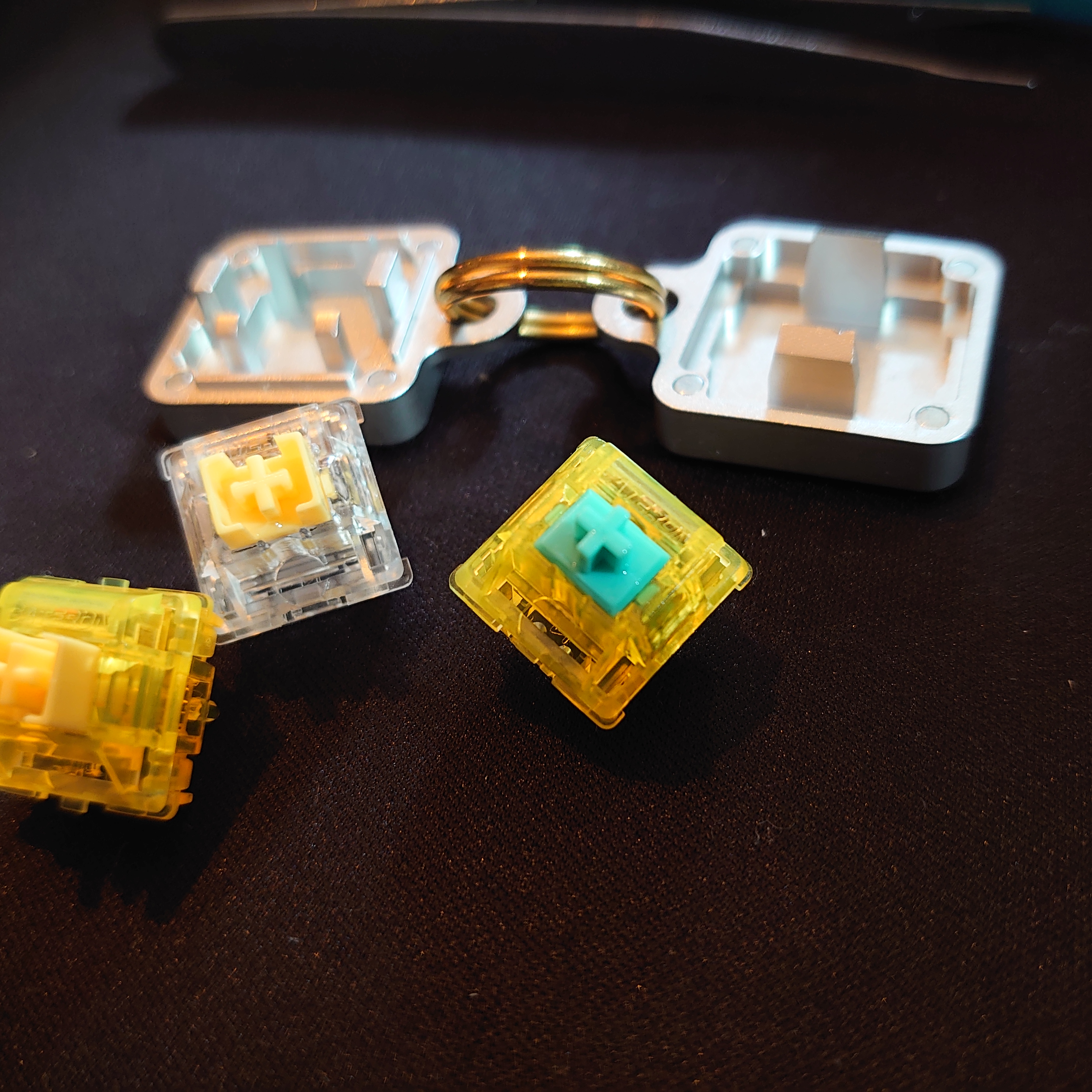

The Cream steams on the Gat Yellow house, using the Gat yellows spring all lubed up with 205g0 is a solidly smooth switch. And I’ll definitely report back on the Creams with the INVRY stems.
I switched some switches while lubing and the Tiffany Ink is surprisingly smooth and quiet! :ok_hand::exploding_head::+1:

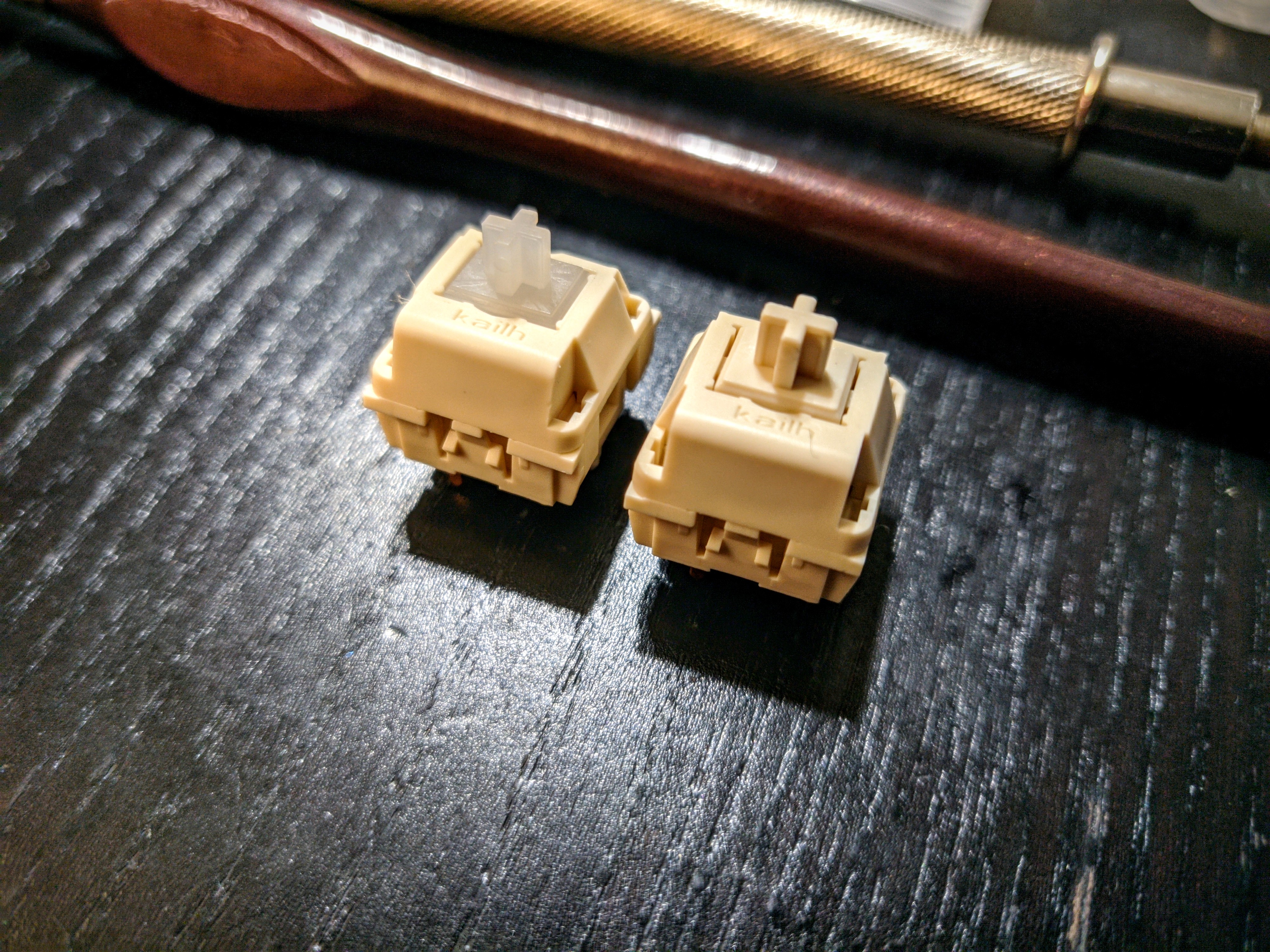

I have a bunch of leftover old Cherry Blue Switches (of the pre-1994 light blue variety). Does anyone have experience with these switches?
If so, is there a modern Prokeytheus out there with suggestions for what stems might work well and bring new life to these housings?
Cream with INVRY stems, spring swapped to 60g gold Durock springs, and lubed with 205g0 is smooth boi status. Building my Quefrency with them tonight.
