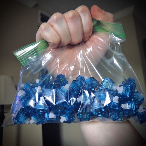

Hopping on this thread now as I start to mess around with Halo True housings, any notable leads on something new?
I’ve been doing a lot of wacky things trying to mess around - even have almost 300 unholy panda parts on the way to me from someone on discord.
One interesting thing (that might be heinous) is that I took a halo true spring and snipped off the top part where it coils tightly together - I realize this shortens the travel but it also changes the weighting of the switch…I wonder if a longer pole would compensate for the reduced travel distance.
If anyone feels like brainstorming ideas hit me up!

Hey, kid…
ooh nice! I can just barely see the cartoon-esque halo lighting around the bag :joy:
