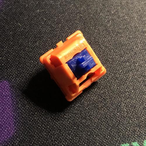

Bling Kangaroo (or just A Gateron Kangaroo stem in a Tecsee Diamond)
The only reason why I wanted to post this because of how weird it feels:
  • Starts linear
  • Begins to stiffen up kinda like a tactile
  • Bottoms out with no bump (dafaq?)
  • Top out has a tactile bump really close to top…
It honestly feels like nothing I’ve ever tried and can’t really describe it better than that. In analogy terms, you walk in a linear line, and someone named bump tries to break your ankles but fails. When you let your guard down, Bump actually pulls a Knee-Flopper 360 on you. Also, you’re in a school that’s named Blingy Kangaroo Elementry :wink:
Zeal, your 3 in 1 design has a competitor…
Have you tried it in a keeb? Ink Kangaroo/Ink Yellow and Pink Box Ink have a tendency to activate after 0.1mm when put in a regular housing.
Actually, it feels like its actuating at the same level… Dunno if that’s the Tecsee Diamond or the stem

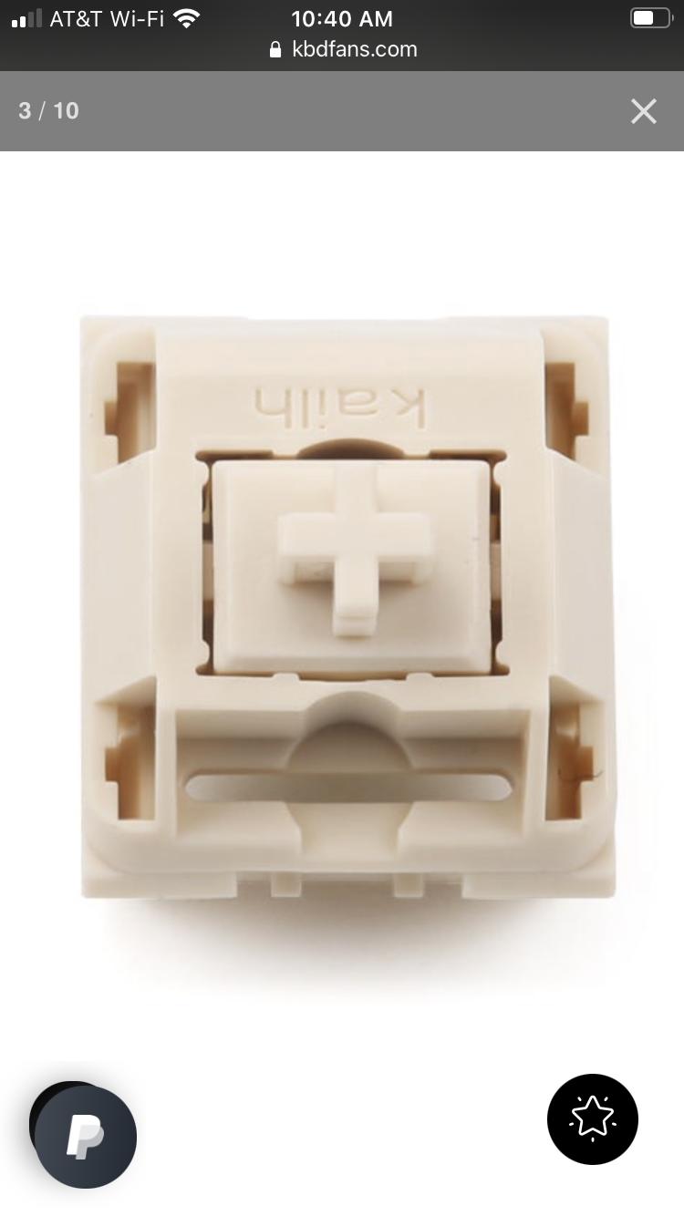

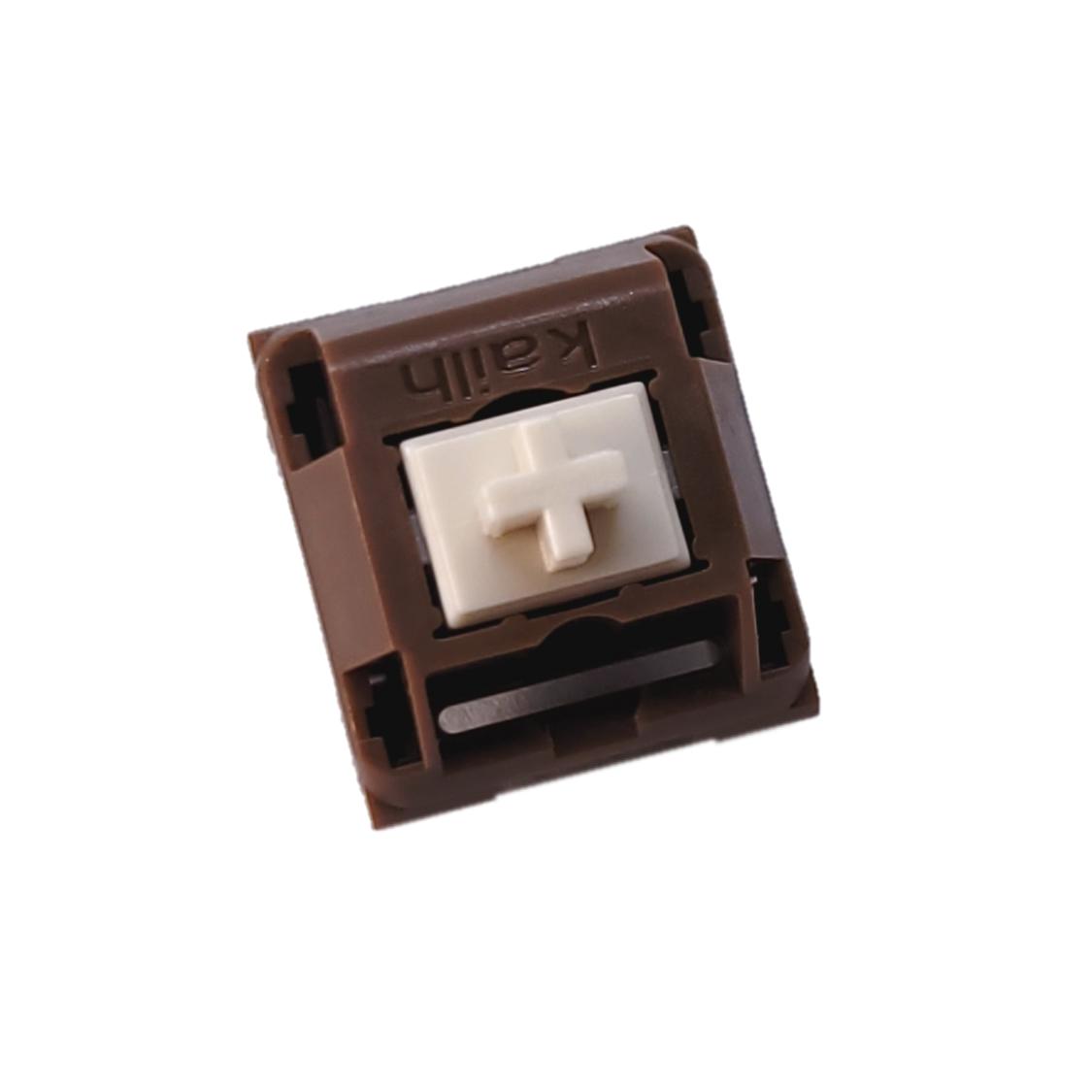

New Creams have a larger Kailh logo. Ignoring the color, here’s a comparison between the two molds:
V1 Cream:
Notice how the edge of the “K” is roughly in-line with that little rail / nub against the stem.
V2 Cream (chocolate colorway):
Larger logo, “K” no longer in-line with the rail / nub.
