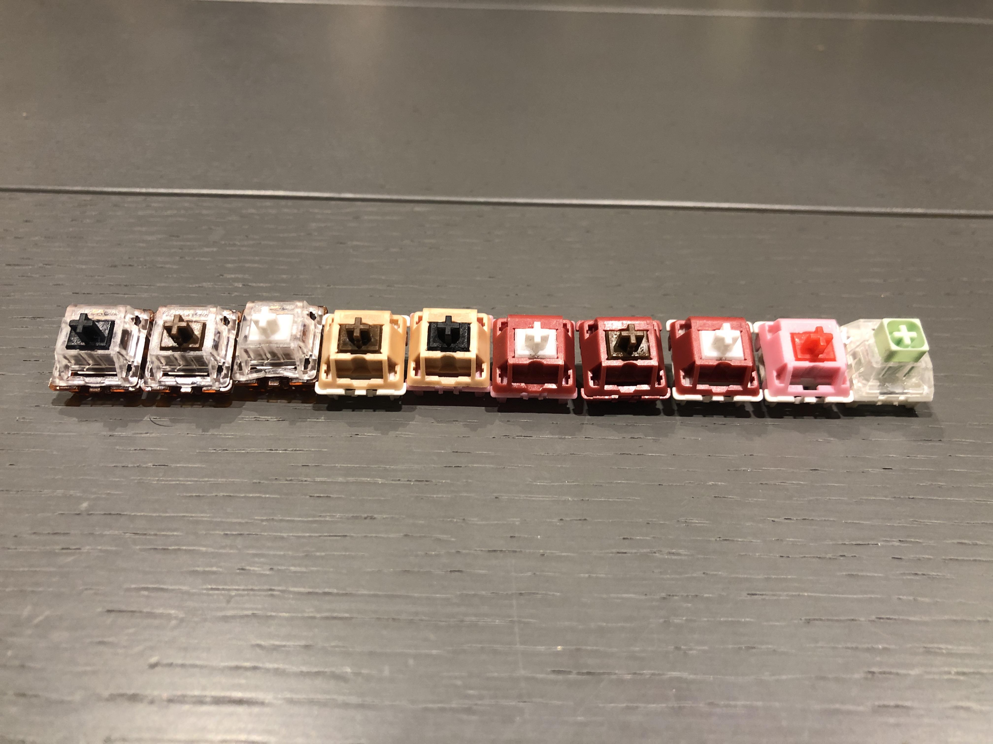

Ok so, here comes the specs and reviews, this might be a long one.
All switches lubed with 205g0 since I had no tribosys on hand.
Clear topped t1 (far left)
Dark amber t1 bottom
Clear gat top
t1 stem
t1 spring.
This switch is probably one of my least favourite out of the lot. It’s a high-ish tactile when lubed, sharp bump and feels a little unrefined even after lubing the legs. It’s smooth, but like average smooth, not everglide aqua king smooth. the sound signature is my biggest gripe with it, while it is deep it sounds thin and muted, and the spring has a little crunch to it. 6/10
edit: after using it for a bit it seems a bit better now, the bump less unrefined, and the sound better. 8/10 now
Amber bottomed brown. (2nd from left)
dark amber t1 bottom
clear gat top
coffee chip ice cream stem
gat red spring.
This is one my favourite switches out of the lot. It has a classic “thocky”, kind of marble like sound signature. It is a high tactility switch after being lubed, and the bump is rounded and feels smooth in a way. Pretty smooth, even as linears go. 9/10.
Amber bottomed clear (linear tho.)(3rd from left)
gat clear top
aeboard raed stem
aeboard raed spring.
This is a very nice linear. It is pretty smooth, but not gliding like some switches do. The sound is essentially a less clacky aeboard raed, the type of sound you’d hear from those “yes, but does your keyboard thock like this” its a clean sound though. 9/10
Gat bottomed coffee chip. (4th from left)
Gat white bottom
Coffee chip top
coffee chip stem
coffee chip spring
coffee chip spring
This is a pretty nice tactile frankenswitch. Sounds like a lot of thocky frankenswitches, reminds me of a boba u4t, not as thocky as some of the other switches on this list, although a bit unoriginal. the tactility is medium when lubed, and quite rounded. not as smooth as some on this list, but still smooth. a solid 7.5/10
strawberry coffee (5th from left).
bobagum bottom
coffee chip top
t1 stem
t1 spring.
I don’t like this switch at all. The tactility is medium-ish, and more rounded than the clear topped t1, but less rounded than any of the switches with coffee chip stems. The sound is very muted, allowing the spring noise to come through and ruin it. Not that smooth either. Shame it has one of the few good names. 5/10
Strawberry raed. (5th from right)
bobagum bottom
aeboard raed top
aeboard raed stem
bobagum spring
This is an ok switch. It’s what i’d expect from a $0.20/switch switch, not the $1.5 dollar switch this adds up to. Spring noise is a bit much, kind of deep sound signature, although the top out is very thin. It is pretty smooth though. Honestly at this price just get yourself some BCPs. 5/10 cos of the price.
Now at this point i forgot to review the switch next in line in picture (red housing with brown stem) and did a different switch instead. glad i did tho because this is a pretty nice switch.
Milky coffee.
coffee chip bottom
coffee chip top
aeboard raed stem
coffee chip spring.
I like this switch. Unlike the other switches on this list, the top out is much more audible and pretty nice sounding. I’d say it is on the higher pitched, clackier side in terms of sound signature, a bit deeper than c3 tangies. Very smooth, almost just gliding up and down. 8.5/10
White bottomed raed.
Gat white bottom
aeboard raed top
aeboard raed stem
gat red spring
Another thocky linear switch. not marbly, just a solid, deep sound that i quite like. Not as smooth as the other linears mentioned, i’d put it at gat milky yellow levels of smoothness. I personally prefer different sound signatures, but i know some people will like this switch. 8/10
Strawberry cheesecake
gat white bottom
bobagum top
gat red stem
bobagum spring
One of the higher pitched switches on this list (not saying much since it is still kinda deep sounding), with a small touch of clack. Spring needs improvement, it makes a bit more sound than i would like it to. About as smooth as a gat yellow. 7/10
Now we have the weird one. It’s just a kailh box jade without the clickbar. as an alpha, even when lubed it sounds a touch unrefined, but it goes best with two stabilisers either side of it, giving a sharp return and a satifying top out sound. Pretty thocky (solid deep) sound as well. 8.5/10
Now that is it for my list. My personal favourite is the amber bottomed brown, favourite tactile switch to date. With most of the linears excluding the amber bottomed clear and the linear box jade i would say you should just go get some aeboard raeds, over lube them a bit, add a touch of foam to your case and you get a beautiful deep, marbly, a little clacky sound. only downside is that it is a 3 pin switch.
