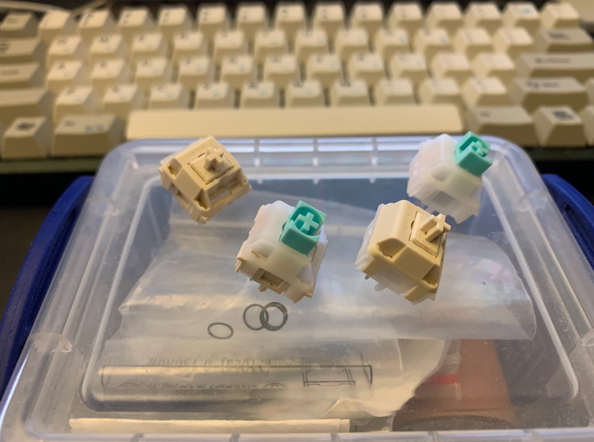

I take my brush and put it inbetween where the two leafs hit to cause the actuation, usually with 205 and a decent amount. Have never fpund chattering from it and have done it on many tactiles that I have daily driven and never any actuation issues, however I think Ive always used jwk bottoms so maybe try on a few before doing a whole batch if u plan too.
Mint Cream = FLCMMK Ice Mint + NK Cream bottom housing.
I found Ice Mint underwhelming in use. It felt scratchy like how polished Cherry Black can feel scratchy when stem hole in the bottom housing is not properly cleaned. To confirm my suspicion, I swapped the bottom housing with that of NK Cream. Sure enough, resulting combo felt smooth.
Calling this frankenswitch: Mint Cream. Itās likely the name has been used already but this will have to do for now.
Sound: Itās sound still remained muffled but at least not as much as before. I do prefer loud sharp clack sound of NK Cream but this sounds pretty distinct and somewhat enjoyable.
Ice Cream is what Iām calling the combo made out of the remainder. Despite Creamās long stem, key travel of this combo didnāt feel short. And, surprisingly, it didnāt feel as scratchy as Ice Mint. I suspect Ice Mintās scratchy spot is near the bottom of the stem hole. If true, it maybe the cylinder like shape of Ice Mint stem is trough the scratchy part of the stem hole wall while NK Creamās narrow end of its long tip is less likely to hit the walls. Sound is very similar to Mint Cream.
In Use: Iām now using a 60% hotswap filled with Mint Cream frankenswitches shown in the background of above photo. It sounds distinct and feels nice enough to recommend others to try this combo.

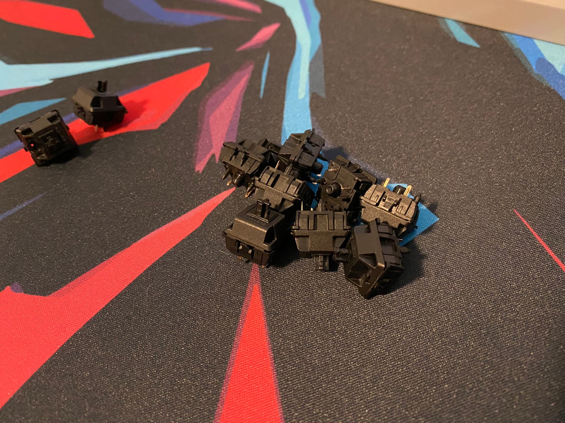

These simple but exceedingly frustrating combinations. Simple enough in theory: Cherry Hyperglide housing and a Black Ink stem. I built one and liked the combination so I decided to build a batch. As you can see, I built 10 and then decided to call it quits. About every 3rd switch I built I ran into this strange issue where towards the bottom of the press Iād get this odd tactile feedback. Not something Iād call a bump but it feels more like the stem legs reaching their end and the leaf hitting where the legs meet the body of the stem.
I think it was one of those things where I had to build a few to really find out. Frustrating nonetheless but Iāll keep iterating on it.

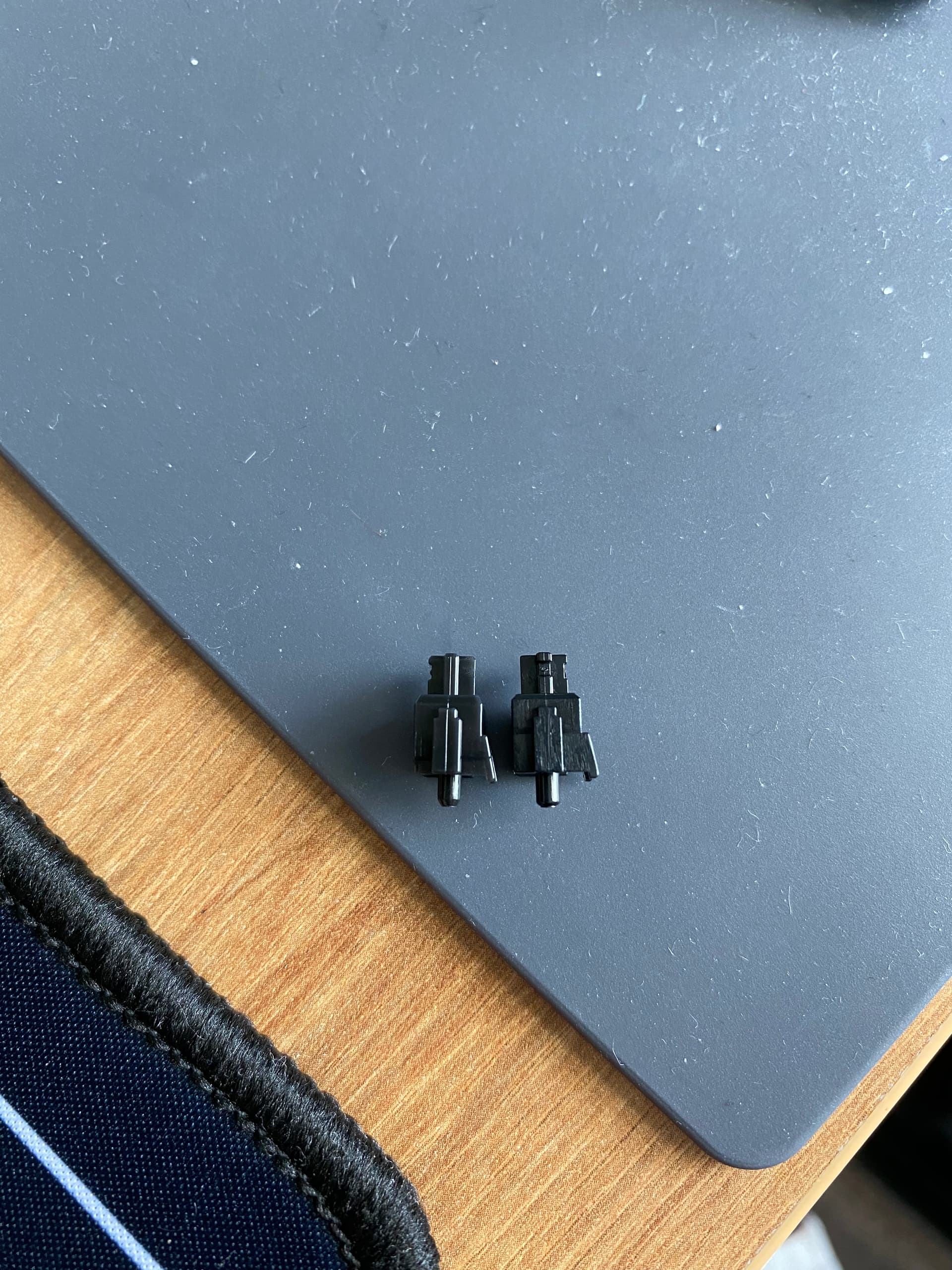

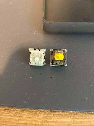

Do you see any different if you put the stems next to each other?
The only substantial difference I see is on the side. Cherry on the left, Gateron on the right. On the side of the stem the lip is much higher on the Gateron but Iām not sure if this is a contributing factor. The shoulder bevel is also slightly larger on the Cherry stem but again, Iām not sure if itās a meaningful difference.
They look very different to my eyes. Look at the width of the stem body. One on the right is thicker than the other. Angle of the legs look similar but legs of the right stem would be positioned closer to the contact leaves.

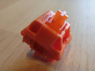

Housing and leaf: Tecsee Carrot
Stem: Healios
Spring: TX long, 80g
Inpired by the āfruitā-naming scheme, I call it: Whispering Dekopon.
Dekopon, because itās looks really reminds me of Dekopons, and because Dekopons are bigger, heavier citrus fruits (heavier Tangerines, heavier spring
Well, and āwhisperingā because itās silent ![]()
I had a bag of Healios stems lying around, harvested from switches with damaged housings.
I tried them in different housings, but in almost every housing (Nylon, PC, UHMWPE) they showed the known āstickynessā which is quite common for Gateron-made silent stems.
The only exceptions were Canacary-housings (POM) and even better Carrot-housings (PME)

how do they sound and feel?
I have not yet tested them in an actual build, but I will soon.
So itās hard to tell exactly how theyāll sound. The switch just resting on a wooden table, Iād call the sound a very dubdued clack.
The switch feels very smooth, soft even, already before lubing.

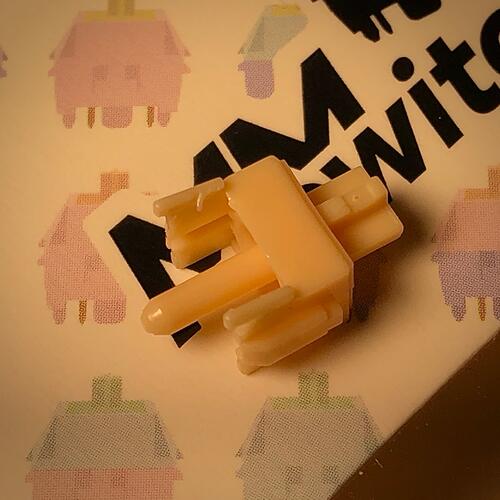

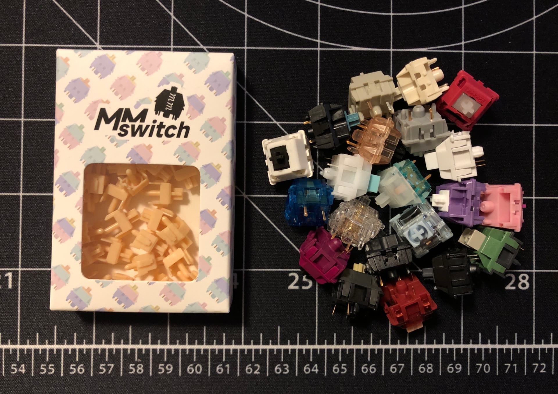

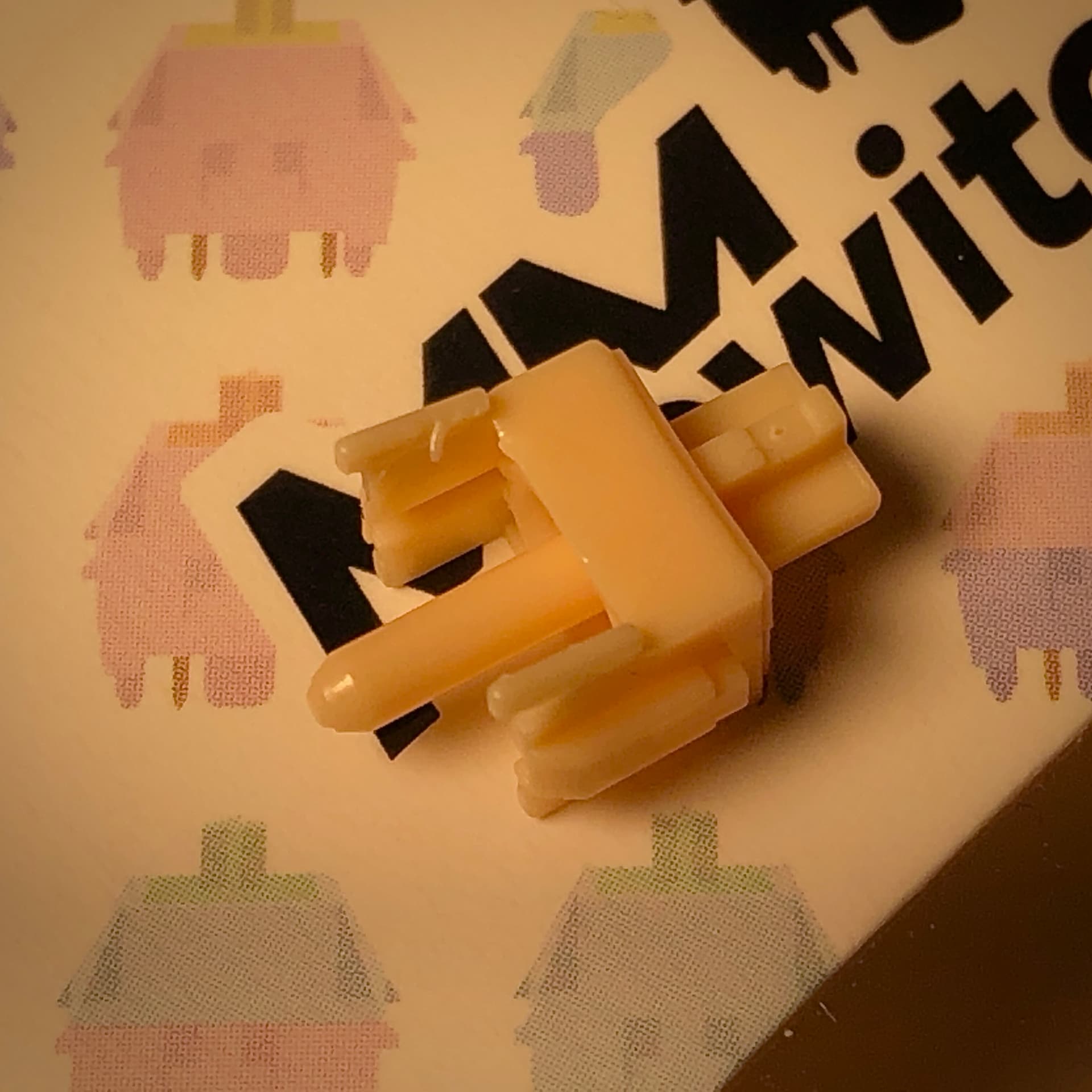

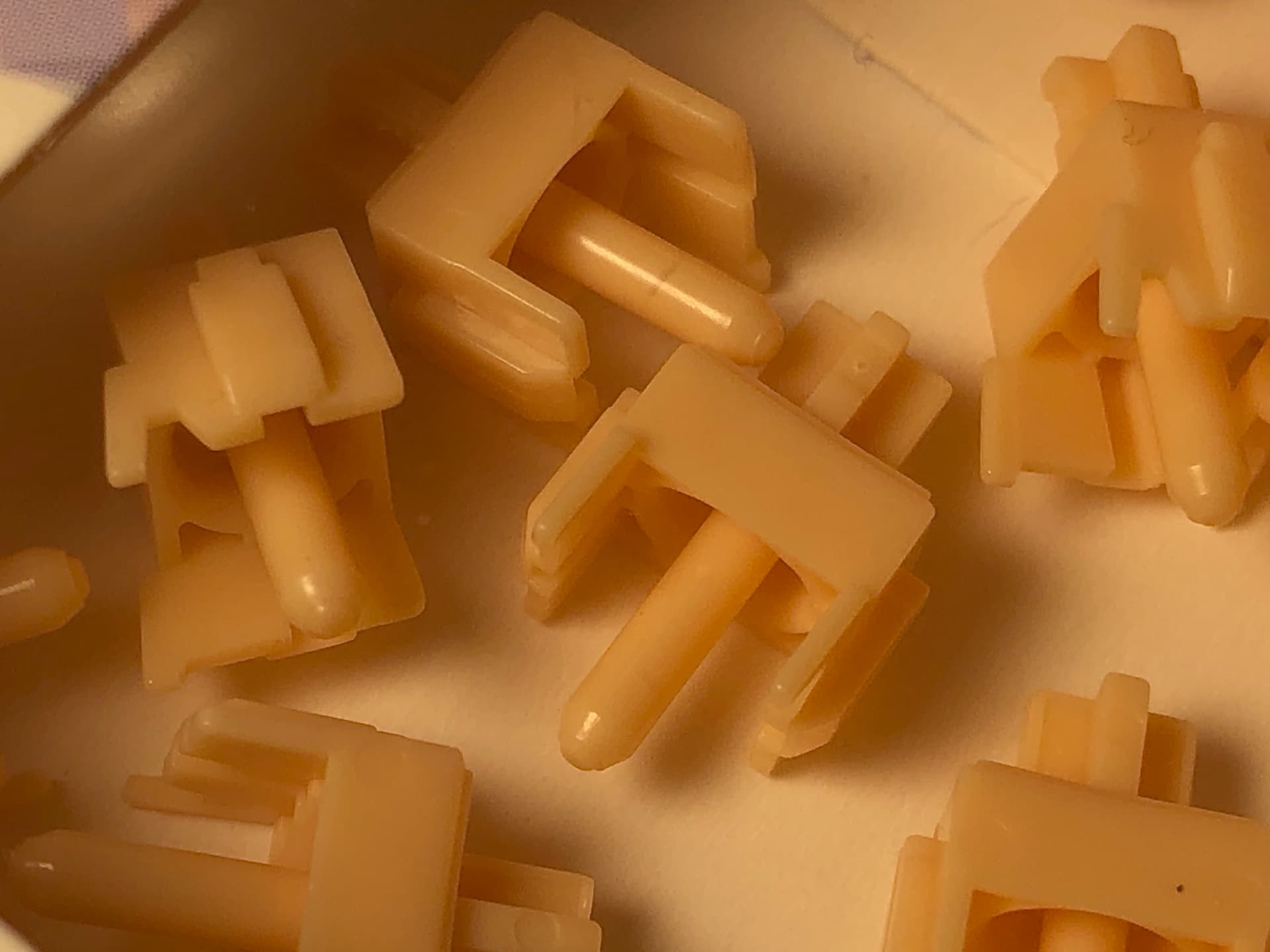

Trying JWK P3 stems from Wuqueās Mix & Match series in a bunch of different housings today.
Most of these look good with clean details, though I did find a derpy one:
The stem feels at least decent in all these, great in a few:
It wonāt clear the tight Gazzew top, but it will work with his slightly less tight Outemu branded housings, so I stuck a Cherry silent stem in that one.
Iāll get back with you on the good ones.

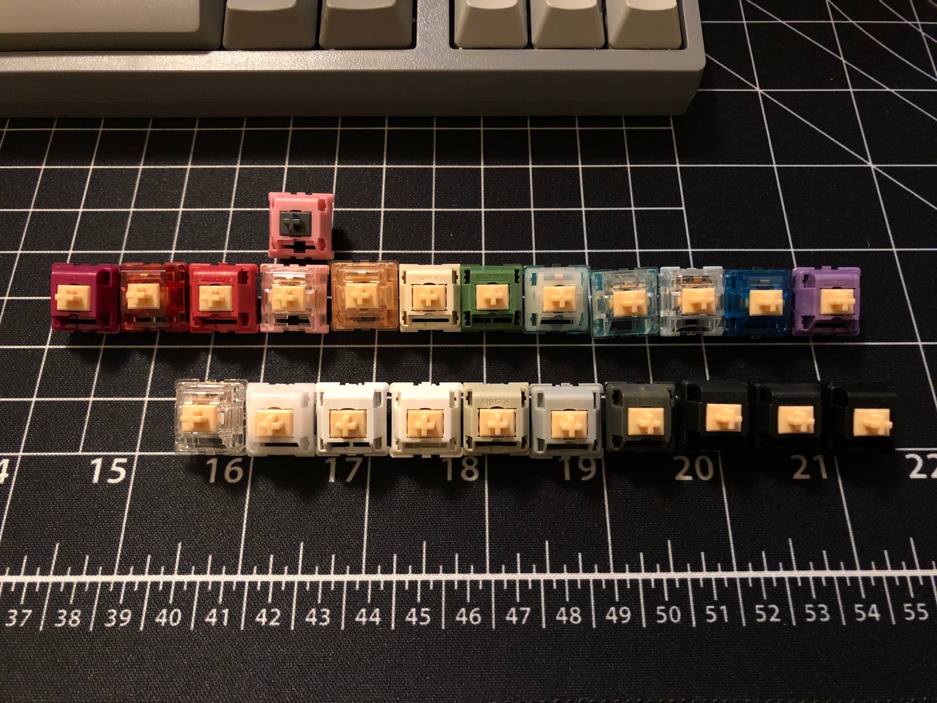

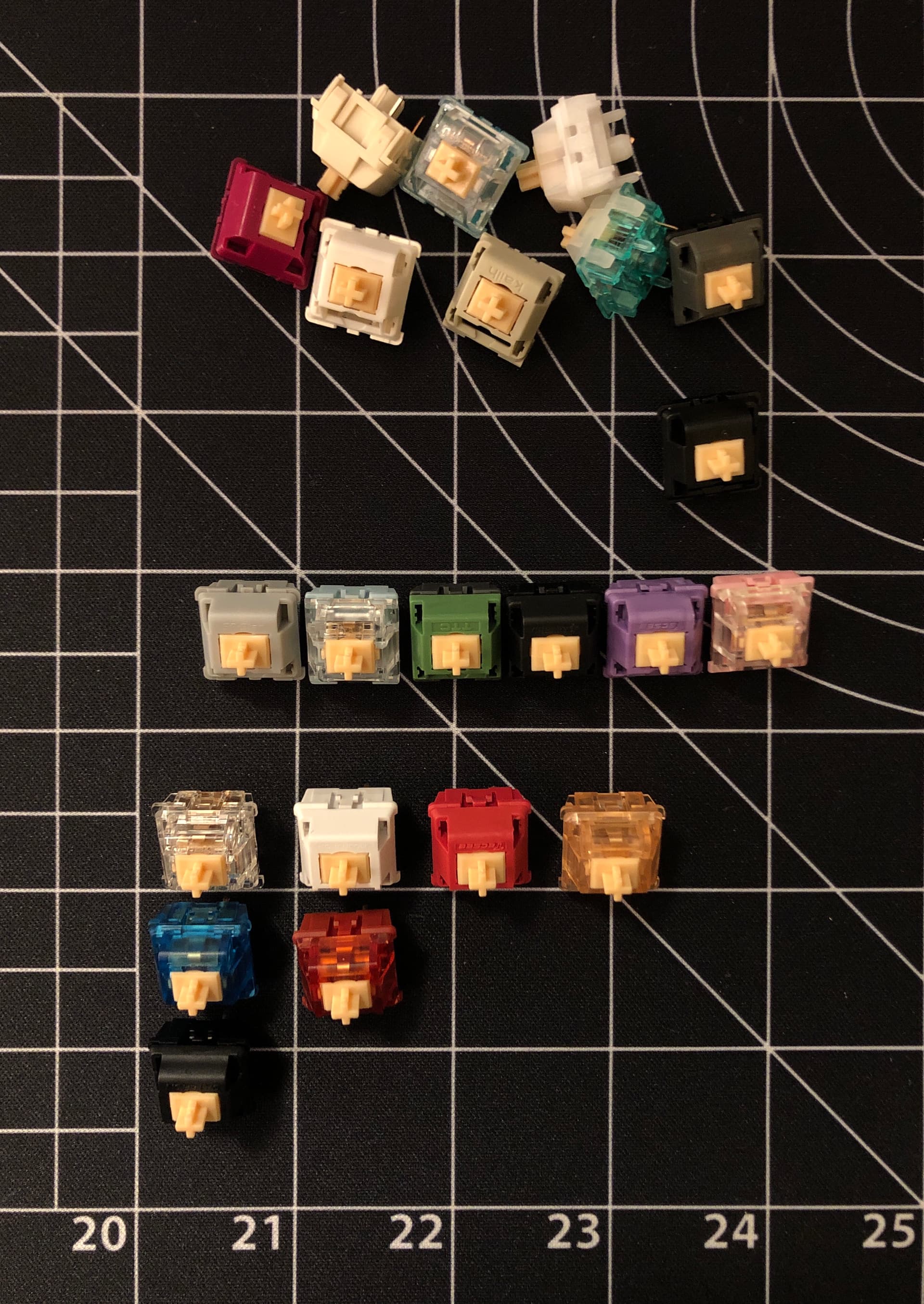

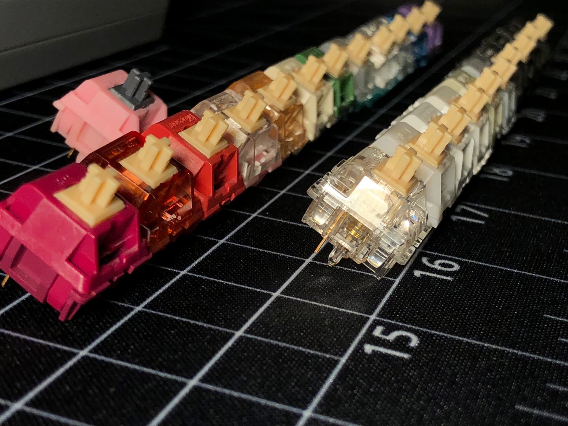

Alright! Iāve tried all these in-hand with the MM P3 stems, and have some first impressions on what I think might be worth it. I have not tried these in a live board yet, though - so keep that in mind.
Meh
Most of these have some kind of awkward aspect, like a leaf that dis-engages from the legs too early, etc:
Outemu Ocean - full travel, feels pretty rough
Kailhs; New Cream, Old Cream, Ice Mint - full travel, weird leaf stuff, feels a little rough
BSUN Panda - full travel, weird leaf stuff
Tecsee Diamond - nearly full travel but does bottom-out on pole, really weird leaf stuff + slip-stick, feels almost tactile
Tecsee DK Oni - hard to say, likely the same as above, weird leaf stuff, a little rough
JWICK Nylon T1* - short travel, this sounds great but the leaf is ill-suited; a JWICK nylon linear housing would probably be fine
Gazzew Bobagum w/ āOutemuā top - full travel, weird leaf stuff, meh
OK
These donāt have any problems and might even feel pretty decent, but Iām not sure theyāre worth cracking-open any switches to make:
SP Star Meteor White - short travel, a little wobbly, itās alright
TTC Wild - full travel, decently smooth, not bad
TTC Bluish White - very short travel, silicone plug thud
Cherry (Silent) Black - full travel, otherwise like the SP Star; ok
Tecsee Purple Panda - full travel, kinda swishy
Good
These feel really nice, and a couple sound really nice, too:
Gaterons Oil King, Ink, and North Pole - short travel, very smooth, great sounds
Haimus Heartbeat and Moondrop Lunalight - full travel, smooth, stable
Tecsee Lychee - full travel, pretty smooth, nice top-out sound
JWK NK_ Silk Olivia - short travel, smooth, clacky
The Gaterons and Haimus are the easy favorites for me, here.
If you like the Nylon clack, go for the Oil Kings, otherwise the North Poles are my fave of the 22 housings Iāve tried so far - extra smooth and they also have a nice clack. The Inks are great too, but not really worth the extra few cents over the NPs - but a great option if you happen to have some lying around.
If you prefer full travel, so far the Haimus are the only ones that I think are really worth it.
Unsurprisingly, JWK housings are also good, and Iām sure the MM housings work great with these, too.
I have a lot of unused switches. Most of them either have too much wobble (gateron) or need films (earlier jwk). Iām thinking some of these stems might be upgrades for those housings, but Iām not convinced. I feel like the housing is usually the weakest link. Has anyone tried the MM housings? Are they smooth? Do they need films?
