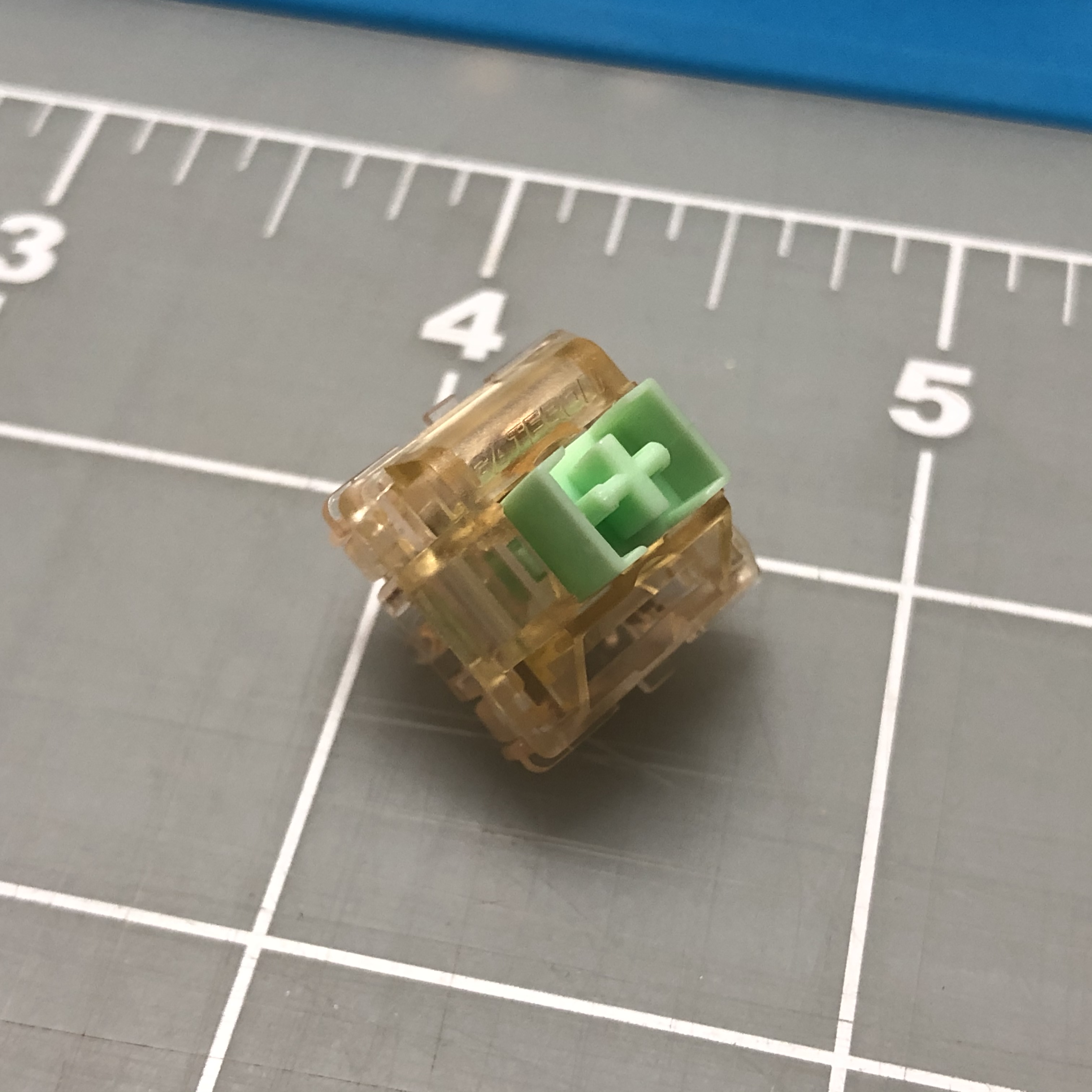

First impressions out of the bag:
Woah! Not sure what I expected but I’m surprised.
Snappy and bouncy. There’s a short, crisp bump to break through up-top that gives way to a mild cushion and a lively return. I think I get the Kangaroo name now.

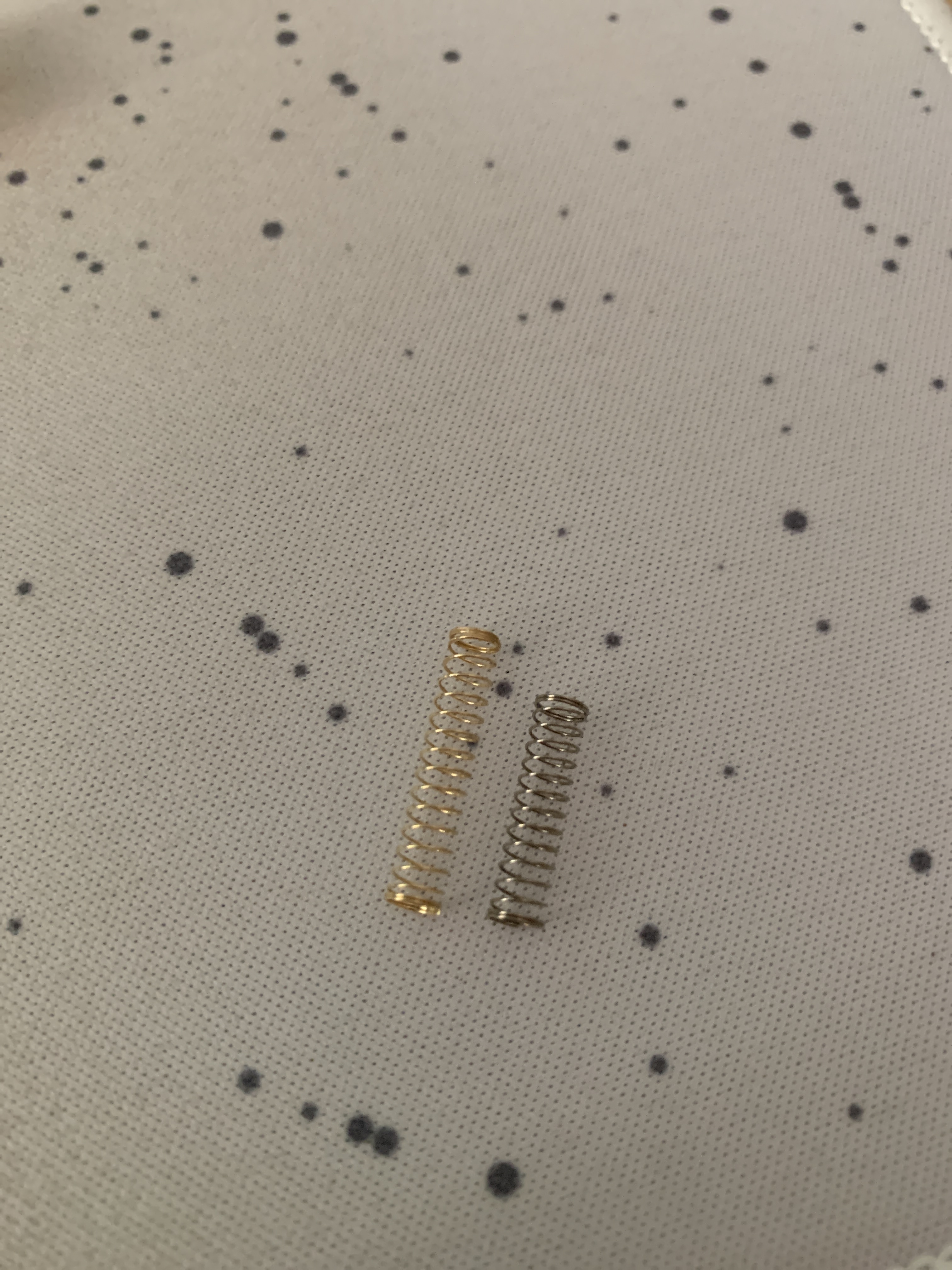

By the way, Check out these longboi springs:

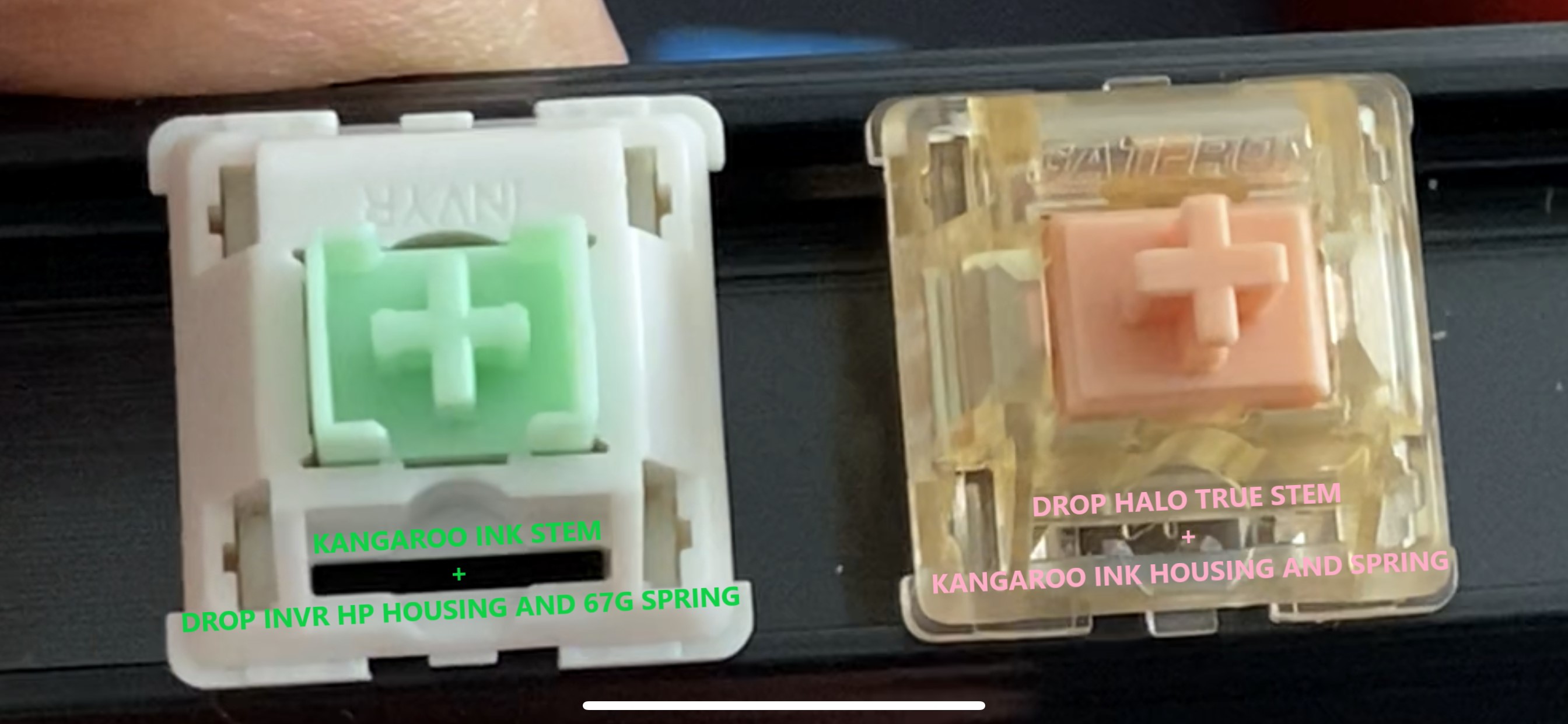

The Kangaroo stems work well with the Drop Invyr Holy Panda housings especially if you spring swap them. If you only swap the stem, the Frankenstein Switch (Pandaroo) loses a bit of its tactility but if you swap the spring they maintain their tactility.
In this photo I only swapped the Kangaroo stems with the Drop Invyr HP stems. I also put the HP stem in the Kangaroo Ink Housing. If you have put a Halo True stem in a Gat Ink housing before this is nothing new and is identical to a Holy Panda.
