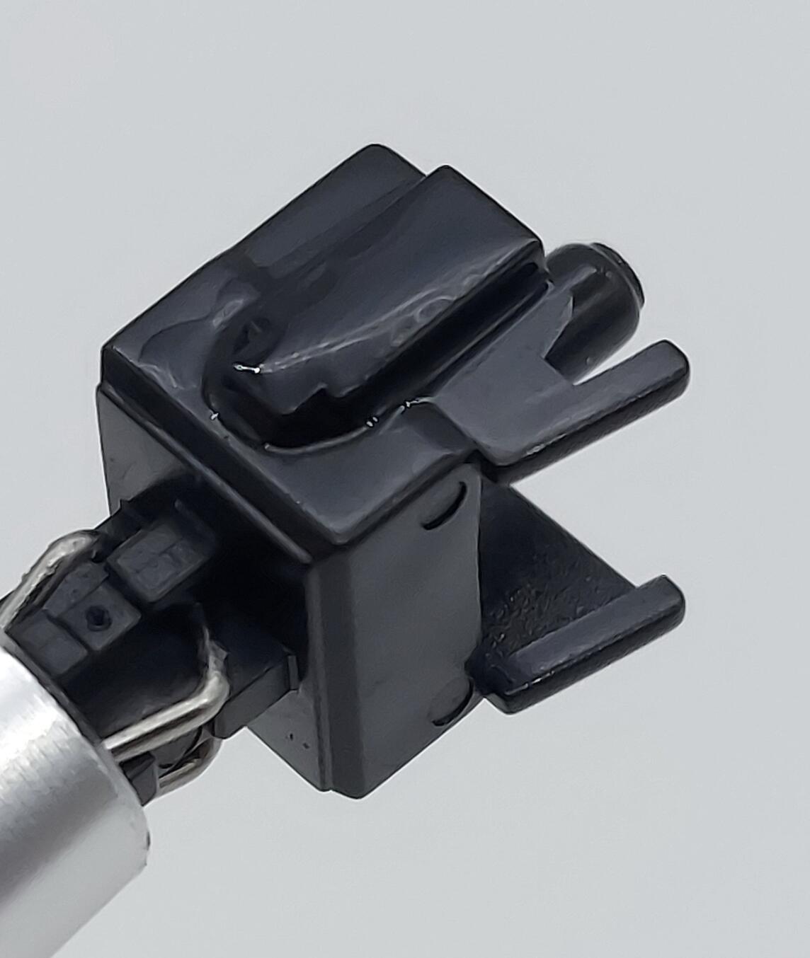

As intriguing as how that lube stays in place is, this killed my interest:
As for the sound of the Oil King switches, this is unfortunately the area that I feel like Gateron still needs to improve on the most, but not by all that much.
Second mystery is how its sound could be lacking with that stubby stem poll.

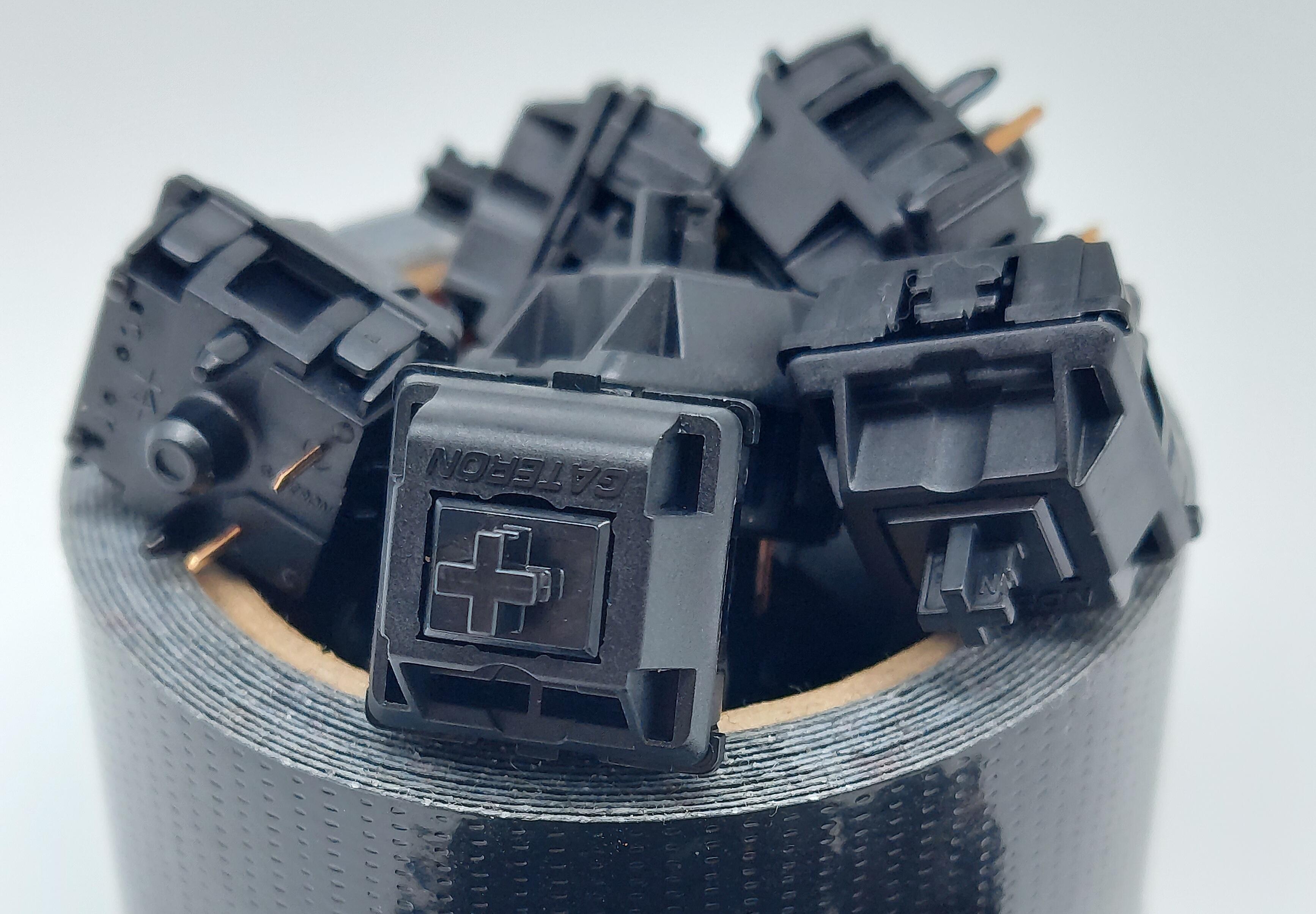

Just was messing around with my batch of Oil Kings & found that putting a Cherry top housing on them really deepens the sound up. Makes these what you’d expect from the description (Ink thermoplastic bottom, nylon top, POM stem). There is a caveat though. I tried top housings from hyperglides which were too tight for the slider. Then I tried some from retools which were better, but still to tight IMO. After that I went to a batch of MX blacks that’s not quite vintage but made well before the retools & those finally fit right. I also tried vint black top housings which worked well too, although I wouldn’t recommend harvesting vints for tops on Oil Kings TBH. So you’ll need to search out pre-retooled Cherry switches for this mod (hey finally a use for those scratchy bastards! LOL)
I also tried a bunch of other top housings of varying materials & from different manufactures with them. Nothing else that fit right really made a drastic change in sound. OG Cream top housings had a interesting sound, but it was on the higher pitched side & was still pretty close to stock Oil King sound IMO. Sorry to necro this thread, but I figured the info was worth it.
