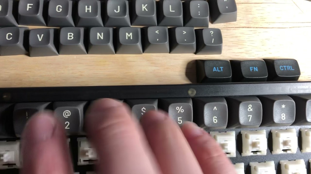

I figured this would be as good a place as any to post documentation of the clearance issue between the Ikki68 Aurora case and MT3:
I also took a closeup of the stab clearance issue with MT3, posting here because it’s OA stabs on an Ikki68A in the video but the issue definitely isn’t limited to those - if anything it affects all stabs to a greater or lesser degree, and I guess OAs are included in those that rotate just enough for MT3 to brush against itself:
That is, a little bit of both - at least with the clearance stuff. MT3 is a little larger at the bottom than most caps, and OA stabs allow for what appears to me to be a bit more than average twist.
As for the stressed cap-stems, I think that’s more just an OA stab issue - they feel really tight in caps.
@inter unfortunately I think the answer there is yes, but that doesn’t mean they won’t work at all - you just might have to do some sanding like I am to address any contact. I’m looking to finish this over the weekend, and I’ll post results when it’s done.
When I get the board put together I’ll let you know about other profiles. I ended up with a different space bar getting cracked, but it looks like that may have been down to my shaky hands during removal and not purely from any stems, as all three including the center switch one cracked. The OA stabs do seem pretty tight on other caps so far either way.
I’m actually rebuilding the whole board again so I haven’t tried different caps yet, but I can confirm a method that worked for me to resolve the issue:
Aside from burnishing the small amount of flash on the bottom edges of the caps (flattening the thin ridge of plastic that sticks out), I made sure to gently pull the bezel outwards when tightening the two middle screws.
I did this on both long-edge bezels, being sure to only tighten the screws enough so they won’t back-out - they don’t need to be very tight at all thanks to the many threads and gaskets adding tension.
I did take a comparison photo of an MT3 cap vs a Cherry profile IFK one, and they are a hair taller from front to back:
All edges are flush aside from what’s sticking out there - between that fraction of a mm and the natural warping of polycarb, these caps rub on that case until you take a step or two to prevent it.
