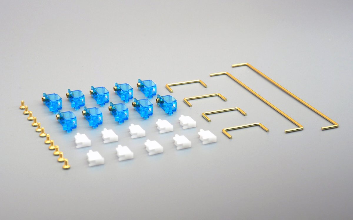

Wuque is releasing a new type of stabilizer called WS. It’s supposed to be designed in such a way as to prevent the wire from popping out. But it’s GB-only right now.
Aye, I ordered some of those to go with my R2. I’m interested to see how these new ones do; one of the changes is adding rails to the inside of the stab housing like switch tops have. Aside from making them less susceptible to feeling sticky with lube, I bet it will also cut-down on the twist. :crossed_fingers:

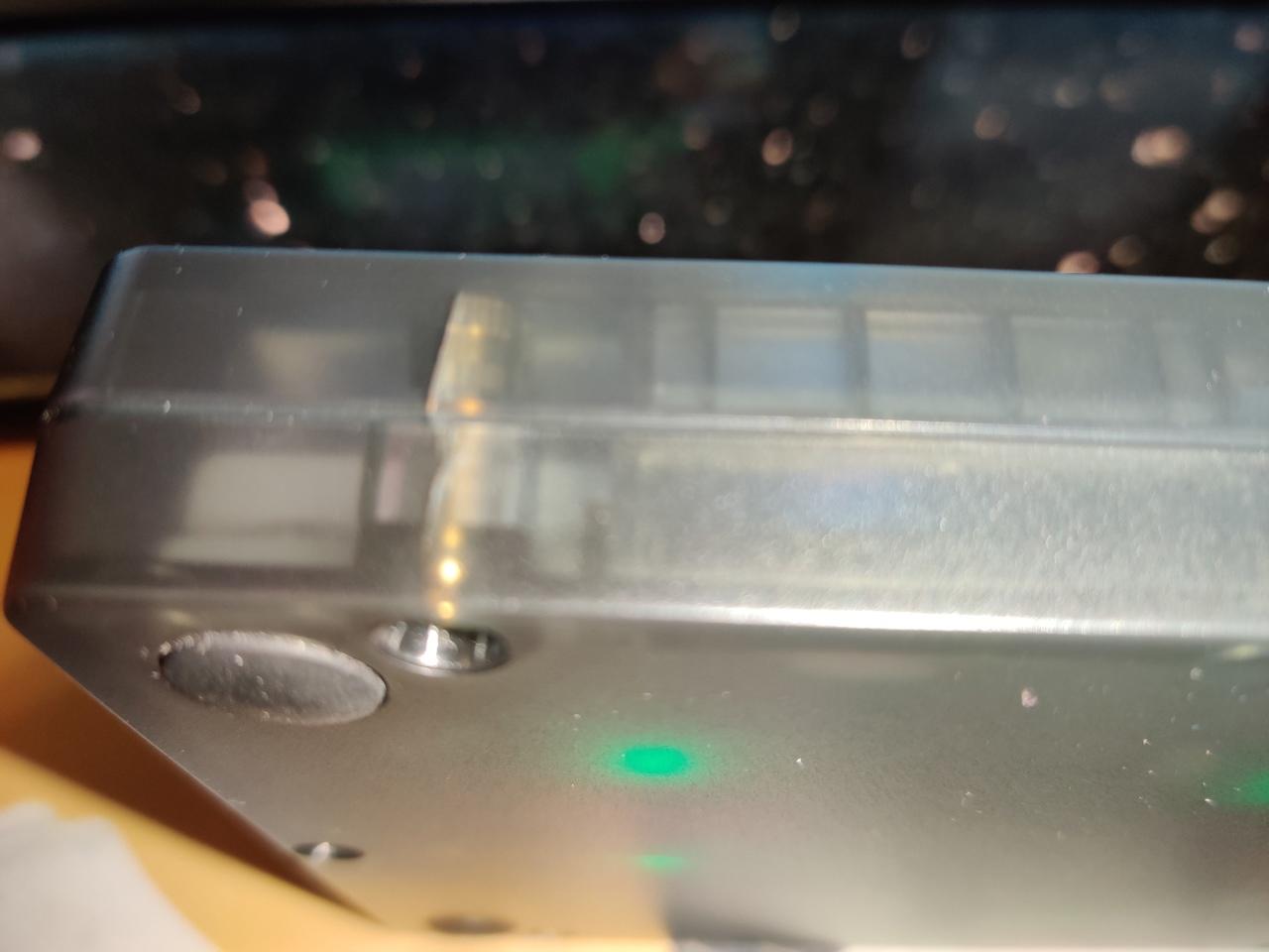

This is not only mine, but who bought it from my country, I also asked them to look. smaller or the same cracks.

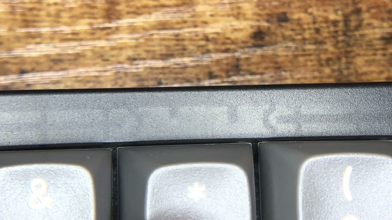

I figured this would be as good a place as any to post documentation of the clearance issue between the Ikki68 Aurora case and MT3:
