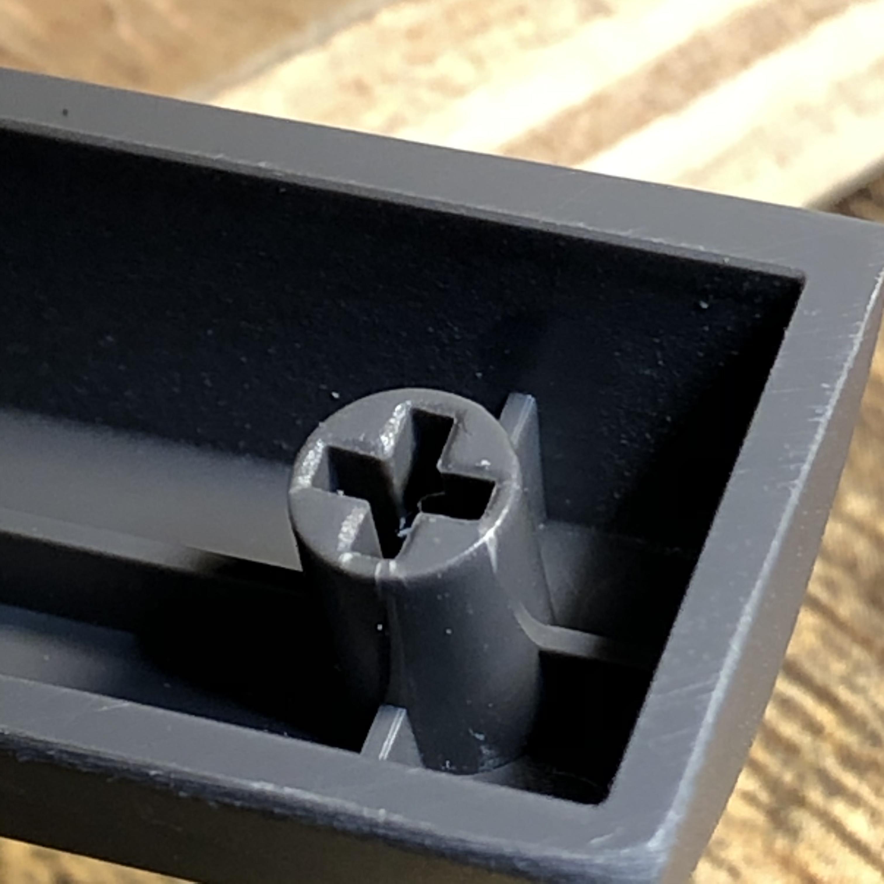

Not trying to spam this thread, I just happen to be working on one of these right now - one more note about the OA stabs and MT3:
They will stress your cap stems.
None appear broken but you can see the stress marks at the corners and even shavings inside the stem.
Hmm, MT3 or OA stab problem you think?

That is, a little bit of both - at least with the clearance stuff. MT3 is a little larger at the bottom than most caps, and OA stabs allow for what appears to me to be a bit more than average twist.
As for the stressed cap-stems, I think that’s more just an OA stab issue - they feel really tight in caps.

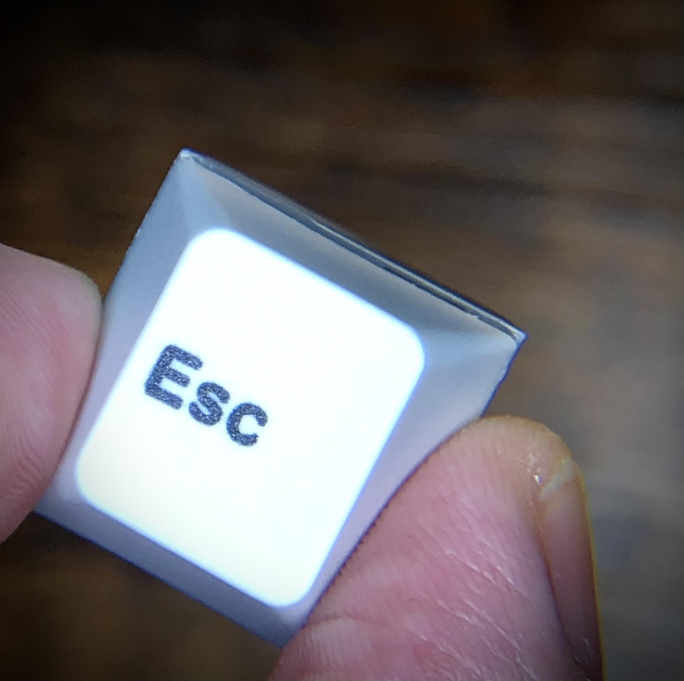

I did take a comparison photo of an MT3 cap vs a Cherry profile IFK one, and they are a hair taller from front to back:
All edges are flush aside from what’s sticking out there - between that fraction of a mm and the natural warping of polycarb, these caps rub on that case until you take a step or two to prevent it.

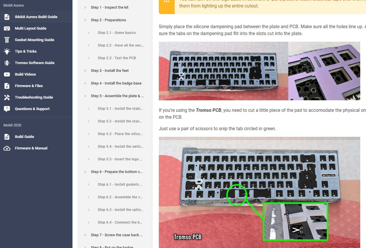

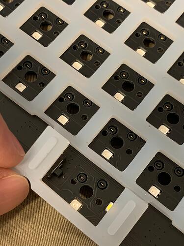

I picked up an extra Ikki68 the other day and had a question. Did anyone use a wireless PCB with the silicon plate pad? It seems to be incompatible because the switch for the wireless mode is on the face of the PCB and there isn’t a cutout on the pad for it. Do people just cut the pad?
EDIT- just read the build guide, and yes, you do cut it.
