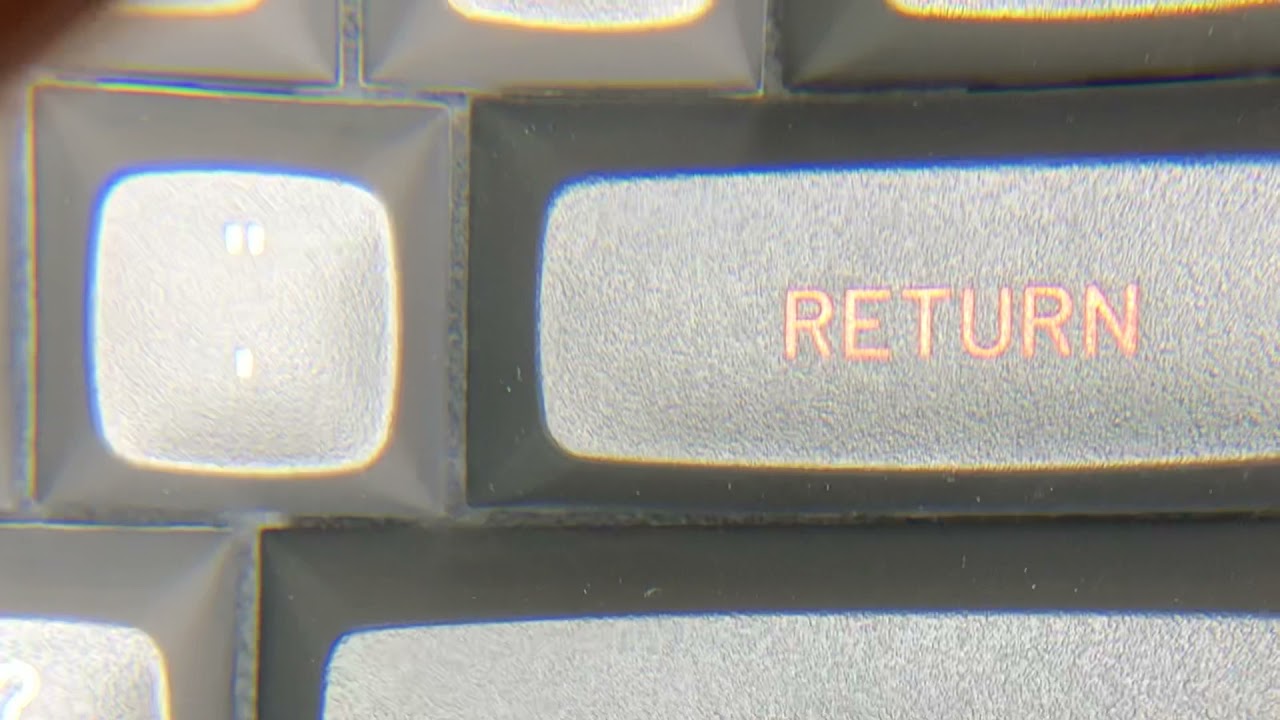

Hey! On mobile so short reply: but here’s a vid comparing my two sets of MT3. Double checked the stabs and no issue there. Think it’s def a clearance issue.
Going to send this to Drop support to see what they say — but idk what they can do. In the meantime might try to sand down the edges…?
Yes I think the keys are surprisingly rotate-able with the KBD67 lite which contributes to this - in addition with just the keys being just that slightly bigger perhaps :confused:

I wasn’t able to watch your video earlier but now that I have, it looks like the whole cap is sitting closer to the next row up than it should.
It almost seems like something below the cap isn’t seated where it should be, whether it’s the switch or stabs I’m not sure. My KBDfans stabs have play if I purposefully push them that way, but there aren’t any clearance issues like in your video with the three different MT3 sets I’ve used on it. Maybe I could see something from a photo with the key removed.

Heya – yeah I double-checked last night but it’s still creating that clacking sound regardless of the orientation of the Enter key. I also double-checked that the stabs were in properly and that both sides of the key were fully pressed into the stabs.
I think for some reason the Enter key is just a LITTLE bit bigger in my Susuwatari set (compared to me 2048 set) but it’s enough to cause clearance issues.

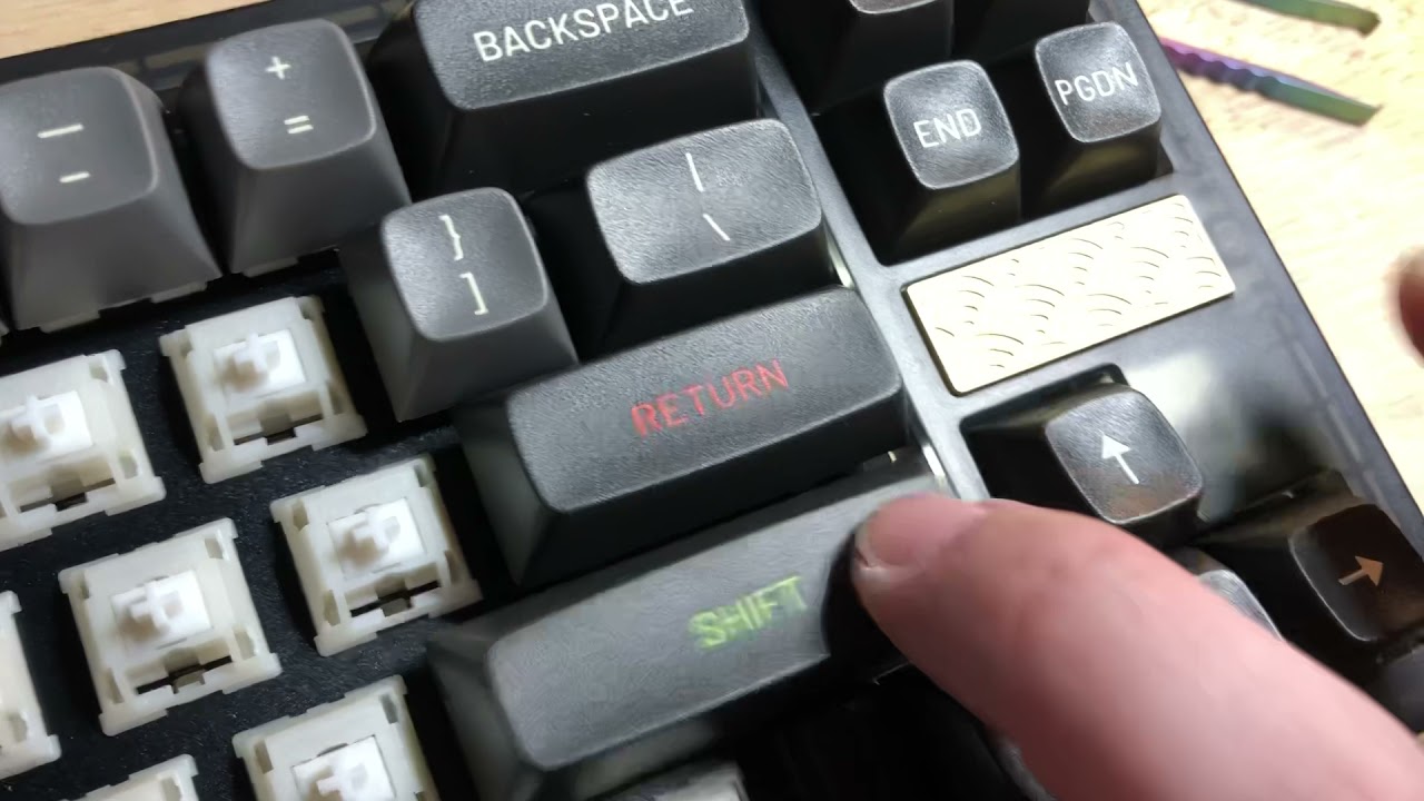

While building this board, I ran into the issue of the spacebar rubbing against the case depending on where it was hit. I can’t remember which thread, but I know someone else recently mentioned their MT3 keys brushing the top part of their case. The Ikki68’s case is pretty tight around the caps, and the OA stabs let the space bar rotate juuust enough to brush it.
I got around this by doing two things; loosening the case screws and re-tightening them while pulling the front bezel away from the space bar slightly, and by carefully sanding-down the edge of the keycap.

Some documentation of this:
OA stabs used in the video, MT3 Susuwatari keycaps (from R1 according to the box).
Update; here it is resolved by doing a few things which I’ll describe below:
It turns out that Return cap was hitting both the Pipe and Right Bracket keys, depending on where it was struck.
You might see in the previous video the bright edges of the caps at the bottom; that’s flash, or a thin edge of plastic from the molding process. For most caps I just carefully used a fingernail to burnish that down to a round smooth edge, reclaiming a fraction of a mm and reducing the light caught at the bottom of the cap.
For the Return cap, I sanded all the bottom edges, and dug-in a little more at the top and top corners. I think it’s 220 grit that I have, it could stand to be a little more fine but it works when combined with something like cotton or even just a finger to burnish any plastic fuzz.
With the Pipe cap, it turns out the whole thing was off-kilter. The alu plate doesn’t have anything to hold that one in place, and the Boba bottoms have thin-ish fixing pins, so the switch and cap are able to rotate out of place. Swapping-in a Gateron bottom helped enough to make a difference.
Those three things together eliminated the clearance issues, but I’m still not really happy with how the stabs sound. The clips let the wires move too much, and while various types of padding under the wire were all helpful, none could completely eliminate it with these stabs. I’ve decided to use Zeals on this build and revisit the OAs another time - I have a couple things I’d like to try that I think might make them viable for a silent build.
