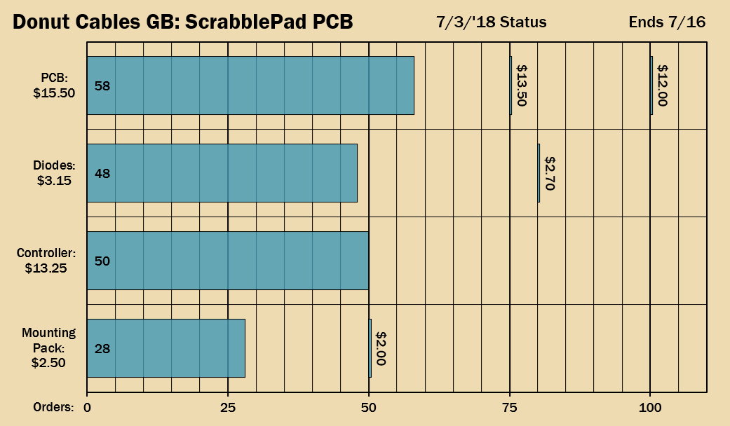

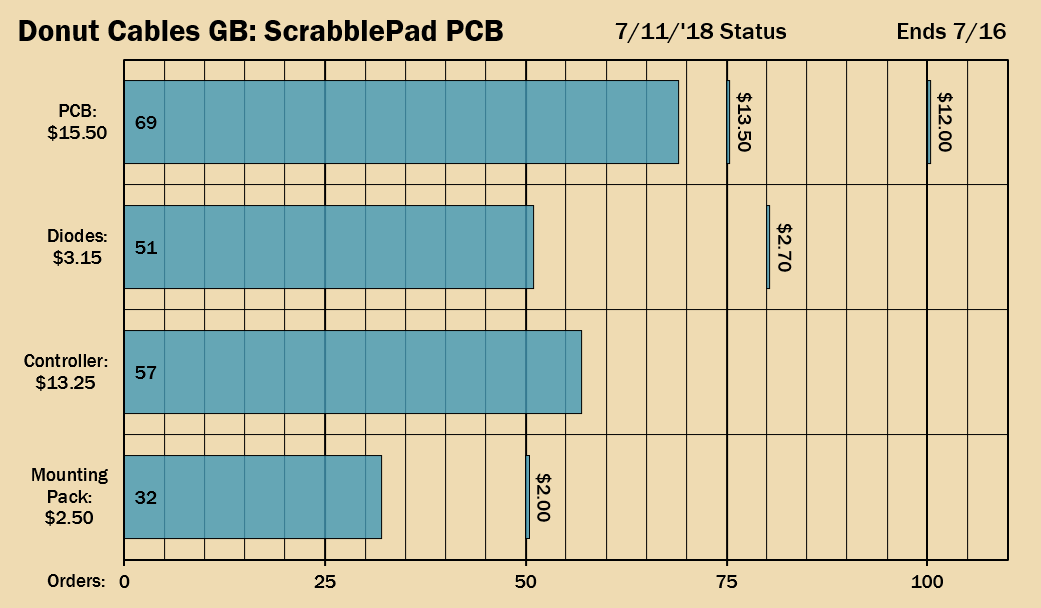

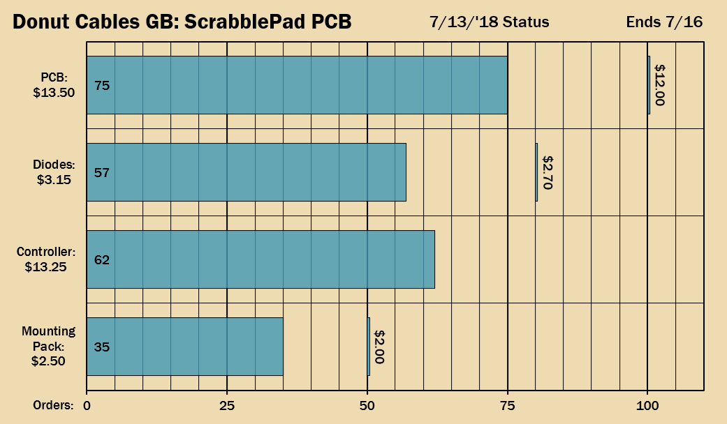

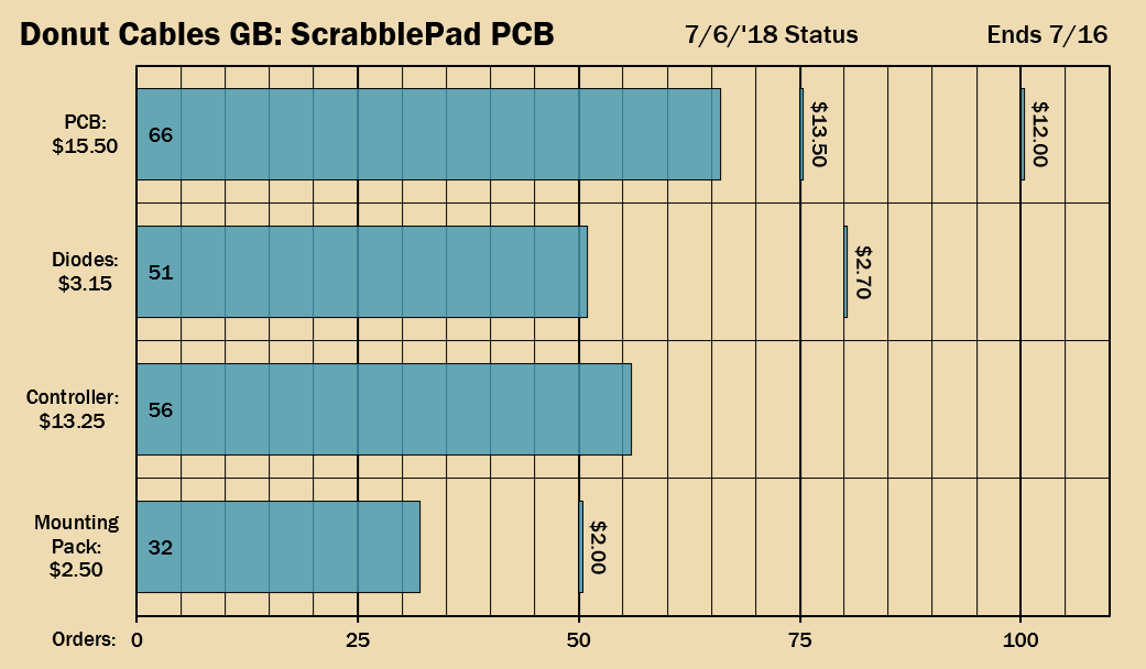

There are several sets of components in this GB and I’ll outline them below in some detail with their pricing:
PCB
This is a bare PCB that requires a minimum of a controller and diodes to function. A second PCB and the Mounting Pack can be used to replace the need for a case. Price points are as follows:
5 units - $20/ea
10 units - $19/ea
15 units - $18/ea
20 units - $17/ea
25 units - $16.5/ea
30 units - $16/ea
50 units - $15.5/ea
75 units - $13.5/ea
100 units - $12/ea
500 units - $9/ea -
Diodes
Standard 1N4148 diodes, come in packs of 250, enough for the board and some extras to account for defects, mistakes, and dropping them. Diode price points are as follows:
10 packs - $4/ea
40 packs - $3.15/ea
80 packs - $2.7/ea -
Controller
The controller I’m offering for this drop is a Teensy++2.0 equivalent. Functionally the same and able to utilize the Teensy.exe app or QMK Toolbox for flashing. Included with the controller is a stick of 40 header pins to solder it to the PCB. As part of ordering this controller through me I will pre-flash a default map, test for mapping and functionality, and remove the LED on pin D6 which is a required mod for use in this board.
$13.25/ea(half the price of a “normal” Teensy++2.0) -
Mounting Pack
The Mounting Pack includes the hardware necessary to mount a second PCB to the bottom of the board to work as a plate/case for the board if you don’t have the Novelkeys/JOlimon case. Included are 20 bumpons, 18 7mm standoffs, and 36 screws, enough for the board and a few extras in case you drop any or the cat decides they make good toys.
Price for the Mounting Pack is:
10 packs - $2.50/ea
50 packs - $2/ea
Planned GB period run dates are from 6/25 to 7/16. Orders will be processed to invoices the following week. Production timeline is expected to be <1month after payment is received. PCBs themselves should take 1-2weeks, components could take up to 3 weeks from the order date to ship to me.
