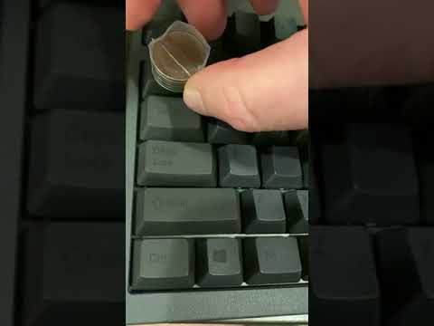

My 980C delivered. Domes feel slightly lighter than the 30g domes I harvested from a R2TL-US3-IV. I took a janky portrait video to demonstrate.
Maybe it’s just that the stock PBT keycaps are heavier than GMK?

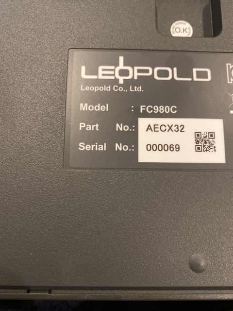

Also, shame I’ll have to cover my serial number in the Heavy-9, hurr
