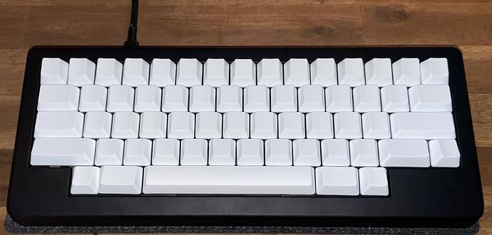

I bought a HG GoCF last week, it came with Novatouch sliders (except for the spacebar), but the plate hasn’t been drilled. So I’m considering if I should switch to stock sliders/keyset or drill the plate?
Would be great to hear other peoples experiences.

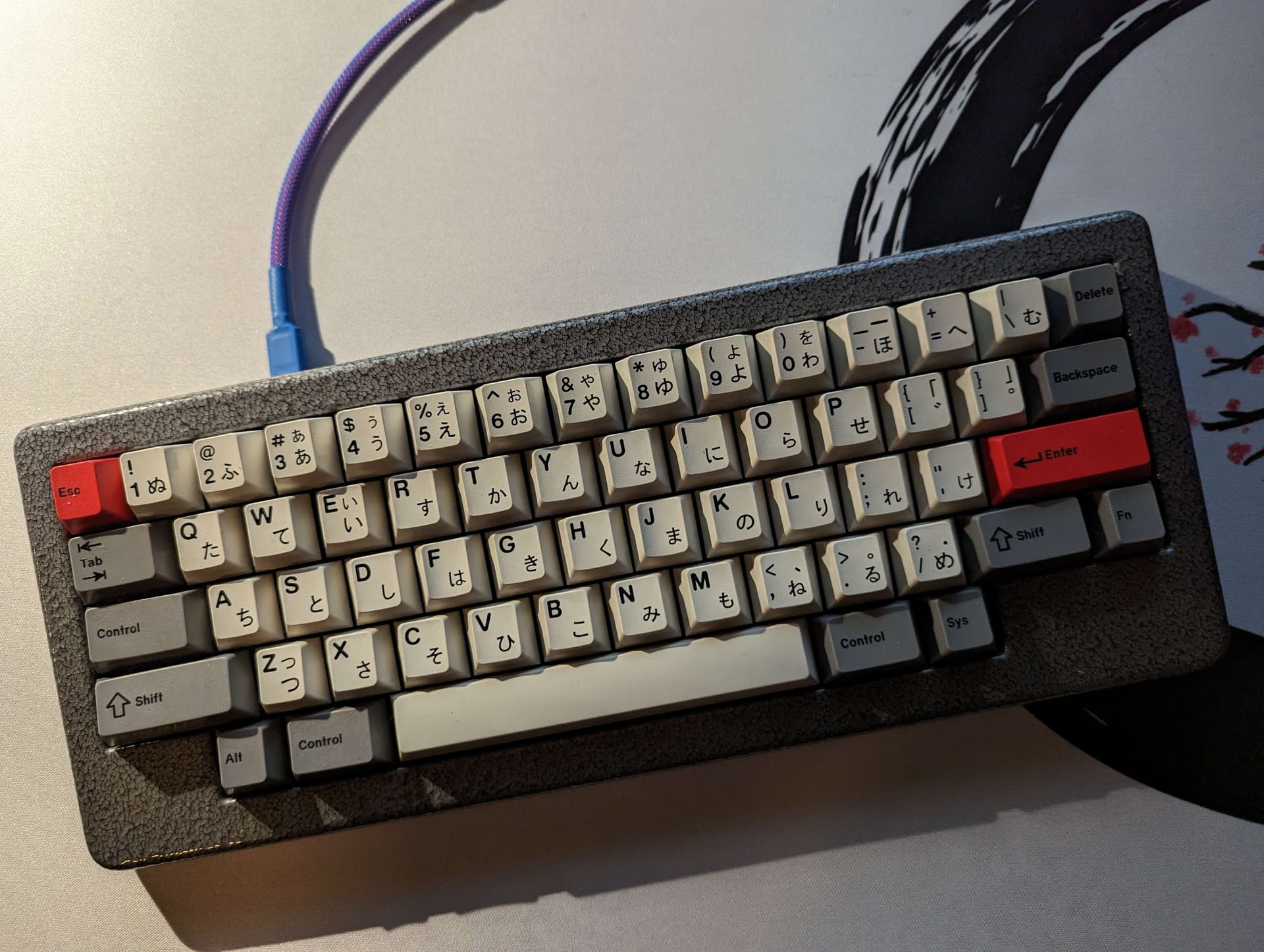

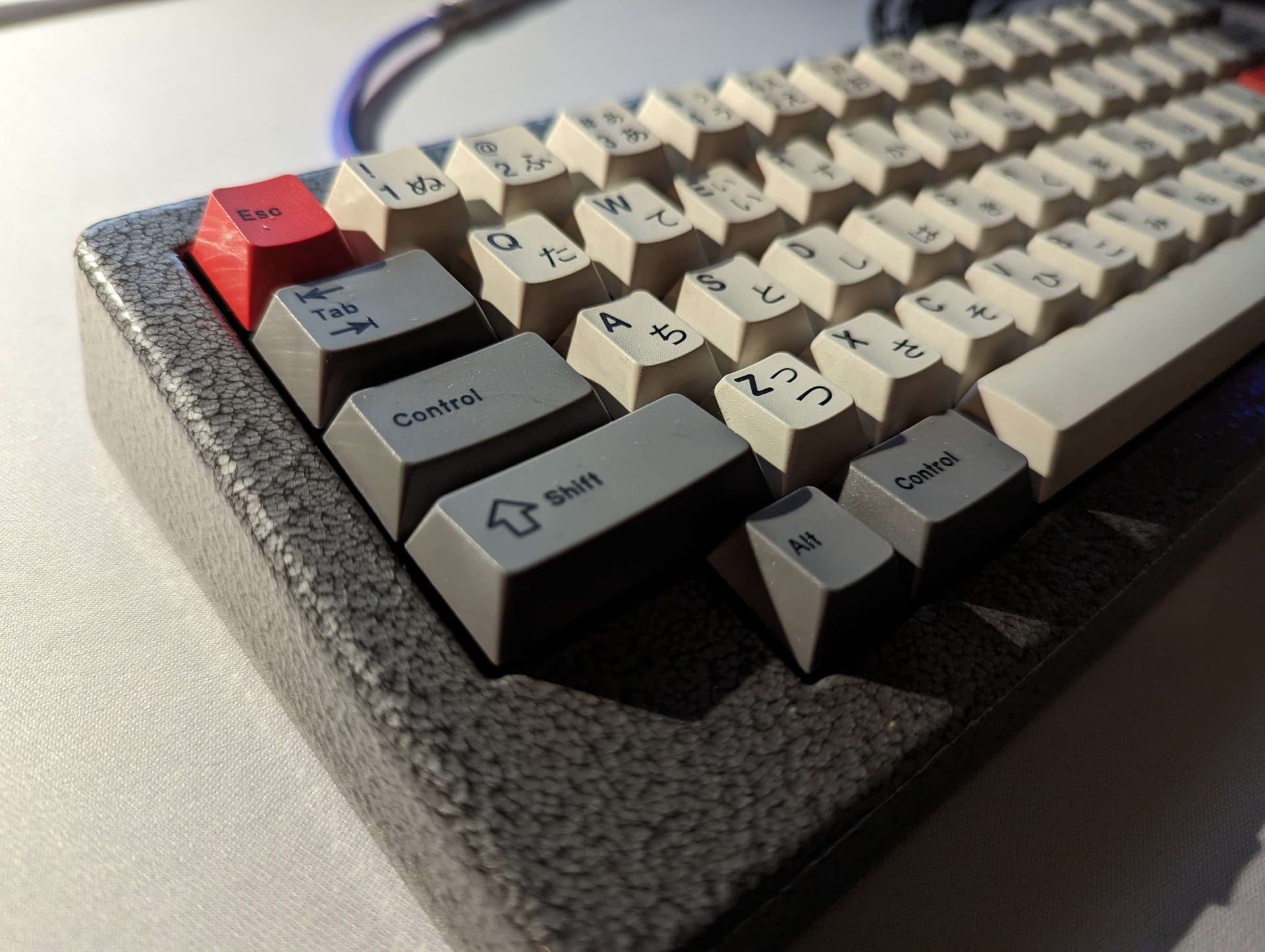

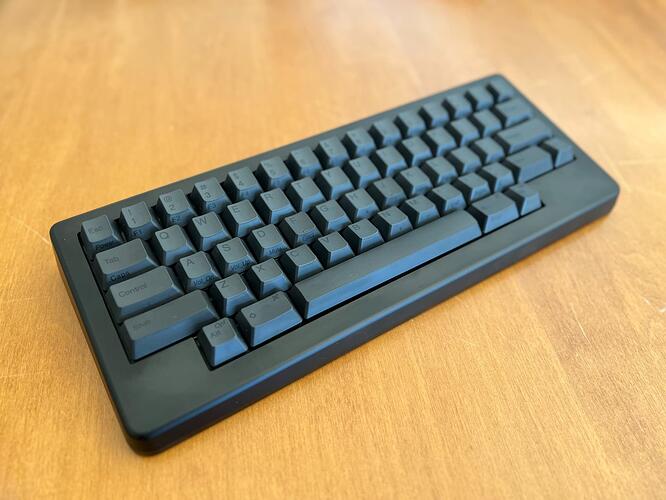

Finally got around to finishing my build after procrastinating on it forever mostly because I’m totally new to topre and this being my most expensive keyboard purchase ever, was a little anxious about messing it up. The only hiccup I had was with one of the screw’s hex heads being stripped so had to get my friend to help me get that out with some of his tools. Modded it with deskeys purple domes, silencing rings and sliders. I was lucky and spotted GMK Beta extras and was able to get in on that and then I got even luckier and was able to secure a spare 6U GMK 9009 spacebar from @AdrianMan so huge props to him for helping me out with that and with his instructions for doing a stem transplant to get a centered stem. I am very happy with the outcome of this build.
Looks amazing! Did you have any issues with deskeys sliders in the heavy grail?
No big issues with the deskeys sliders. The only thing I have noticed is that some of the sound is inconsistent from key to key. Whether that comes from the switchplate or the sliders or just me, I do not know. But everything works great as far as I can tell. I had to exercise a little ingenuity when it came down to muting the stabilizers - also from deskeys. For the left shift and enter keys I was inspired by the old bandaid mods we used to do for old stabs so I cut some small squares from the bandaids and applied them to the tops of the stabilizers and added the tiniest amount of g205 on top. I also used the hand drill from deskeys for holes to allow the left shift and enter keys to be pressed through and it worked great, if not somewhat of a pain and slow and anxiety inducing process.
Wow that turned out awesome ! Glad I could help out !

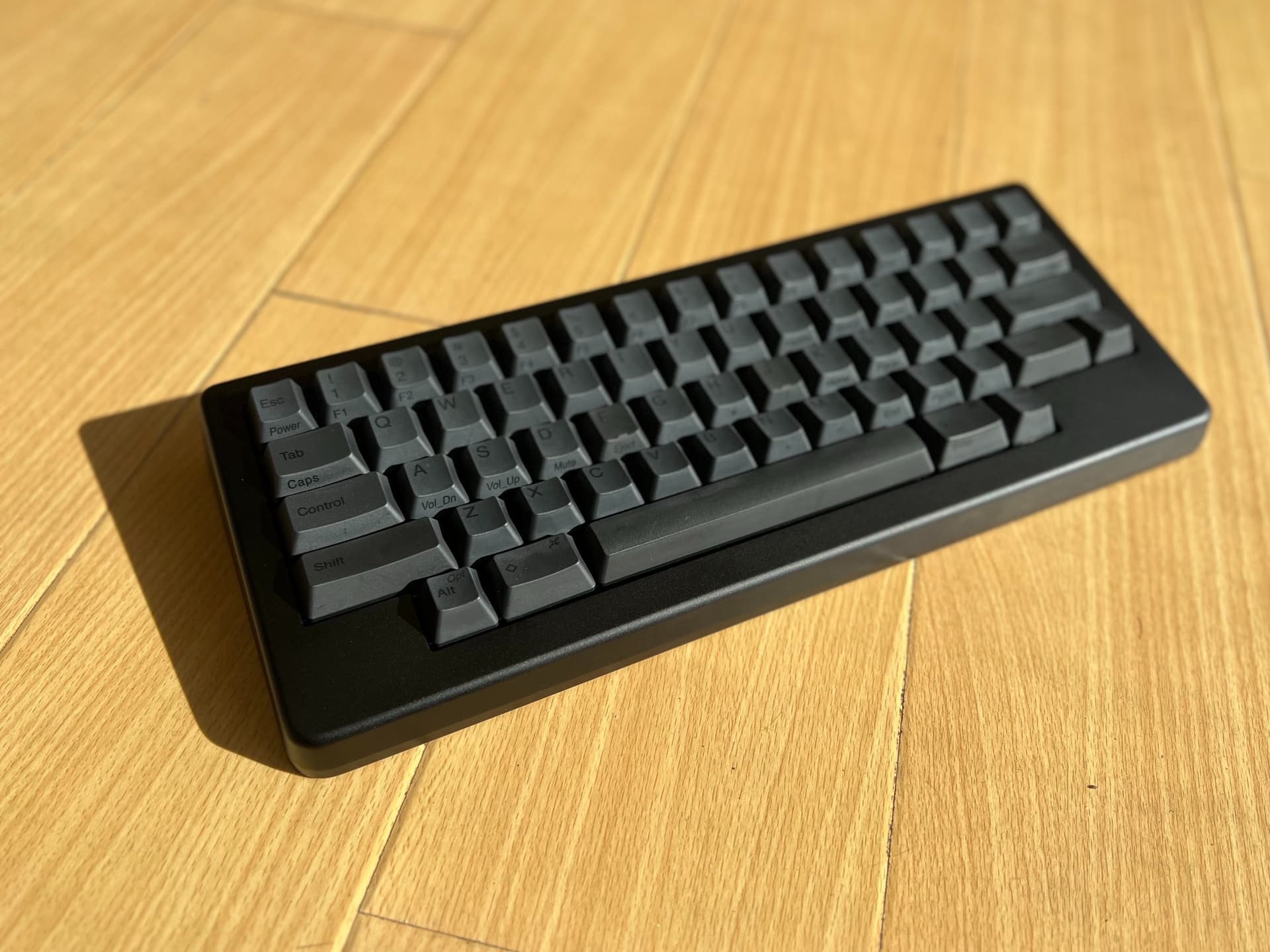

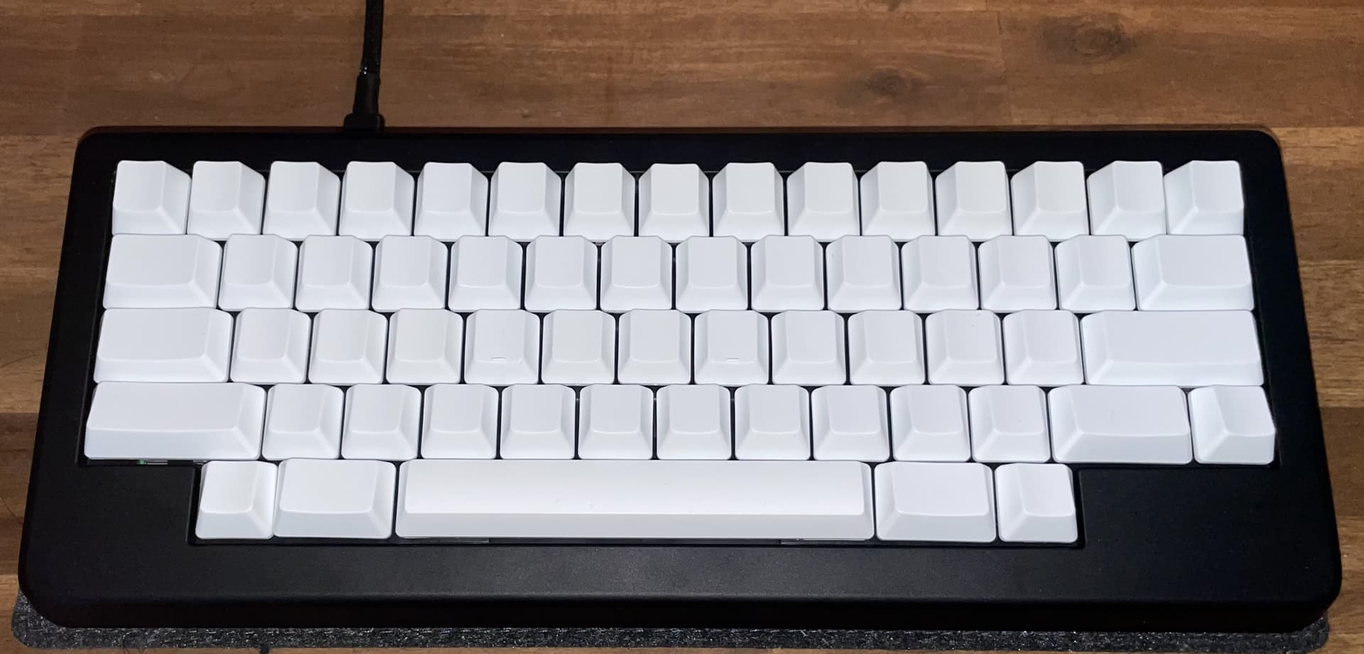

Got the HG in tactical black delivered today and just finished the build - I love everything about it! Thanks for the well made product!

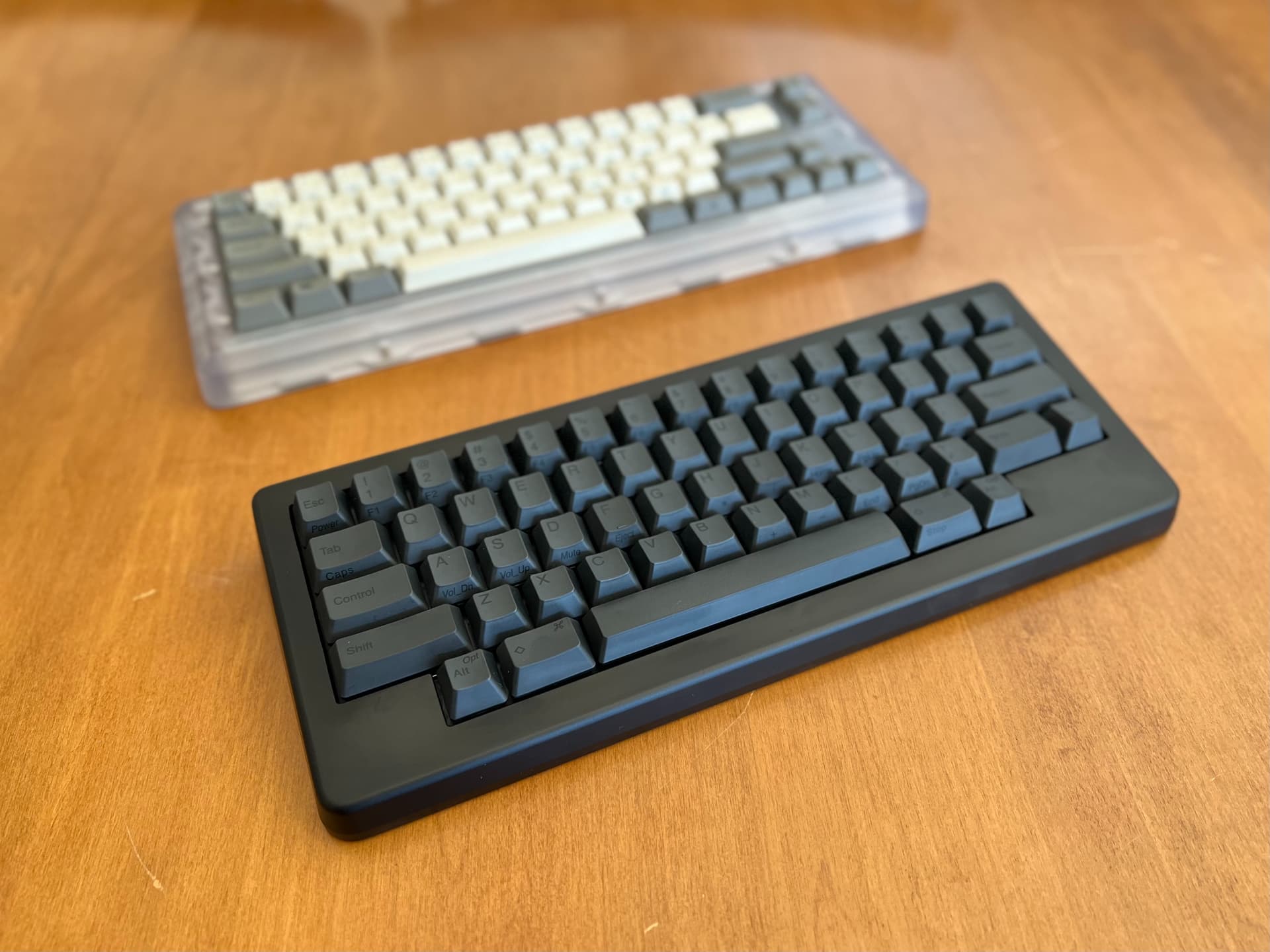

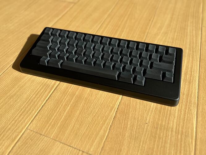

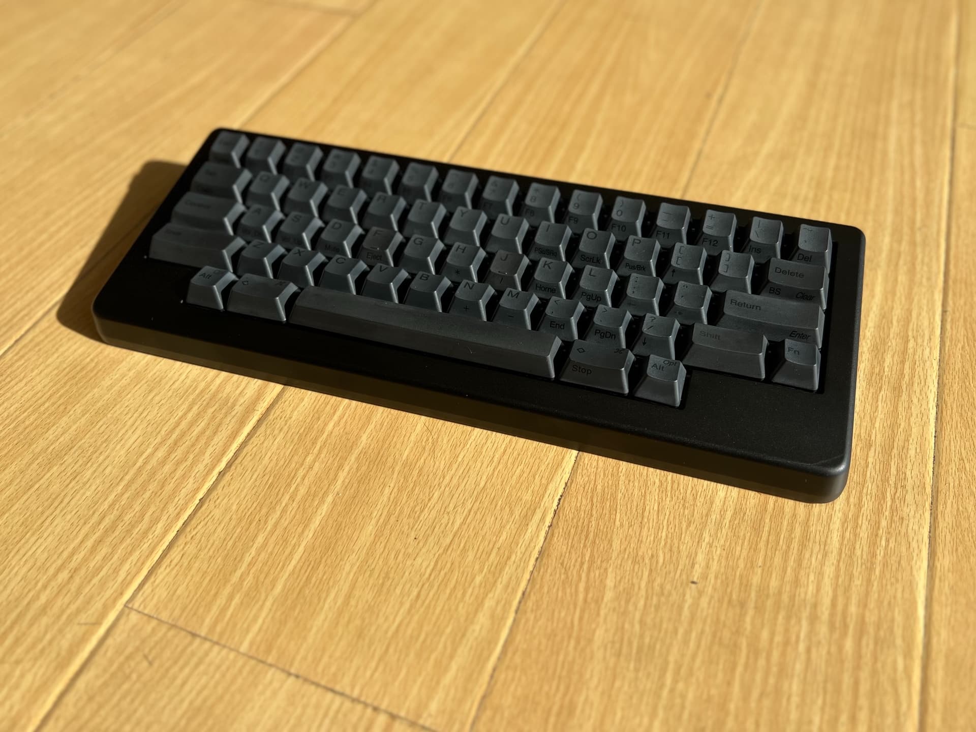

My Tactical Black HG came in late last week and I built it over the weekend. Absolutely adore it. Love the feel and the sound. Especially the spacebar. :kissing_heart::ok_hand:
Built with a brand new black/charcoal Hybrid Pro 3 (non-S). Lubed with Tribosys 3203 on the sliders and 205g0 on the stabs.
Last pic with my polycarb Heavy 6 picked up from the Norbazaar.

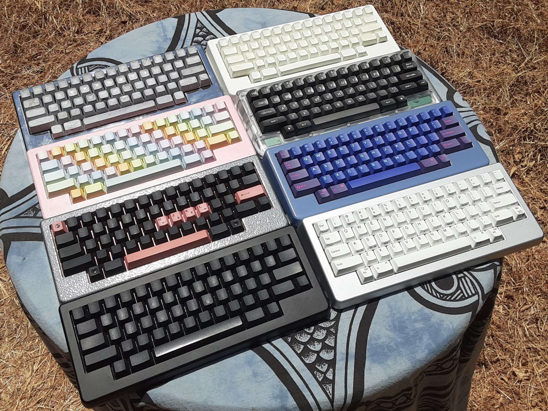

Heavy Grail family photo. Waiting on one more to complete my set.
Holy smokes Batman! This is craaaazy.
Do you have a favorite in the family? Lol
Wow. I think 8 Heavy Grails each fine-tuned slightly differently would be quite an experience.
