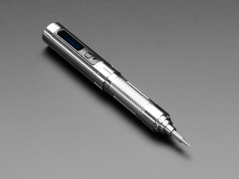

Also, one of these motion control screwdrivers if you are either needing to assemble a lot of keyboards or simply want to pretend you are the new Dr. Who incarnation!
I have the es121 and love it and @olivia

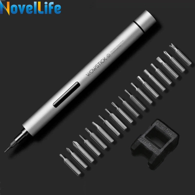

Any suggestions for a cheaper alternative to the es120/121? I searched “electric screwdriver” on AliExpress and found the “Wowstick.” Does anyone have experience with this one?
@Quakemz Has the Wowstick; I think he said it works alright, but it’s really lacking in the torque department.
Like other things of mine, it’s average at best.
It “works”, but you generally have to get the screw started/finished manually, because the lack of torque. Honestly, I often just default to my normal manual driver from my ifixit kit because it winds up being more effort to grab my Wowstick. 10/10 Would not buy again.
