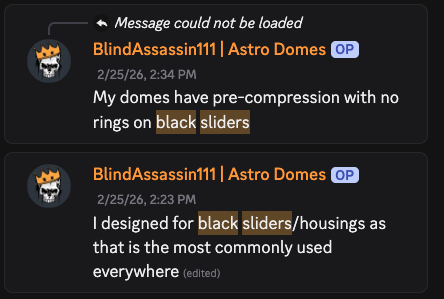

FYI from BA:
and
Screenshot 2026-06-25 at 10.00.36 AM
i don’t really know what is the ideal build setup for astrodomes. for me, i need my realforces to have 0.5mm rings whether that is poron or silicone, and i prefer the shorter black sliders as opposed to purple sliders (that come silenced from factory) that have a longer travel. type-s hhkb also has longer travel and im sensitive to that.
astrodomes feel more precompressed in the build setup i have in my realforces, but it doesn’t sound any rattle-y er or looser. if anything i added more precompression since BA said build on black sliders without rings. to me, the added precompression on my shiners in my setup is actually making them feel shallower and heavier bc ive already changed the dome shape and im starting my keypress at a different point of the dome if that is still comprehensible to you rn…

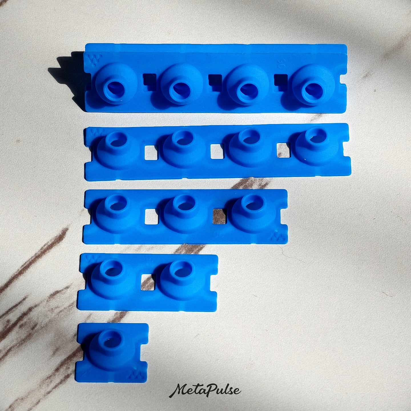

Metapulse made an open top version preorder in the US called the BS (Blue-Series) dome
