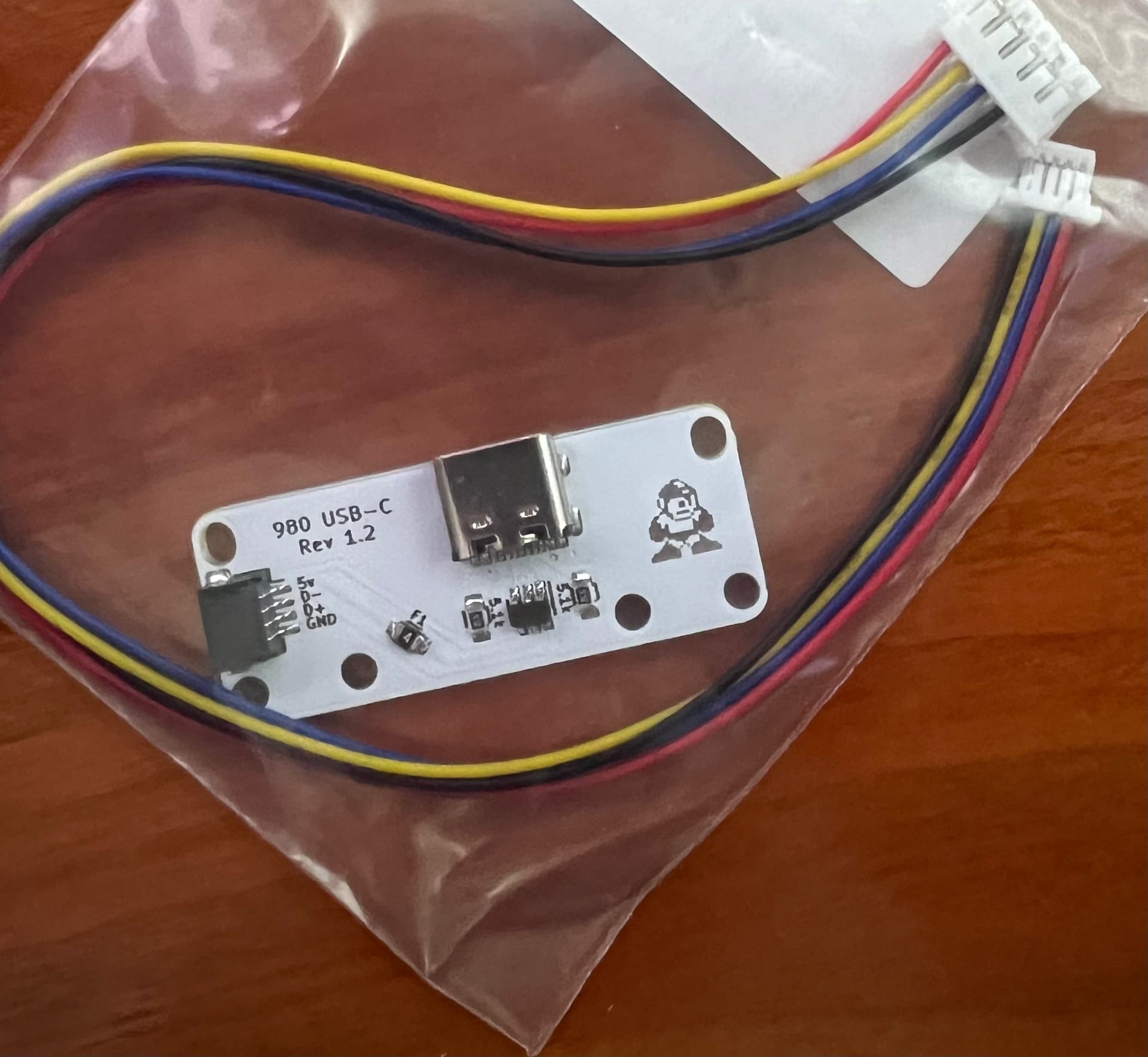

Although on the topic of @Dave — I’d like to get your thoughts on replacing the daughter board with one that has USB-C. This one has your avatar printed on it so I presume it’s yours. If so, would you happen to have an extra that you’re willing to sell? Assuming it fits the Heavy-9 without additional modifications.

That’s me, it fits the h9 with no mods. You can dm me if you want one.
