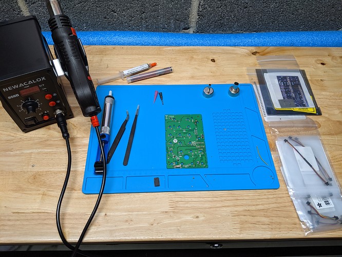

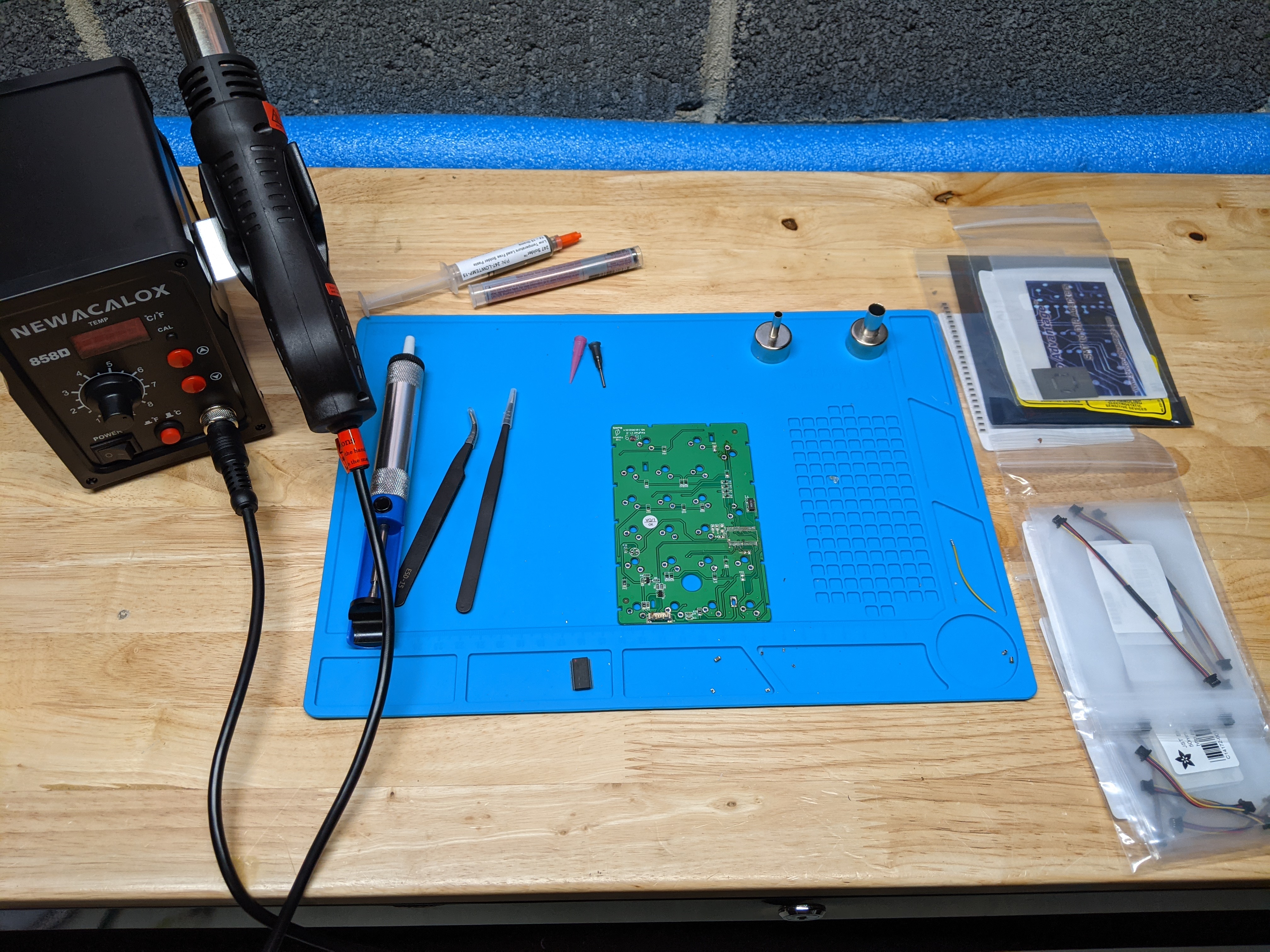

Arrived yesterday

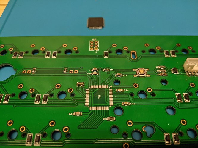

Initial impressions are good. Handle is a bit bigger then I thought it would be. The accessories are generic cheap but work in a pinch. I was able to desolder an MCU successfully took about 10 minutes to get the chip off at 360 degrees and clean up the solder with a wick. Not bad for my first usage of this type of soldering station. Hopefully soldering the chip on with a stencil and some paste goes smoothly.
