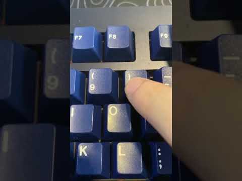

I have had instances of ticking on switches such as:
Raeds, Tangerines, OPblacks, and most recently the Epsilons. Not to mention plenty of tactile switches usually have this too.
Here’s an example of Raeds ticking:
