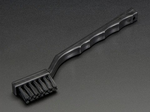

I use isopropyl and one of these:
Seems sold out now, but you may be able to find it on Amazon.
I use Kimwipes to help dry it.
