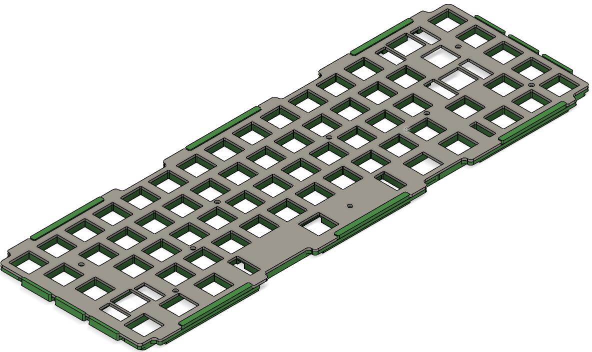

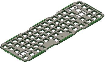

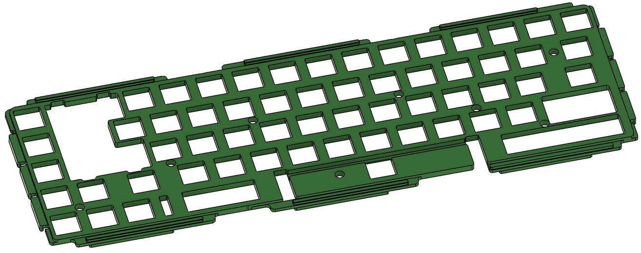

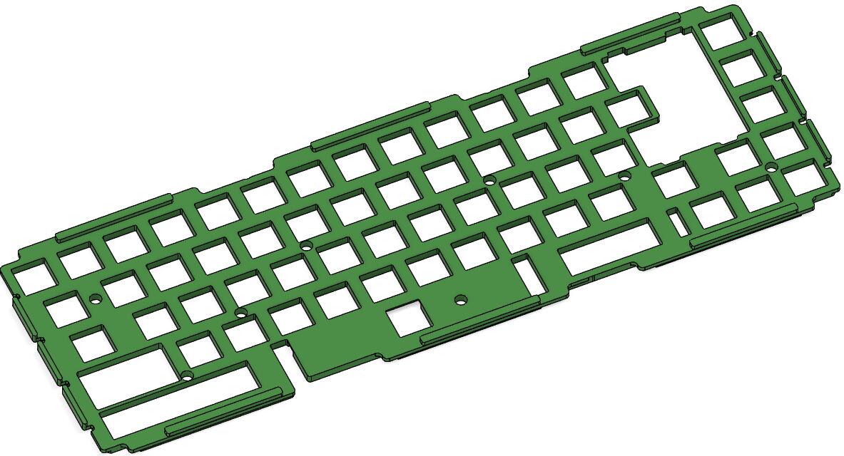

What might be challenging is something like KBDFans’ combination “gasket” / mute pad.

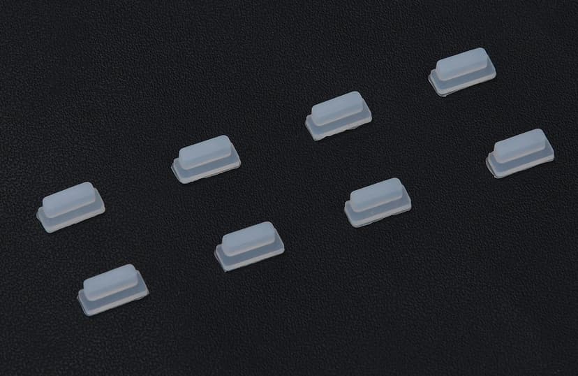

It acts as dampening between the plate and pcb, but is also the part interfacing with the case and holding the assembly to it. (I think the word “gasket” probably isn’t the right one here, but I don’t really have a better alternative.) It’s like your typical sandwich filler, except it has tabs coming out on all four sides that get sandwiched between the case halves. They have sort of slots in the case they fit into. It’s also intended to be paired with 8 little shaped silicone “top gasket” pads.
Quite possible to reproduce I’m sure - but more challenging than just a few strips or even a mute filler, if only because of the fairly precise shape the… interface tabs?.. need to be.

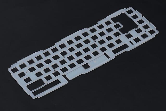

How long do you think this silicone piece will last?
I feel like it should last a good while as long as it isn’t exposed to any chemicals that would help break it down. If it’s anything like silicone cookware or sealant, it should last a good decade or two before it starts to become compromised. From what I read, even leaving it in the sun is okay (still wouldn’t recommend it). My KBD67 Lite R1’s silicone looks exactly like it did on day one - and while the silicone in my Portico has gone tan colored, it doesn’t appear to be any less flexible or supple.

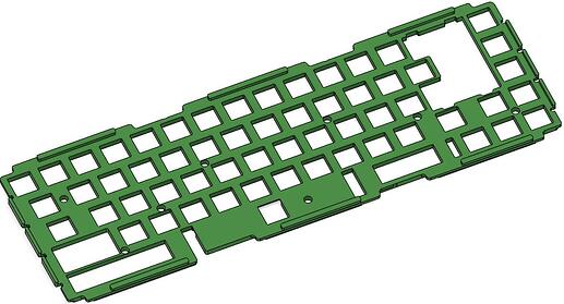

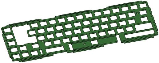

This remind me KBDFans actually released the plate and silicone files.
Worst case scenario if the silicone would start to degrade before the KBD67L becomes irrelevant, people would have the 3D model to create molds or have 3rd party make new silicone.
