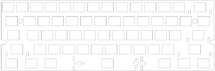

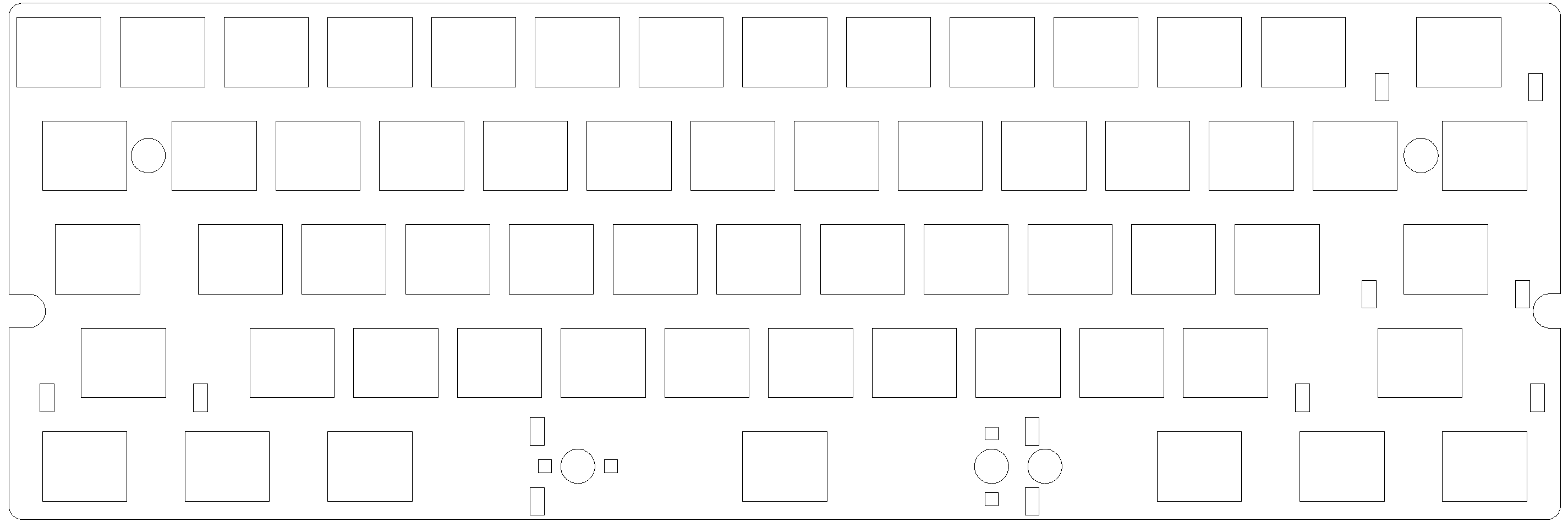

Their price on ebay is not very stable. I don’t know how to get one in reasonable price. After market key caps are nice, but the extra stablizier piece in the space is pretty unique to AEK keyboards.
Wow cool, thanks Hasu! Just to clarify, do the lines in your drawing following the lines of the desired cutout or are they adjusted for kerf in any way? My laser cutter offsets their laser’s path for kerf automatically so I just want to make sure the new drawing is not already adjust for kerf.
As far as eBay is concerned, a lot of it is just patience – most get posted in the $50 to $120 range, but once in a blue moon, someone posts something in the $20 to $40 range (although sometimes it comes with shipping costs higher than the price the listing price of the board) …
Give it 24 hours or so, Discourse puts everyone into newbie status when you initially sign up – and PM manofinterests while you’re at it to get yourself verified …
The file was designed without any concern for kerf, so lines shows exact dimensions to be cut in the result.
