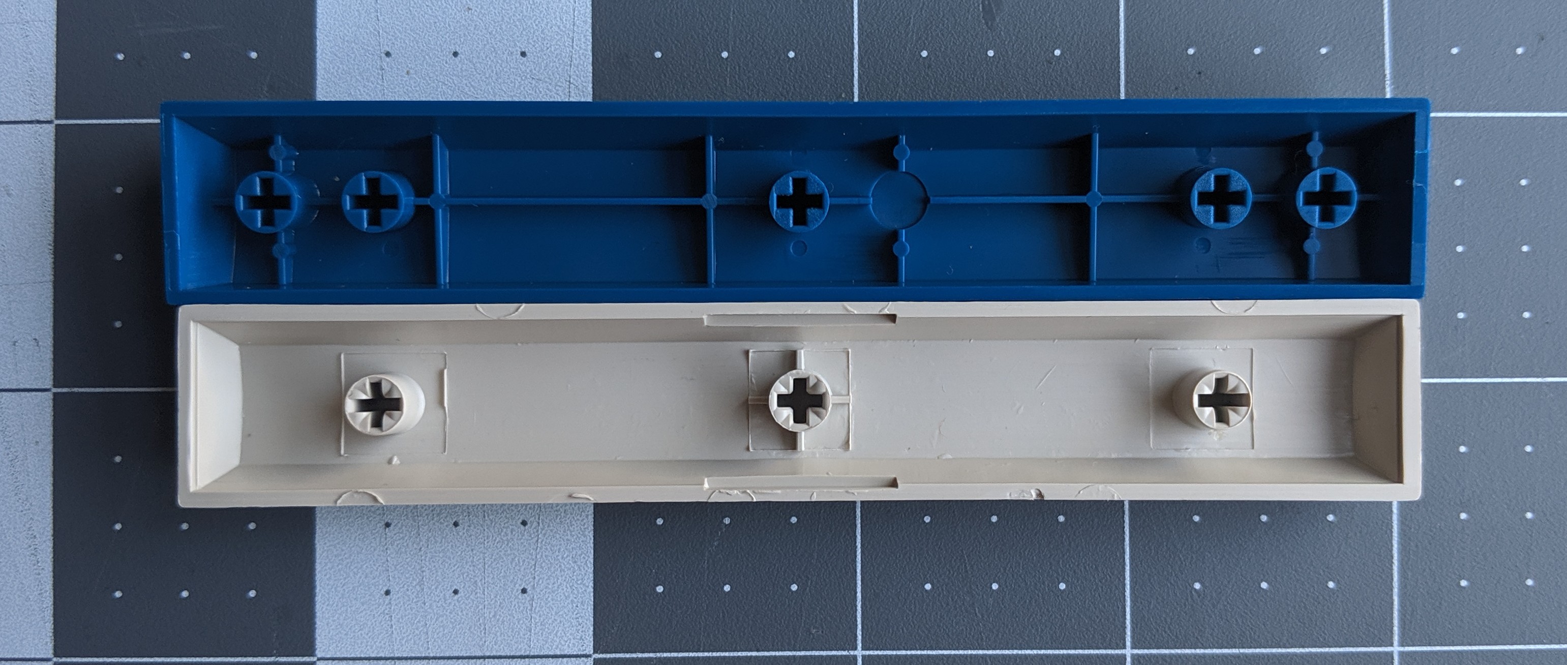

Here is what they have to say about their DSS stabilizer placement.
spacing is fixed at 1.50 inches from the center mount to the outboard mounts
Is that what you’re looking for, or is it the same issue as on their older kits that you mentioned?

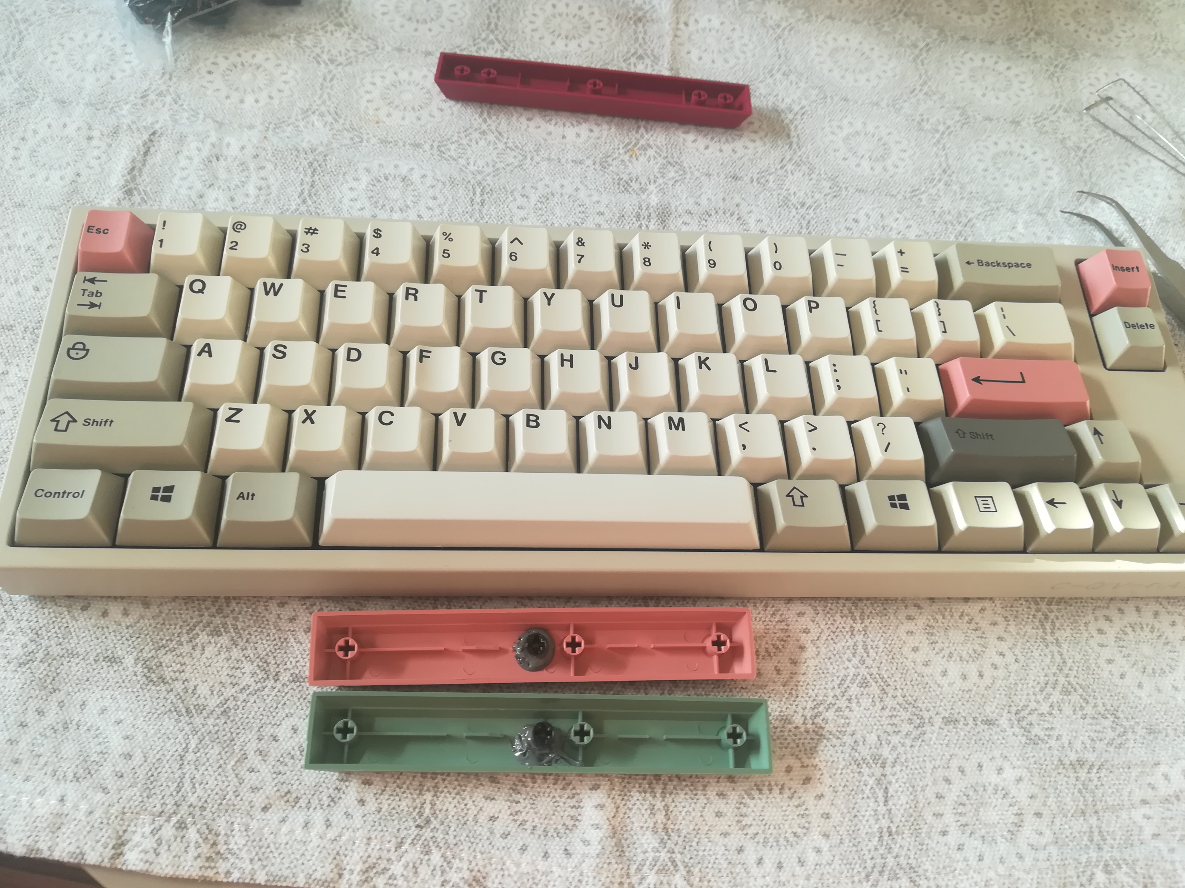

That is the same as their older kits, like alchemy. Those 6u bars do not fit the fc660c or any other board I know of, not sure why they use it. Cherry has stabilizers on their centered stem 6u at that measurement (38mm) and at 47.7mm, the 660c uses the outermost mounts.
At this point I don’t really sweat about the alignment as I jigged a lot of 6u off centered spacebars to fit my fc660c / 980c .
But yea, proper spacebar from the factory is desired.
Hmm. This is a touch choice. Given that the spacebar isn’t very compatible, do you think it’s still worth doing? Asking folks to glue in their own stems is probably a bit much, and advertising a 6u spacebar that people can’t use out of the box might just be confusing or lead to disappointment. @Nebulant: what do you think?
With high quality topre to MX sliders that don’t rotate caps being quite rare, I don’t think the market of people looking to use this set on converted boards will be that large.
The best way would be to get SP to do a proper spacebar, and add the side feet+ center+ off center as well as GMK / Epbt spacebars have
