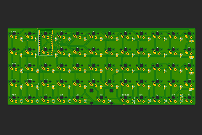

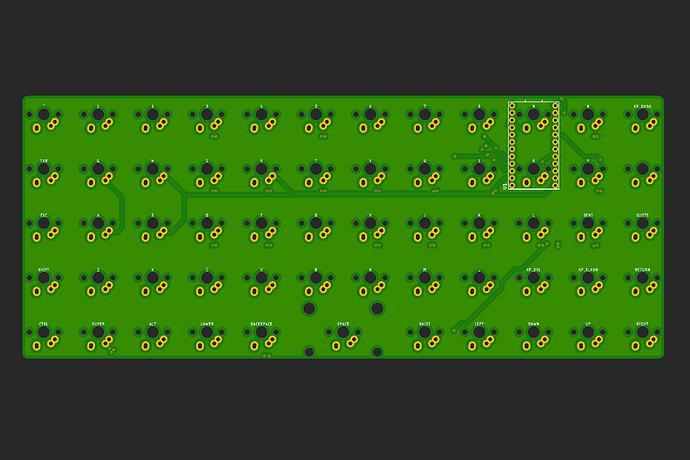

Hi! I run the shop KeyPCB, where I make PCBs for people. This is my first time doing a group buy/interest check. Luckily, this is fairly simple, so there shouldn’t be too many problems.
The Conic keyboard has a layout inspired by keyboards such as Preonic and JJ50. It aims to deliver a good quality but affordable keyboard. The target price is around 15-20 dollars for the PCB. It supports Alps and MX switches and uses a Pro Micro as the controller.
The group buy will start once I hit 20 people interested, but I might do it anyway even if there are less people, there might just not be as many options.
Here are some pictures of the PCB:

Any chance for two 2u keys for spacebars?
Thanks for letting me know. I tried to choose a name that was different enough from the preonic’s name, but now that I look back on it, I can see the similarity. Would I be able to say in the group buy that this was formerly called Conic so people who did the interest check could see that this is the product they said they were interested in?
I’ll try to add that, I’m not sure how easy it will be since I already designed the PCB.

Also, sorry forgot to comment on the board! I’m not an ortho user personally but an affordable ortho PCB at an unconventional form factor seems like a great idea, good work.

Though, I know you’ve said you have it already designed, but … I have a couple of recommendations here:
  • Break out C6 (if you’re not using it), or another unused pin for audio
  • Break out pins for VCC and GND (related to the next item)
  • Break out pins for RGB Underglow
  • Break out the ISP pins, so that one can easily ISP flash the controller (because Pro Micros are SUPER easy to brick)
Yeah, in addition to C6 (or C4/5 I think), if you can break out B5/6/7 you can get dual channel audio!
Haha, yeah, didn’t think of the dual channel! :smiley:
And yeah, C4/C5/C6 and B5/B6/B7.
