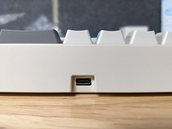

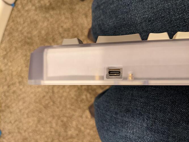

Did you have to widen the Heavy-6 USB cutout to accommodate the USB-C port?
Put me down as a most likely.
Yes, but it was really easy with a small, round file. You can buy whole sets of them for less than $10 usually.
Okay cool. And no issues with cracking or anything? I know PC is less likely to crack than Acrylic, but it still freaks me out.
It was a tight fit, but I managed to use USB-C in the H6 without modifying the cutout. Ymmv. But it should be fine to file down, just take small bites and it’ll go quickly.
No, no cracking. Just go slow, no power tools needed or advised.
fwiw my experience
Heavy 6 Polycarb (I did NOT have to modify the opening)
Not sure about the metal version, I do not have one. Try sticking a usb-c cable in the usb hole to see if it fits.
Leopold Stock case: Required slight filing
