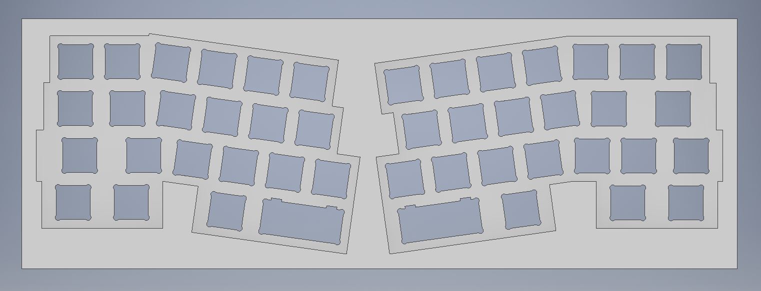

So as I suspected it just doesnāt really work having the option for 2u backspace and split backspace AND have kailh hotswap. So a decision needs to be made. Right now Iām leaning towards getting rid of 2u backspace in favor of hotswap. But I would love to hear some thoughts from others.
At the smaller size Iād prefer 1u over 2u delete. Gives more flexibility with punctuation.
I think ditching the 2u backspace is a logical move. I personally would do split backspace if I were building one of these to maximize the smaller layout. So ditching the 2u option to keep hotswap makes sense to me.
Iād say definitely get rid of the 2u backspace, just makes it a PITA for people with sculpted sets and with small boards itās nice to have more keys. Iām really liking where this is going, and I think this might be my next keyboard. And also thanks for making this a hotswappable pcb. I honestly am always too afraid Iāll fuck up soldering which is why I avoid most high end boards. I put a good amount of money into my last build ($275 at least) and fucked up the soldering in multiple ways lol. I just canāt trust myself anymore with soldering expensive keyboards.
IMO definitely remove the 2u - the additional key is useful and also improves compatibility for people who donāt want to use non-sculpted key caps on it. and like what cijanzen said about the space bars - those would probably work best if you have keycap sizes that match shift keys
totally agree
2u backspace is no longer a thing (dont worry this is still rough. This is just to show layout).
I hear what yall are saying about standard shift key sizes for the spacebars. And it makes sense to a point. I REALLY donāt like 2.75u spacebars on a 40%. Though on this one it might not be so bad as it would make the blockers about the same size, which just occured to me. LOL. I was about to type 2.0/2.25 for sure but now I donāt know.
Iāll play around with it. My reasoning for 2.0/2.25 over a 2.75 (other than the fact I donāt like 2.75) is with darn near any GMK set youāre going to be buying a 40% kit if itās available anyway. The other modifiers will demand it. Any 40% kit/spacebar kit that doesnāt have 2.0/2.25 spacebars is doing it wrong.
im okay with 2.0/2.25!
Iām good with 2.25 as well. At this point I usually buy the spacebars kits which usually have them cause I never know what Iāll end up with!
