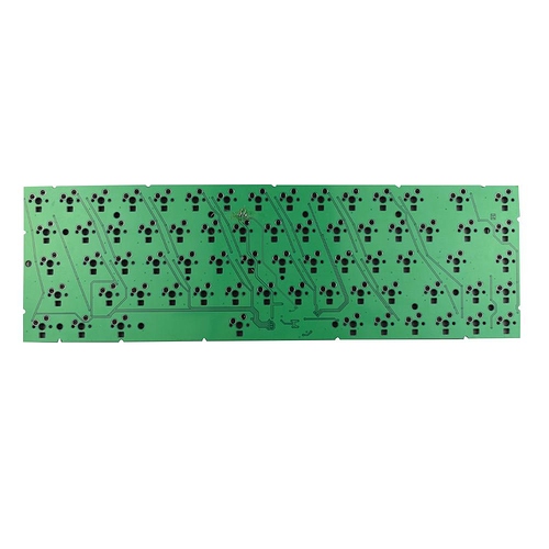

I believe the design uses a plate meant for the NiZ slider/housings.
This looks like a custom HHKB PCB/plate/switch no? Or is this what the actual HHKB looks like inside?
HHKB doesn’t have a removable plate. The plate and upper half of housing are one piece of injection molded ABS.
They might be using the PCB only but are replacing everything else.
They could be working with NIZ for the PCB too. They recently ran a DiY kit. Kinda sad I didn’t go in on it, but I’m holding out for a Norbauer :slight_smile:
