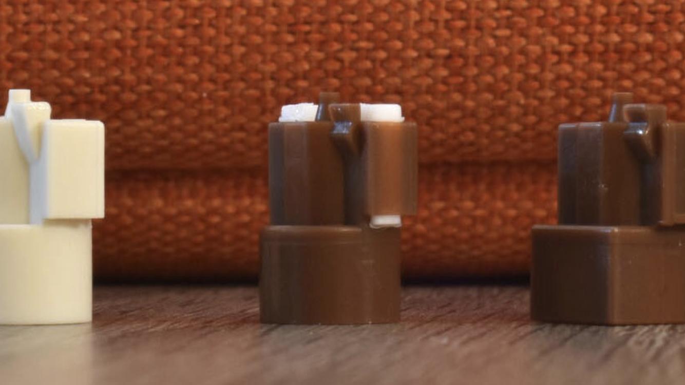

Personally I consider Bobagums quite mushy - but that’s also how they’re so whisper-quiet - those pads are thin and soft. The Kailh BOX Silent pads, on the other hand, are large, broad, and firm (and located in the stem).
Not the most descriptive angle but this is a photo I already happen to have; the stem with the white pads is a Silent BOX Brown, which has the same pads as the Silent BOX Pink - which I think has the same pads as the Deep Sea and Fried Egg. Their footprint is much larger than any other (mx-compatible) silent I know of right now.
Edit: different design - the dampening is indeed in the housings, top and bottom.

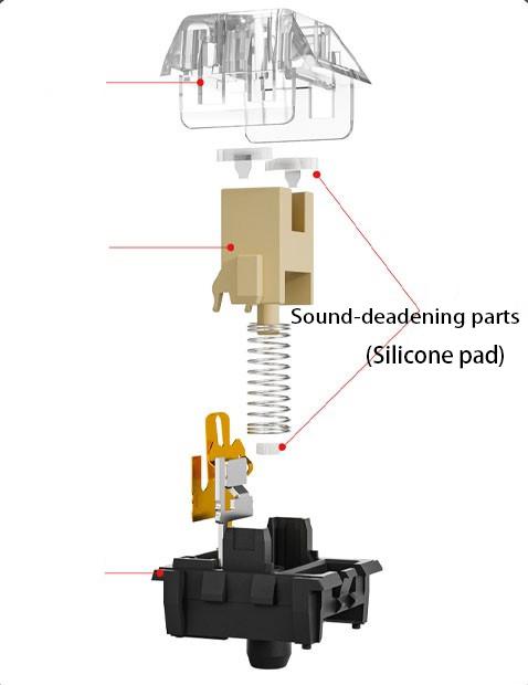

I watched a vid on the deep seas, and based on what I saw in that and the description this poster gave the silencing pads seem to be located on the rails of the top housing and the entire floor of the bottom. Just my guess, but I feel like this would give a more muted and silence sound as the sound would have to travel through the silicone(or whatever material it may be) similar to the pe foam mod.

Found a photo that confirms this on kprepublic - the silicone dampening is indeed part of the housing. I’m interested in these now…
Thats what I thought. Also the stem appears to not have dampening, correct me if Im wrong, so the kailh box round stem frankenswitching possibles are quite interesting. Kailh box silent pinks + this might be “interesting”, lots of silencing. Also kailh box creams could be cool if they act anything like normal kailhs in other switches, although they would not have pole bottom outs.
Edit: Looking at the kailh website page on this switch, the stem and housings are polished. However it doesn’t say anything about materials which is kinda a bummer.
