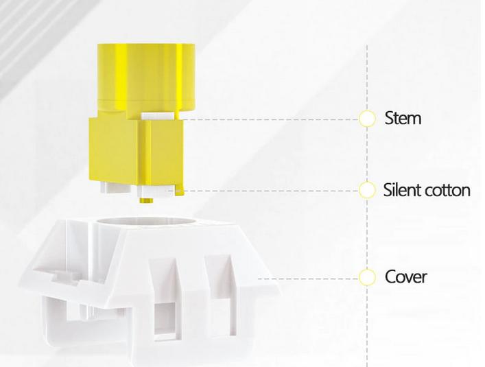

I read an account of Kailh Deep Sea today elsewhere:
I ordered some mods parts as listed below as well as a set of Kailh Deepsea switches. These are a variant of the Kailh Silent Box Pinks that has the dampening material integrated into the switch housing rather than into the stem. These are the same noise level, but the Deepseas feel smoother (unlubed/filmed) than the Pinks. I’ll be keeping the pinks in my GMMK and will lube/film them when the parts arrive.
So we recently got these in stock (switchcaptain.com, sorry for the shill :flushed:). I’ve been a bit delayed on a teardown and typing test, which we generally do for new switches, but they’re coming soon and I’ll share them.
Dampened is definitely a good way to describe them. They have a different “silencing” mechanism than most of Kailh’s silent switches, as noted above, with the silencing on the side of the housing as well as the floor. They have a really nice and pleasant, muted sound to them as a result.In terms of feel, they are definitely not mushy.

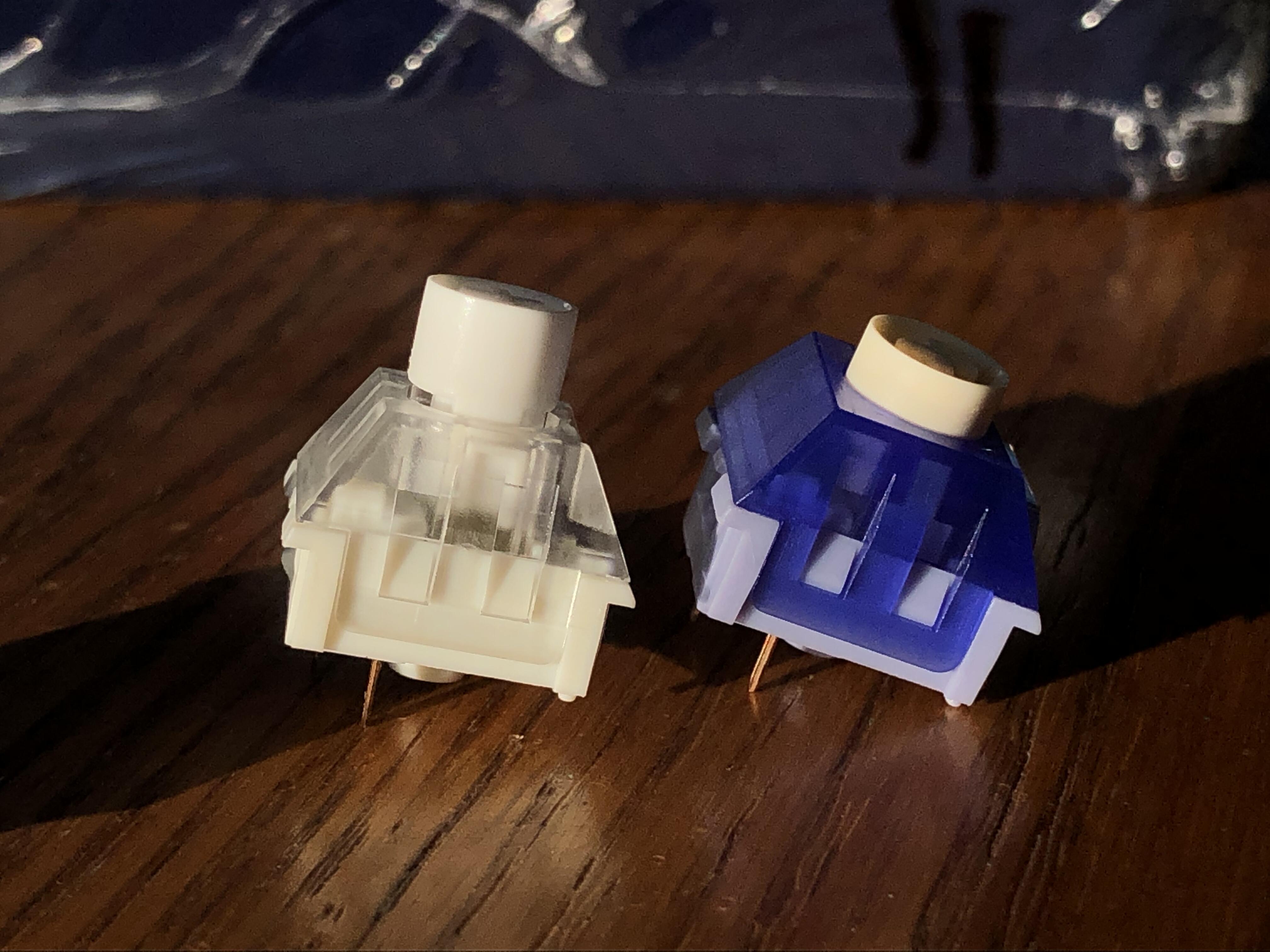

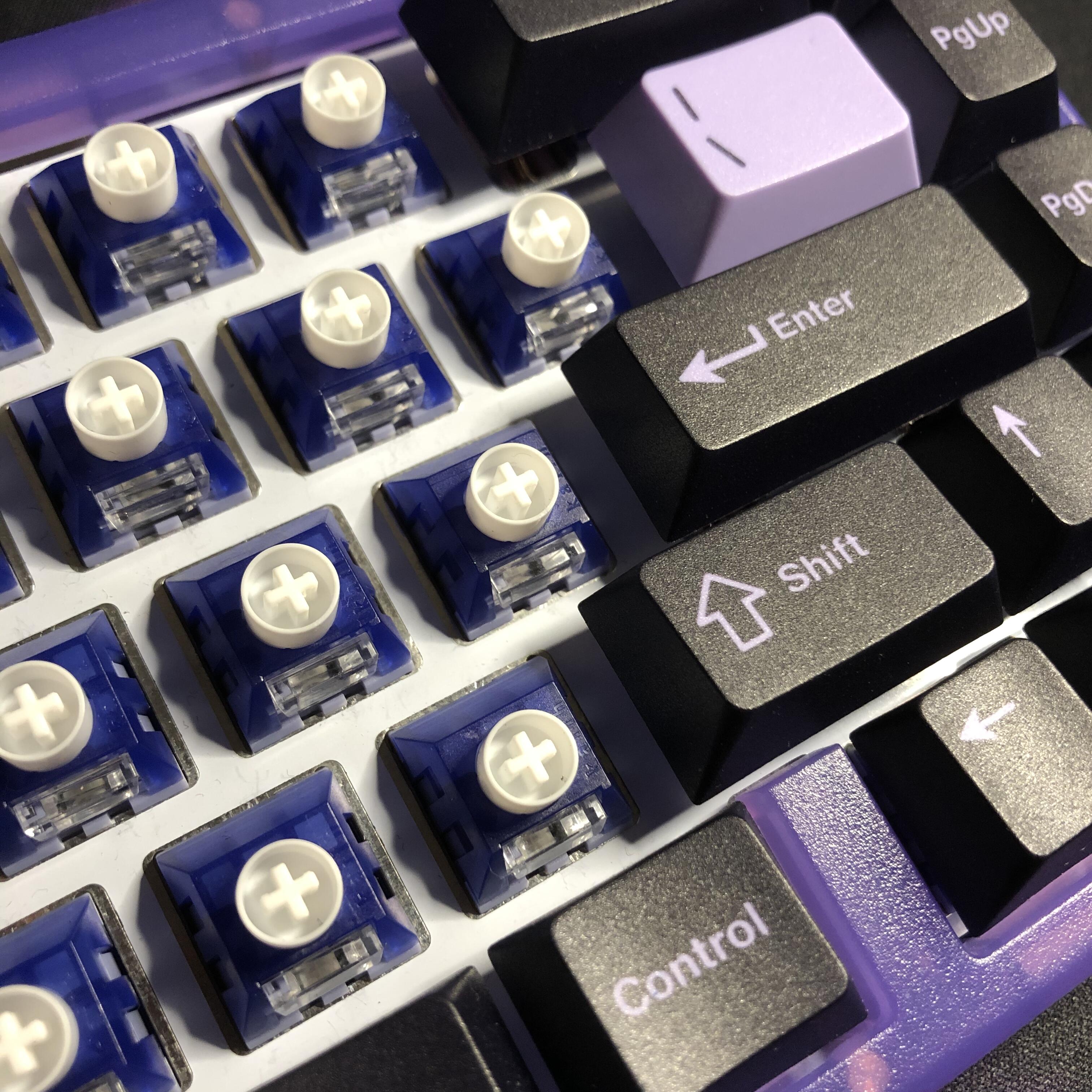

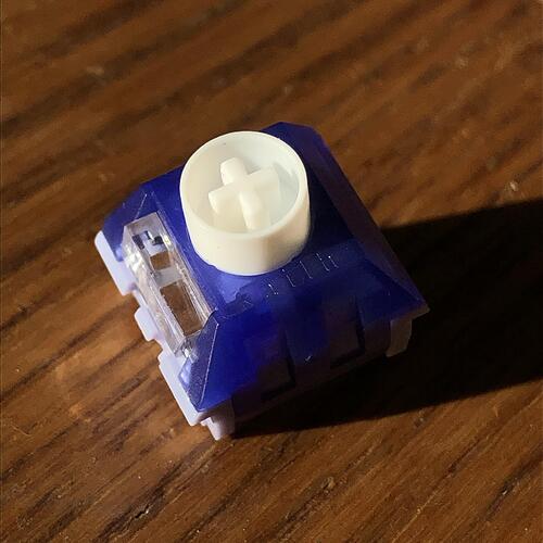

Starting with a complete switch:
I love these interference-free housings, especially for modding commercial boards. The light-pipe doesn’t interfere with any keys in either orientation, but it’s still optional.

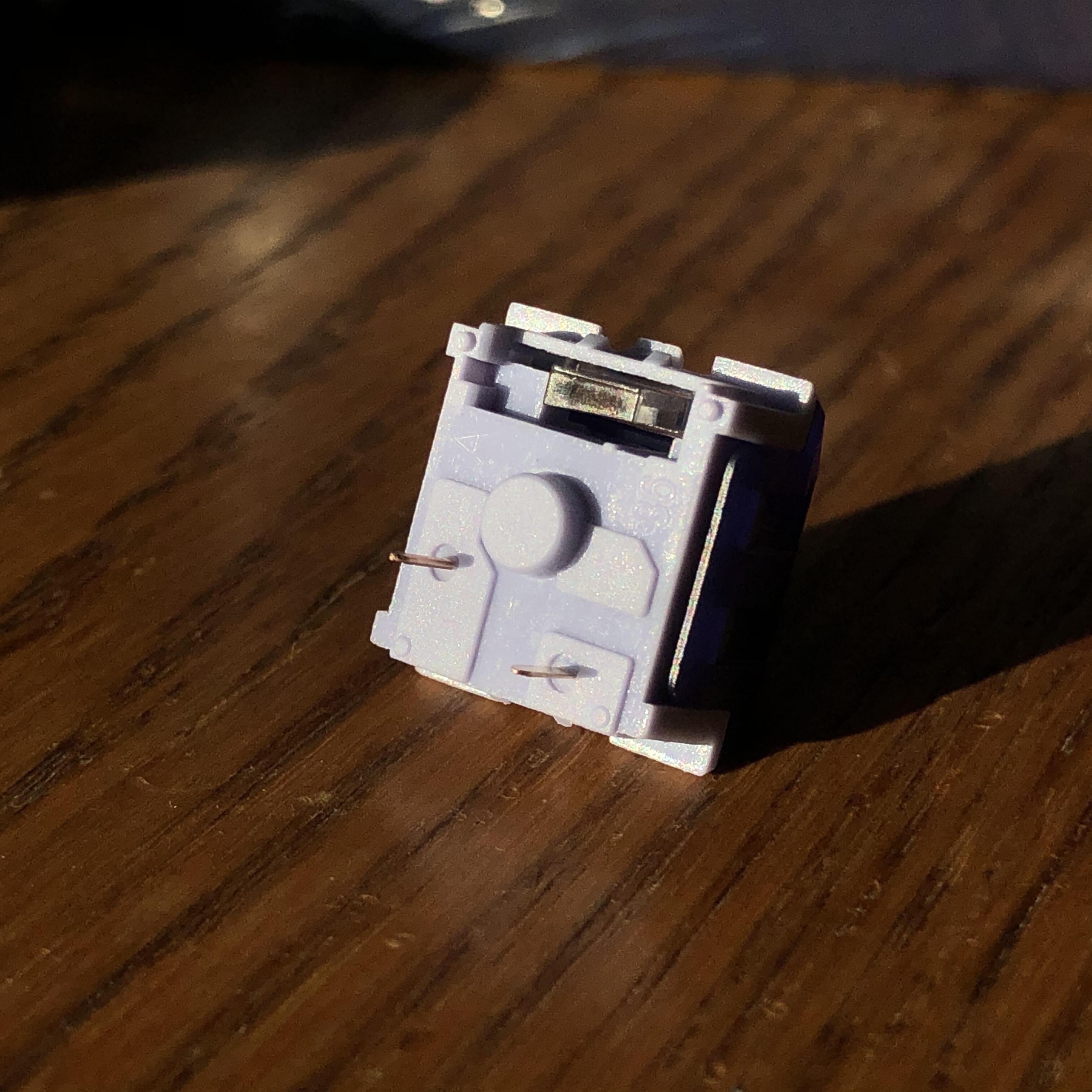

The bottom:
I wouldn’t mind seeing a 5-pin version, but this does make the switch easier to install in aforementioned commercial boards, and any given hot-swap.

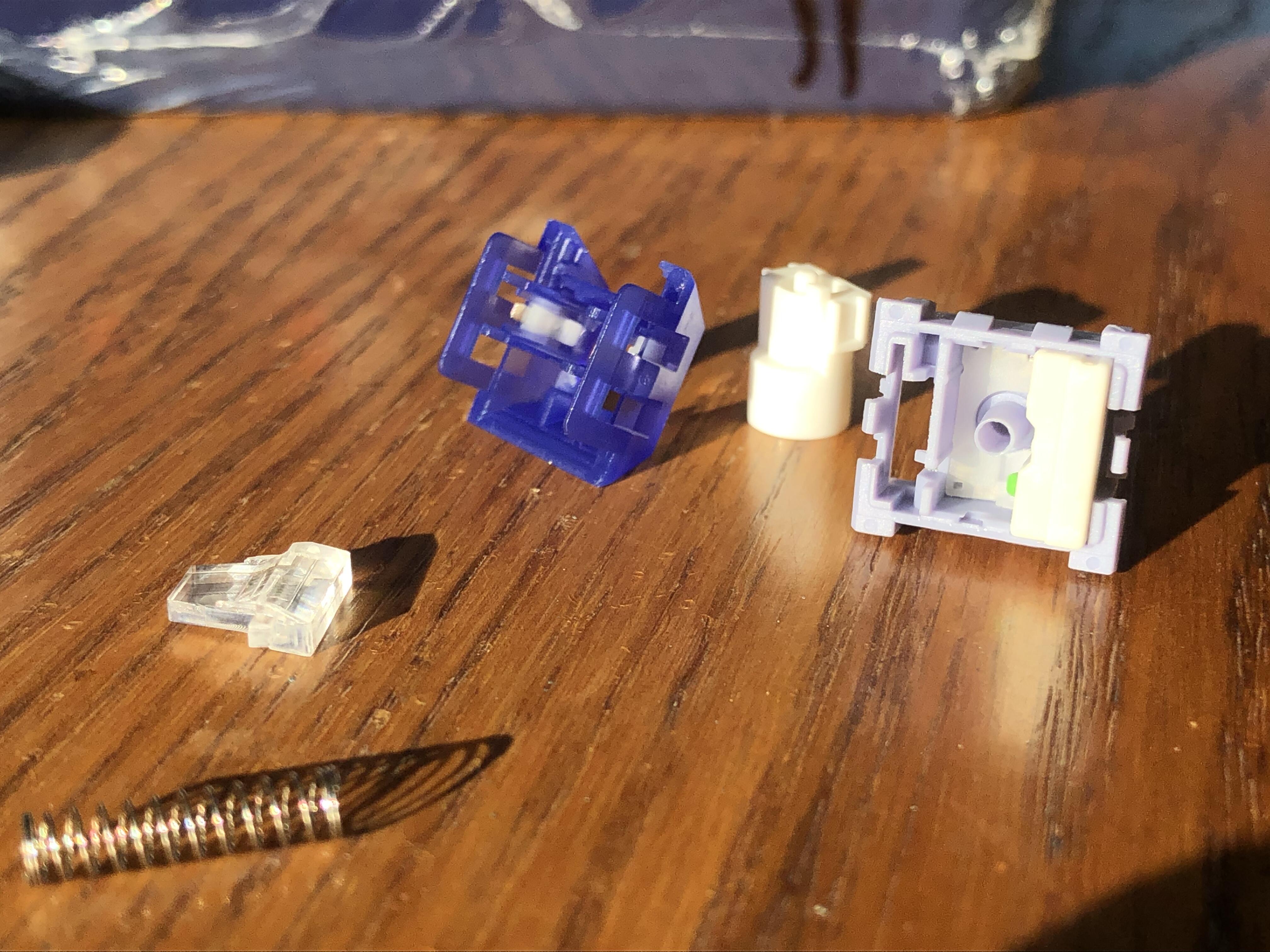

S’ploded:
A little over-exposure never hurt anybody.

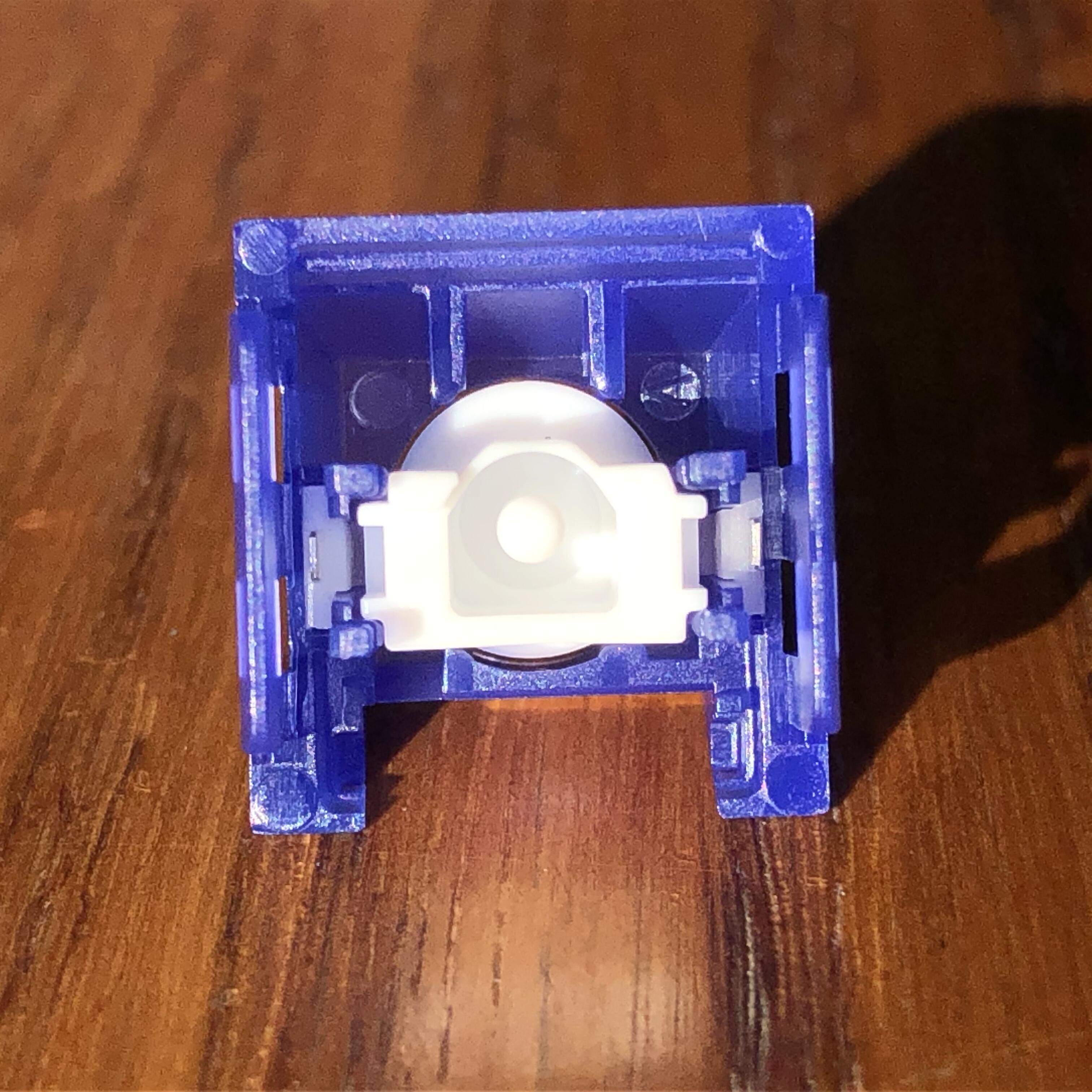

The stem and top housing together from below:
More on the stems in a bit.

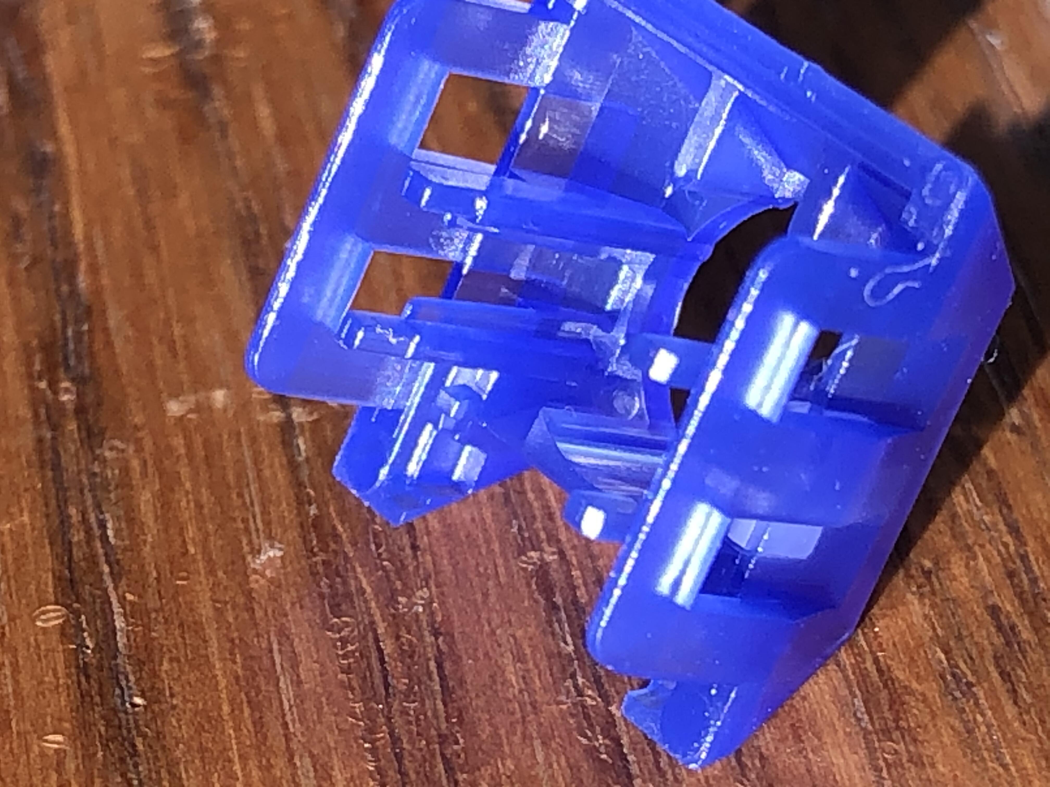

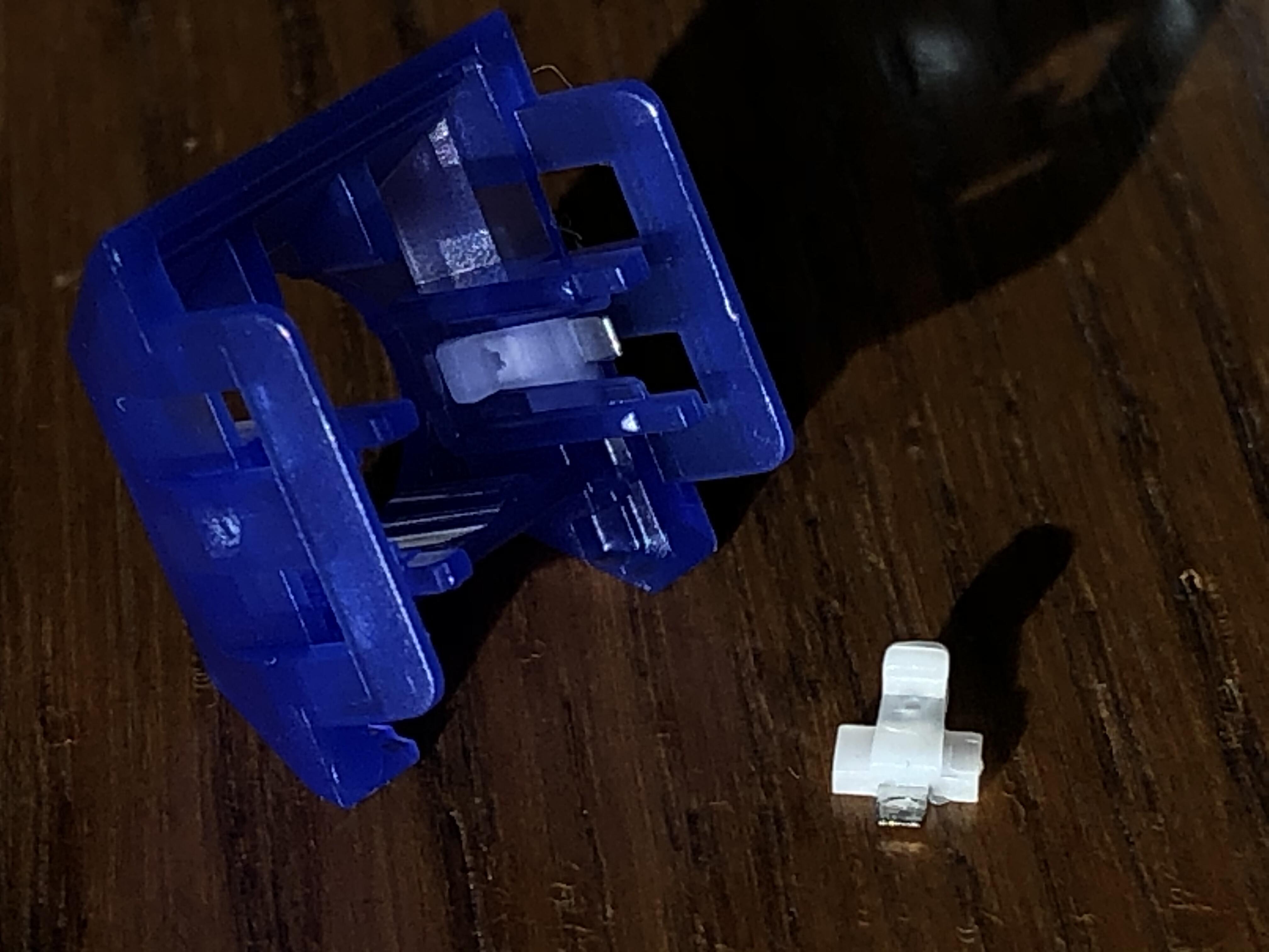

A closer look at a dampener in the top housing:
Yep, that’s metal. The “business end” of the dampener is the little rectangle that sticks-out towards the middle of the switch, but there’s a lot of other stuff going on with its overall shape to keep it in place and presumably facilitate installation.
Now without the dampener:
These are based on the existing cylinder-shroud BOX tops, but have new details to accommodate the dampeners and light-pipe.

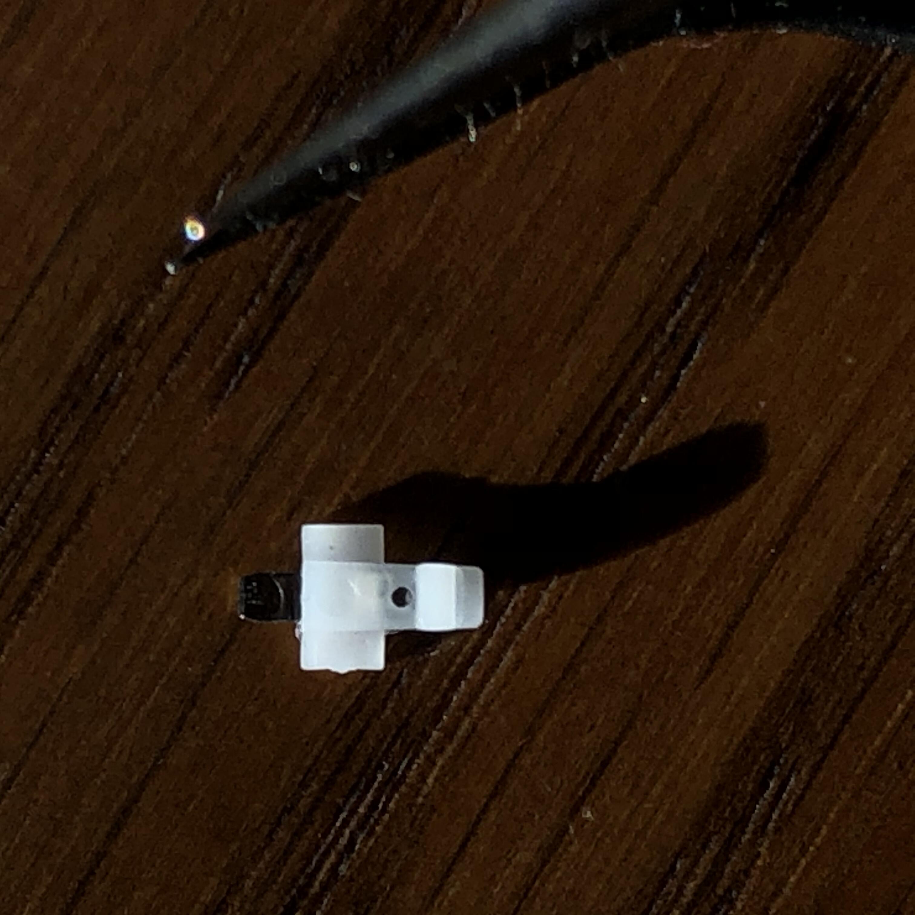

A look at the other side, and a removed top dampener:
I think the metal bit is actually pretty brilliant. It provides support for installation and in general while presumably allowing for whatever softness or hardness of dampener to be used reliably.

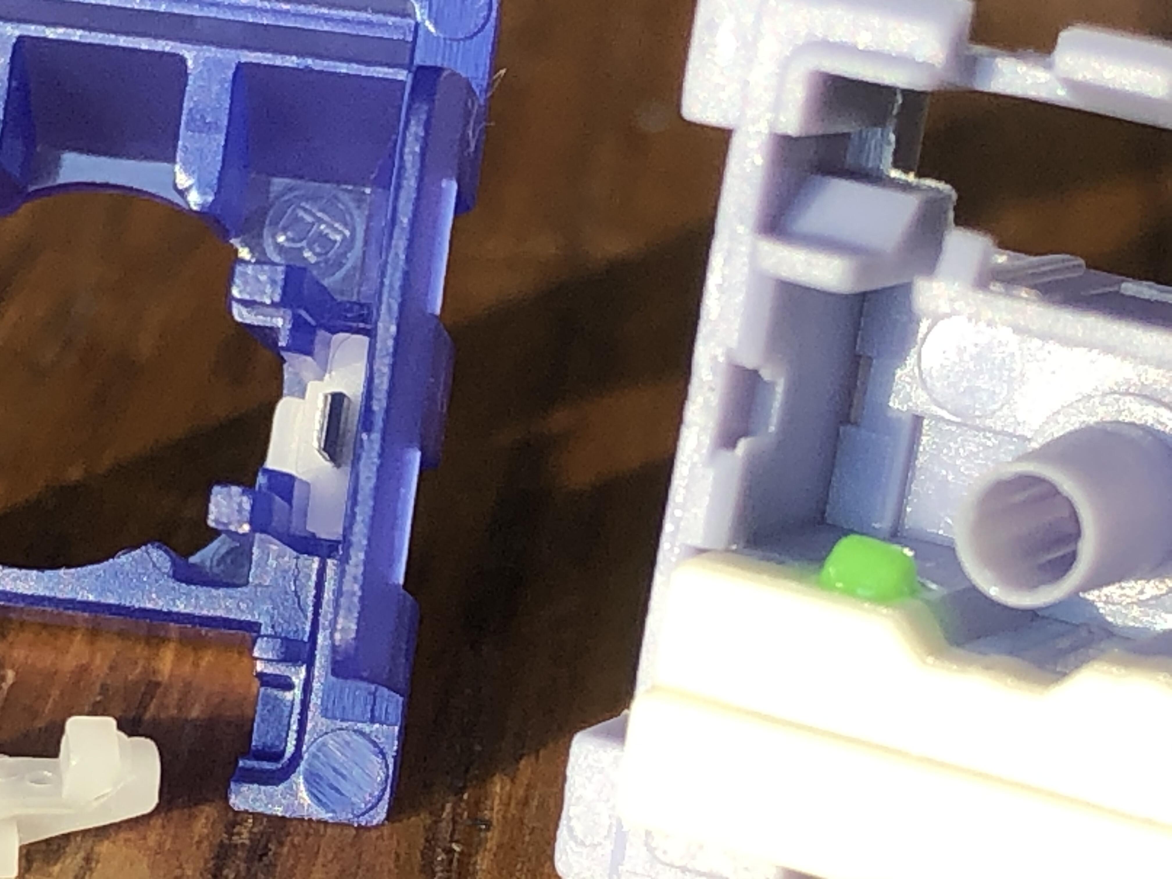

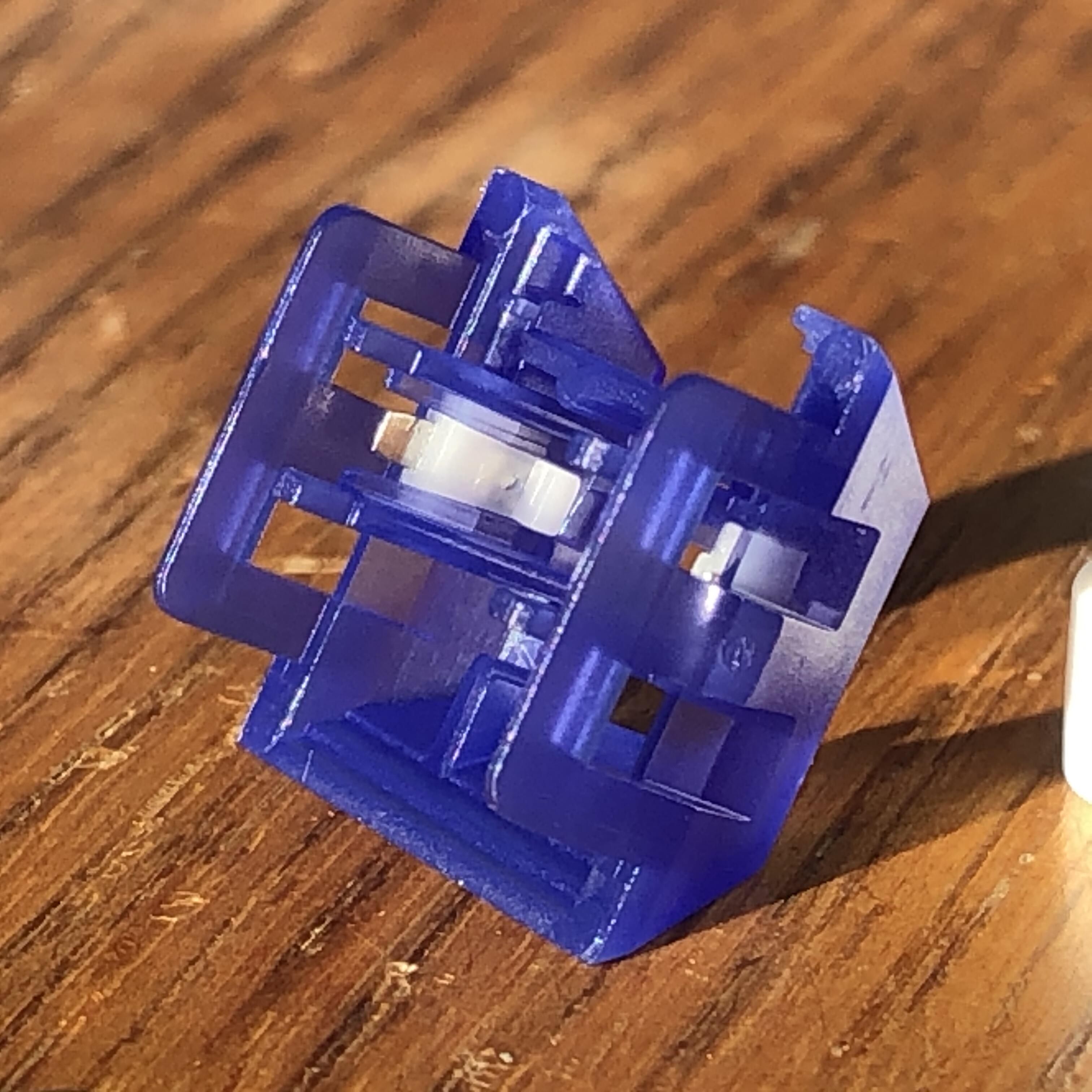

Alright - transitioning to the bottom housing, check out this new detail where the top dampeners’ metal tabs slot-in:
You can also see the divot on the top housing that holds down one side of the light-pipe, as well as a side view of part of a top dampener.

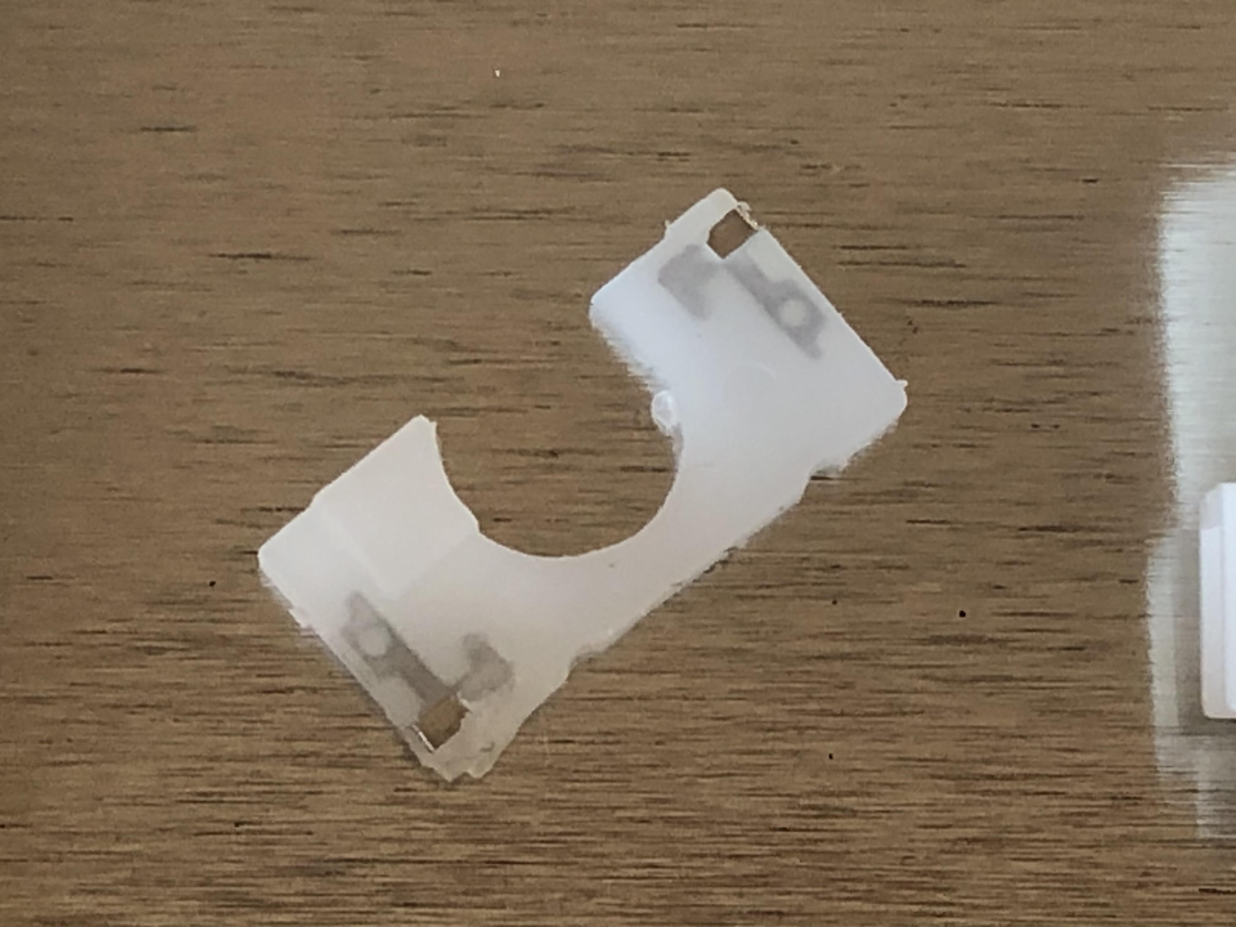

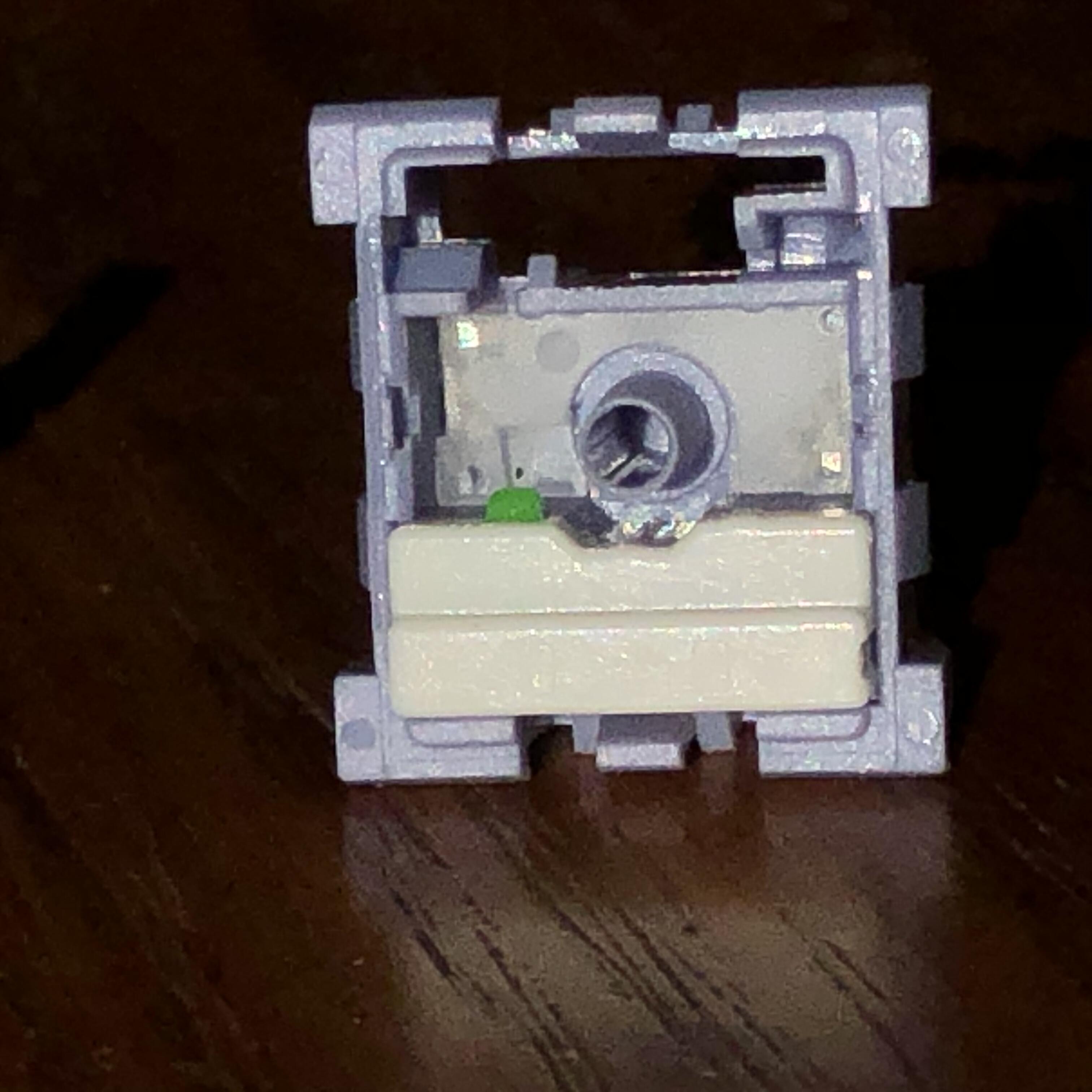

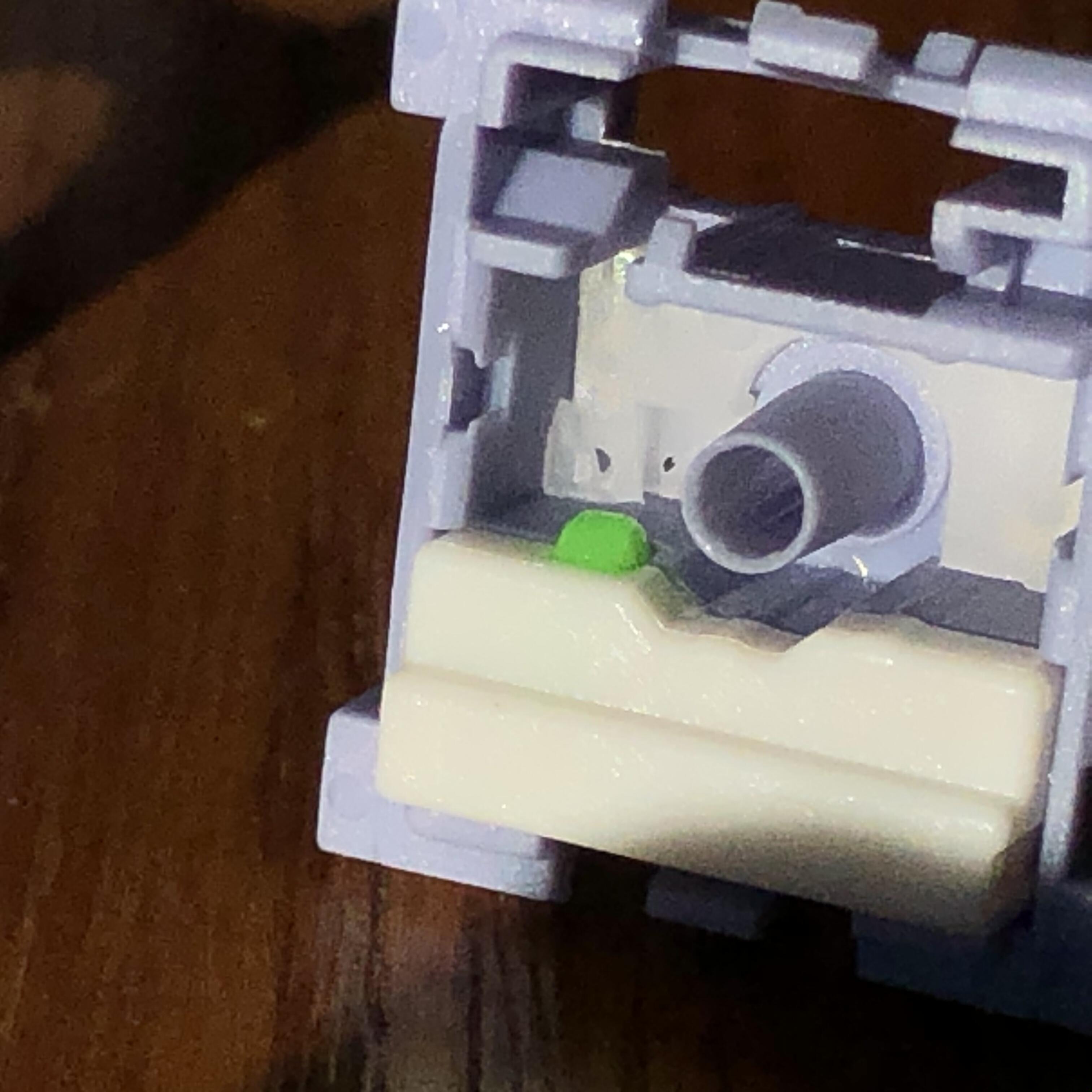

A couple angles of the bottom housing with its dampener:
That geometry on the left there is shaped to the stem, presumably for uniform contact.
There’s metal in these, too.

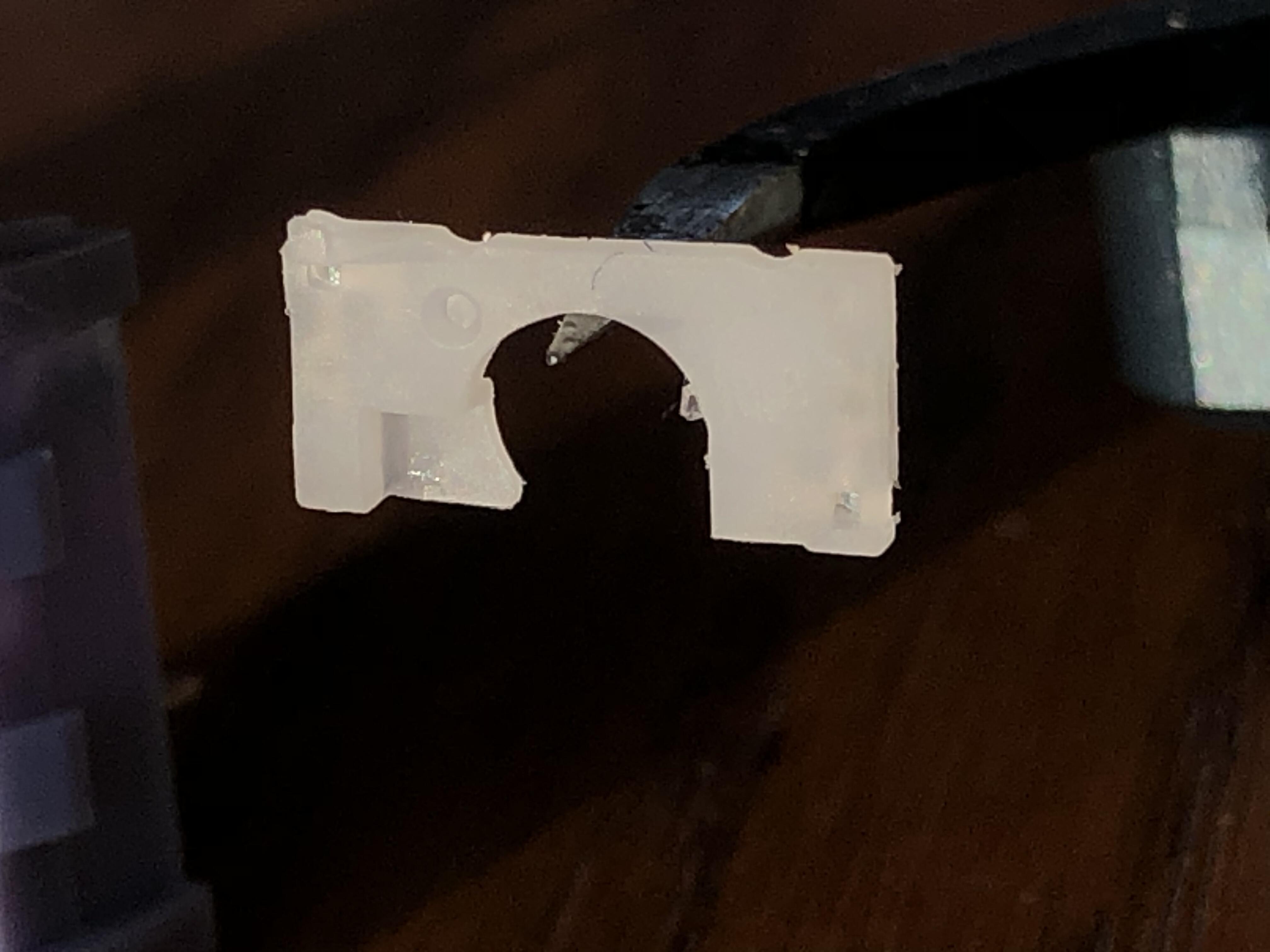

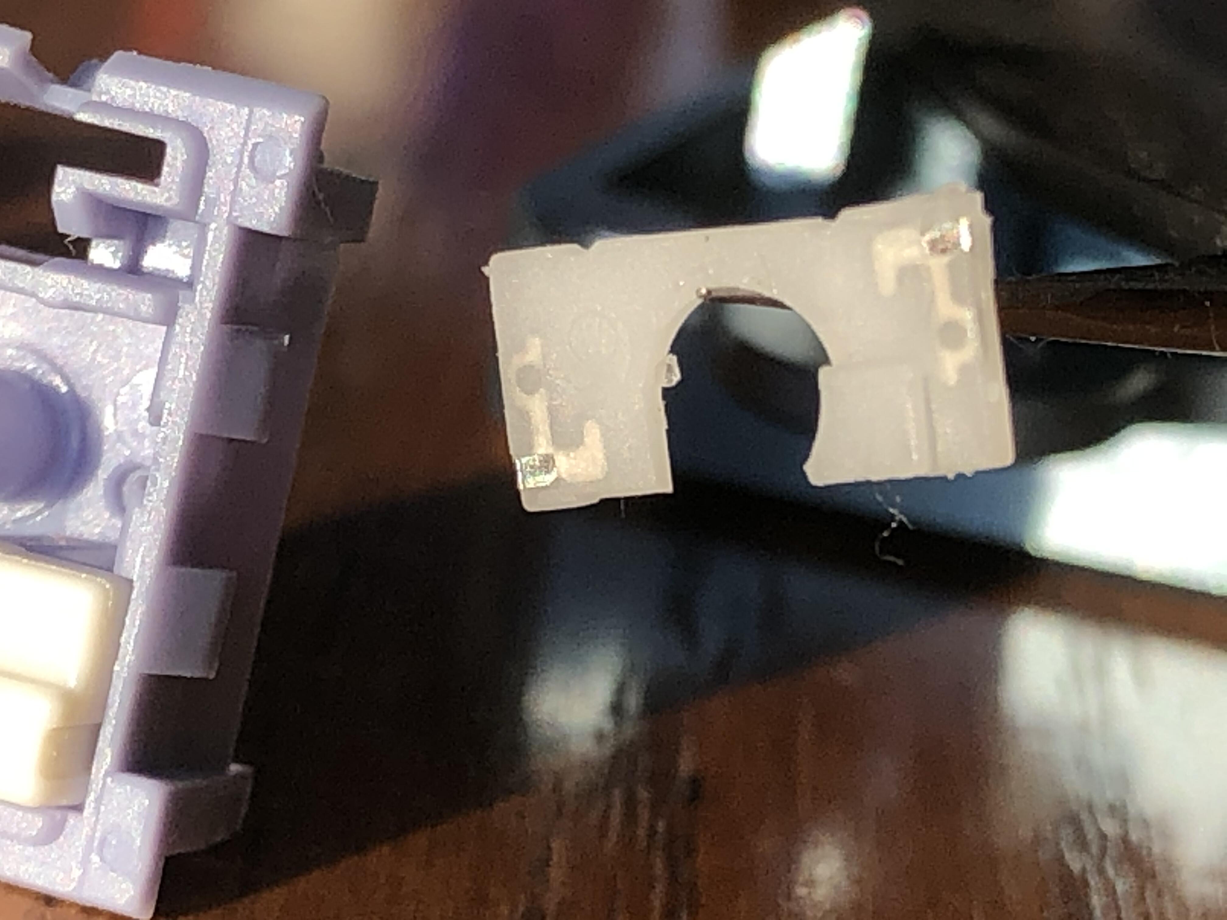

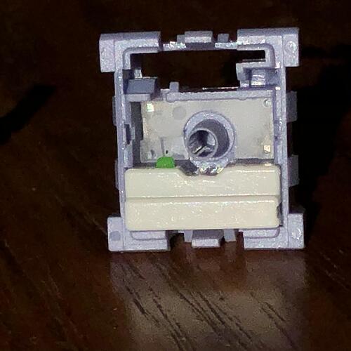

The bottom dampener removed:
And the other side:
Thanks to the setting sun’s light, you can see the shape of the metal parts, as well as the dust fibers clinging to… everything. I’m guessing these are also for structure but there may be other utility to their presence.
Another angle of the bottom dampener:
It’s pretty easy to remove and re-install, unlike many other dampening systems.

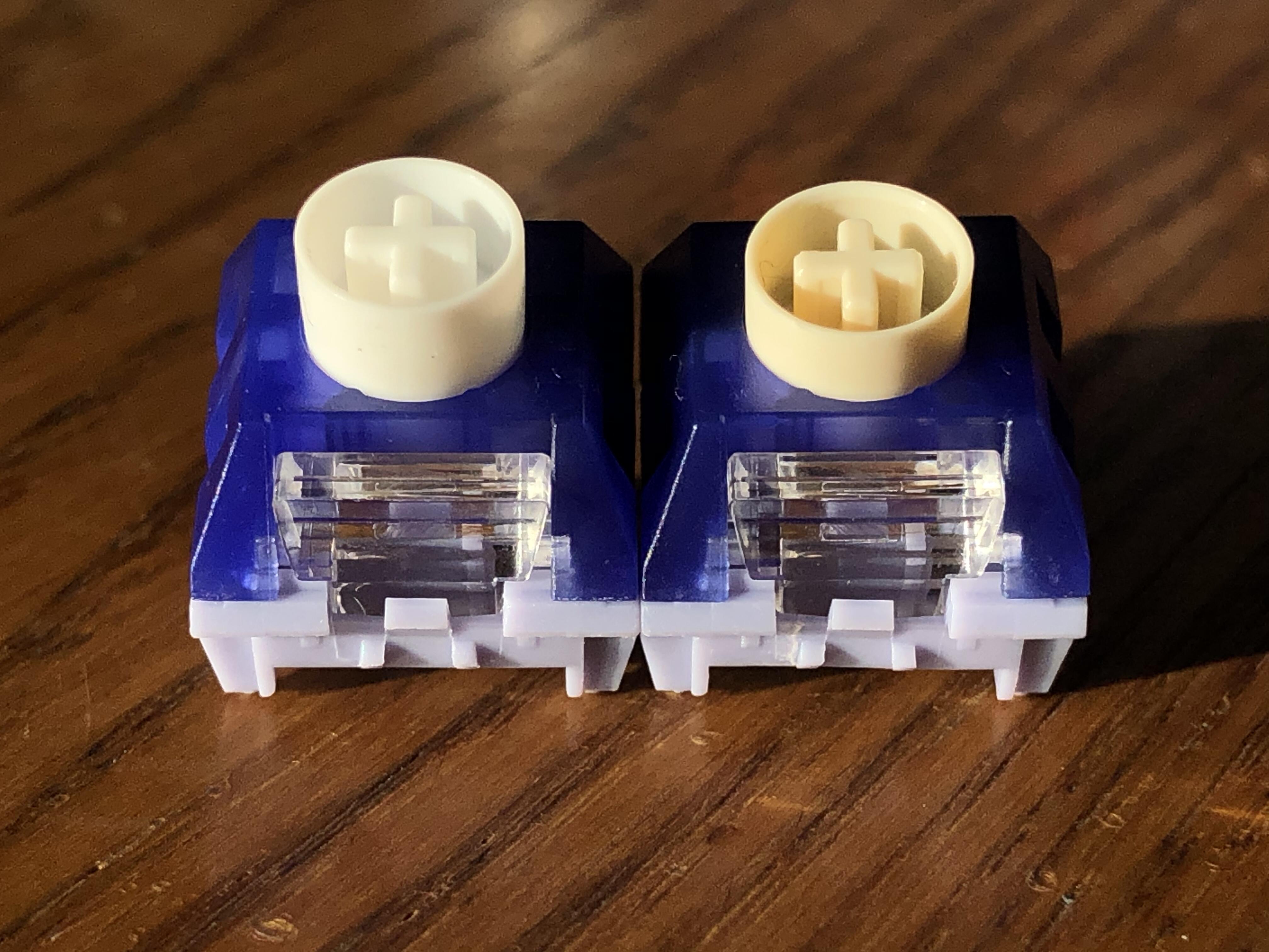

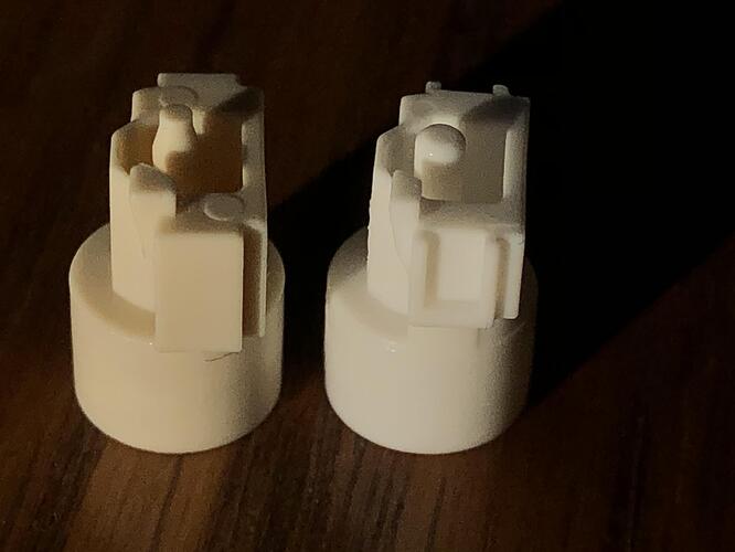

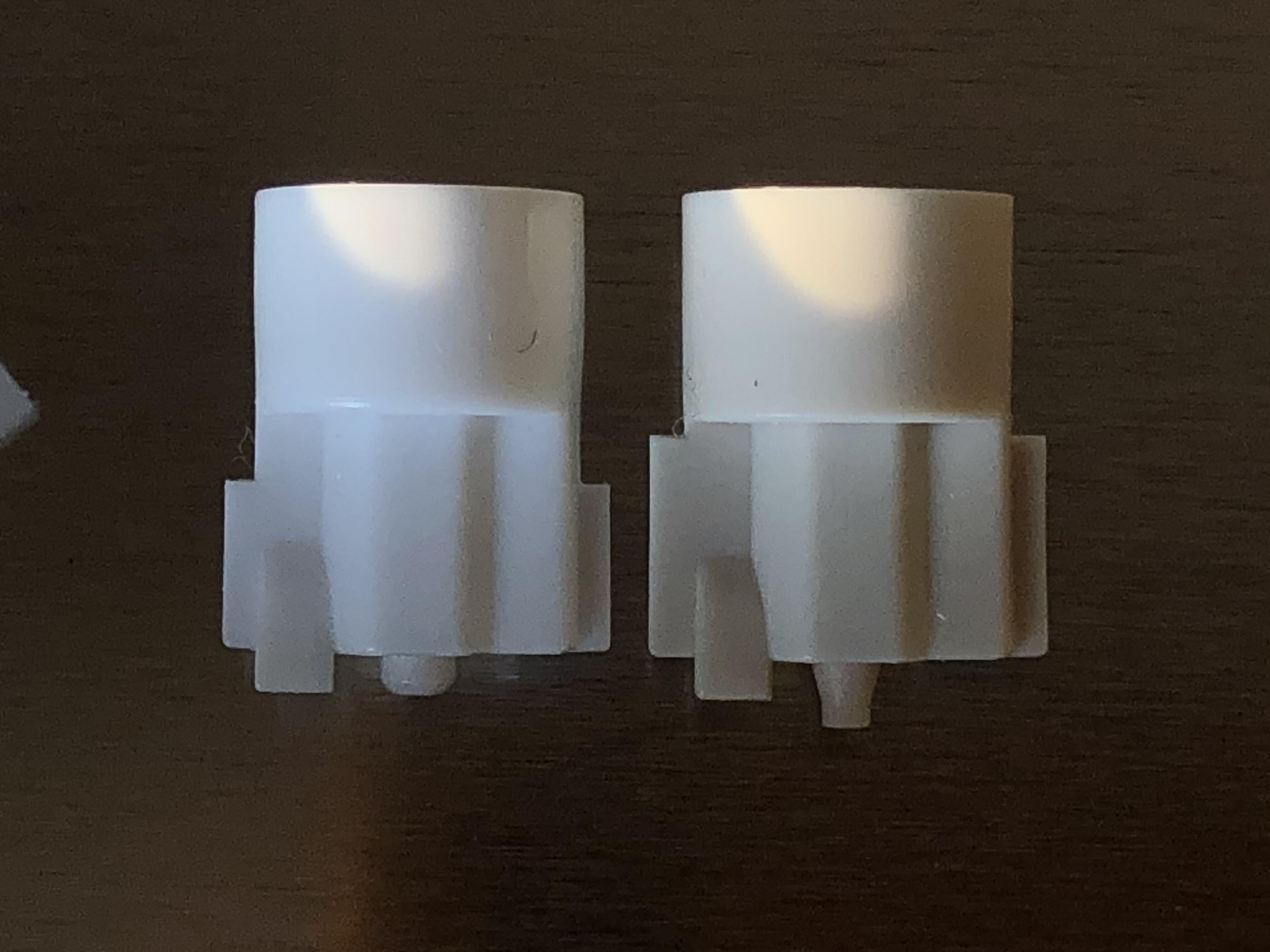

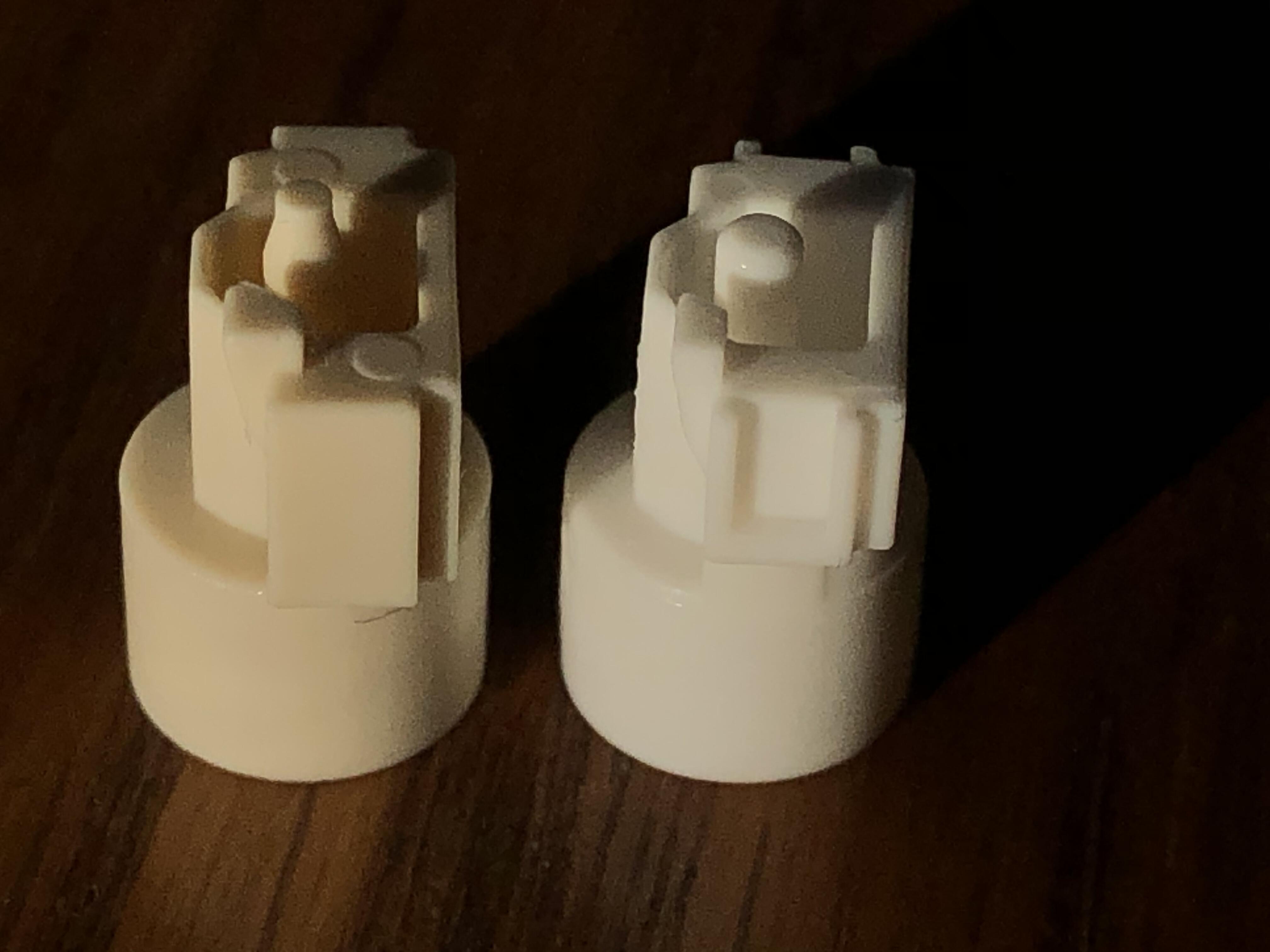

Now let’s check out the stem; I’ve photographed it here in comparison with one from a BOX Cream (the darker one):
Familiar, but different. Slightly shorter pole, much lower rail “shoulders”.
Comparing the rails and ramps:
The footprint of the ramp has been changed; while the Cream will mesh with the bottom pad, there’s a tiny bit of slotting-in to that bottom cavity that the thinner ramp avoids.
Some BOX stem rails are hollow, some aren’t - less contact area with a similar footprint is probably good.

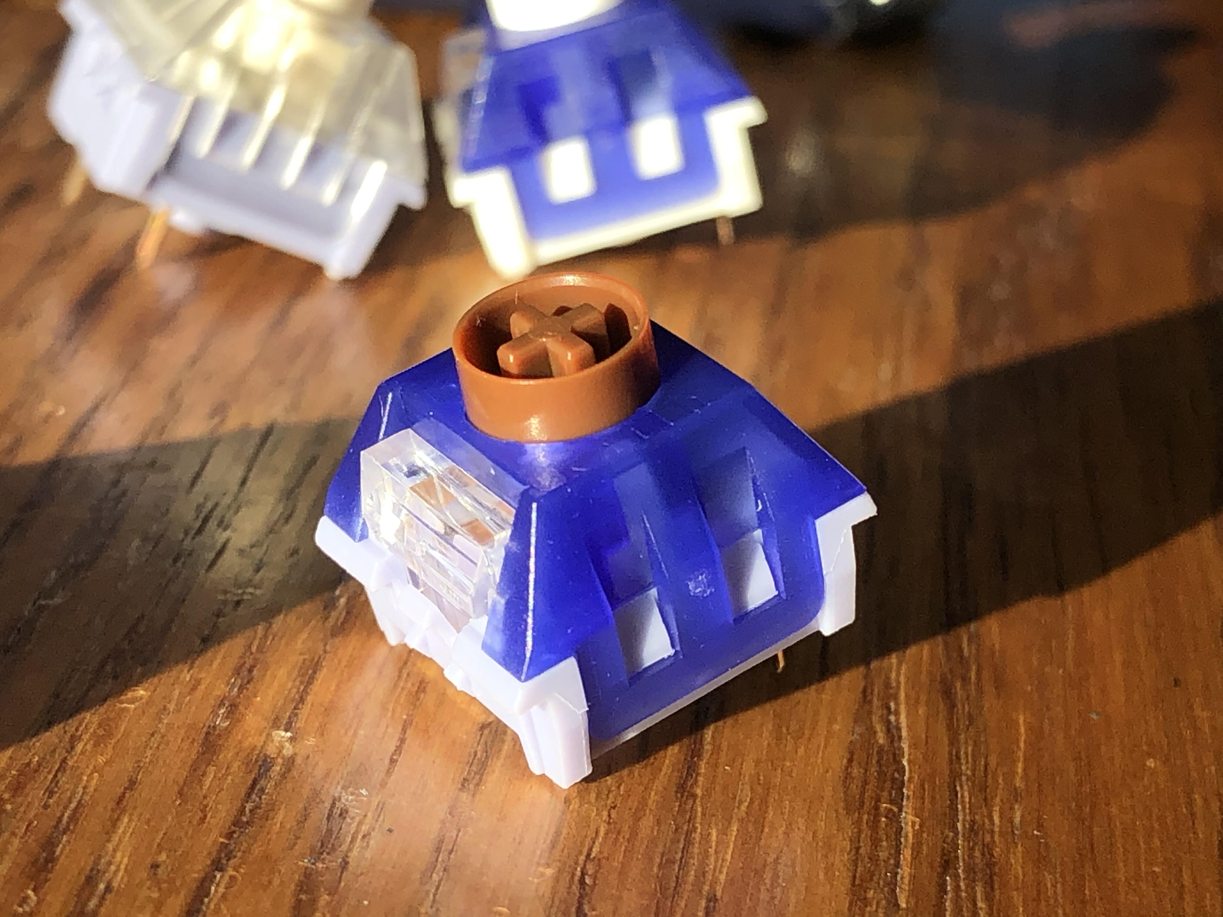

Deep Seas in mah Portico:
No, that’s not your screen. There’s a pixel or so’s worth of black foam dust inside one of those white stem barrels.
