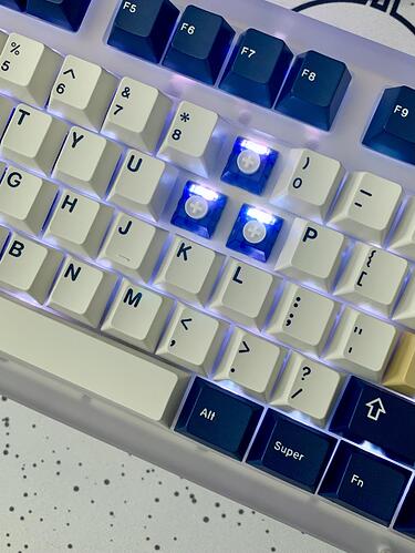

I committed these to the solder today
I have an extra Masterkeys Pro S with browns in it. I don’t mind browns, but I do mind that they are North facing. I have several hundreds of options when it comes to keycaps. I could easily use OEM, cubic, SA, DSA or other profiles that dont contact the housings when in this position… but there’s somethign about being limited that bugs me.
So… I desoldered the browns and put in the Deep Sea this morning. Worked on the stabilizers as well. This board is a solid 9.5/10 in my collection. It looks and sounds great. All of my other Norbatouches have dampened Topre switches. This one feels very similar, but I actually might like it even more.
The deep sea almost feel like a silenced 30g Topre.
Completely stock, by the way. I can hear the spring ping when I hold the switch up to my ear, but I can’t hear it in the board at all, so I didn’t bother lubing the springs. The LEDs in the board are a good 30% dimmer because they only shine through the lens, but it’s more than enough for accent lighting.
Hands down, the Deep Sea is the the only stock silent switch I’ve ever used and enjoyed. And I believe I’ve tried almost everything available.
